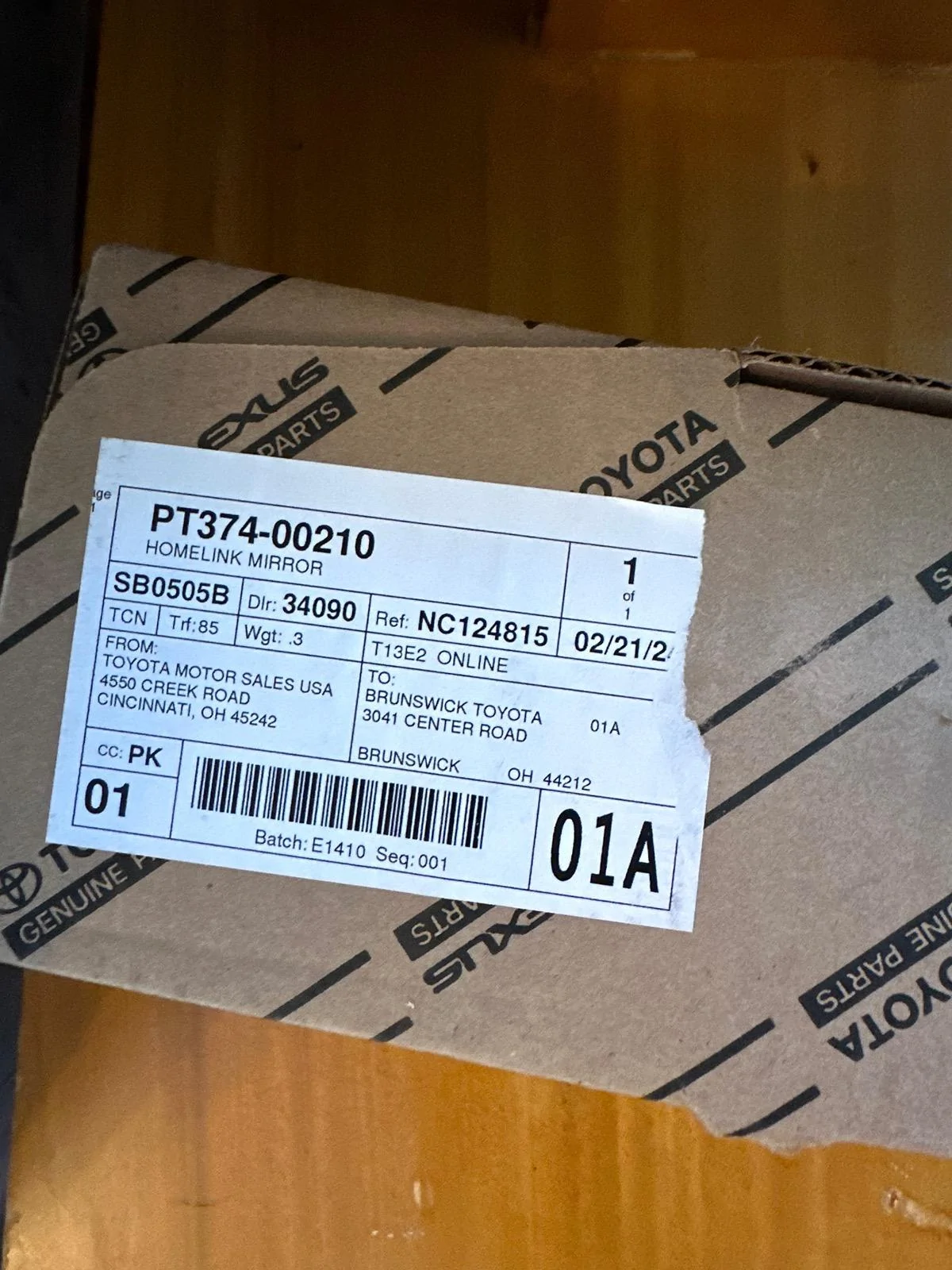

Edited my Question about finding Kia Mirror online.
I found one New for $ 47.00 plus Shipping / Tax $ 65.00 total More than what most have posted paying. Also Part # A9062-ADUP0 seems to be discontinued but I did find this part number and ordered. It will be interesting to see if the Kia Dealer subs with another part number.
And No I don't have my 2025 yet. So who knows if it's going to work for me.
