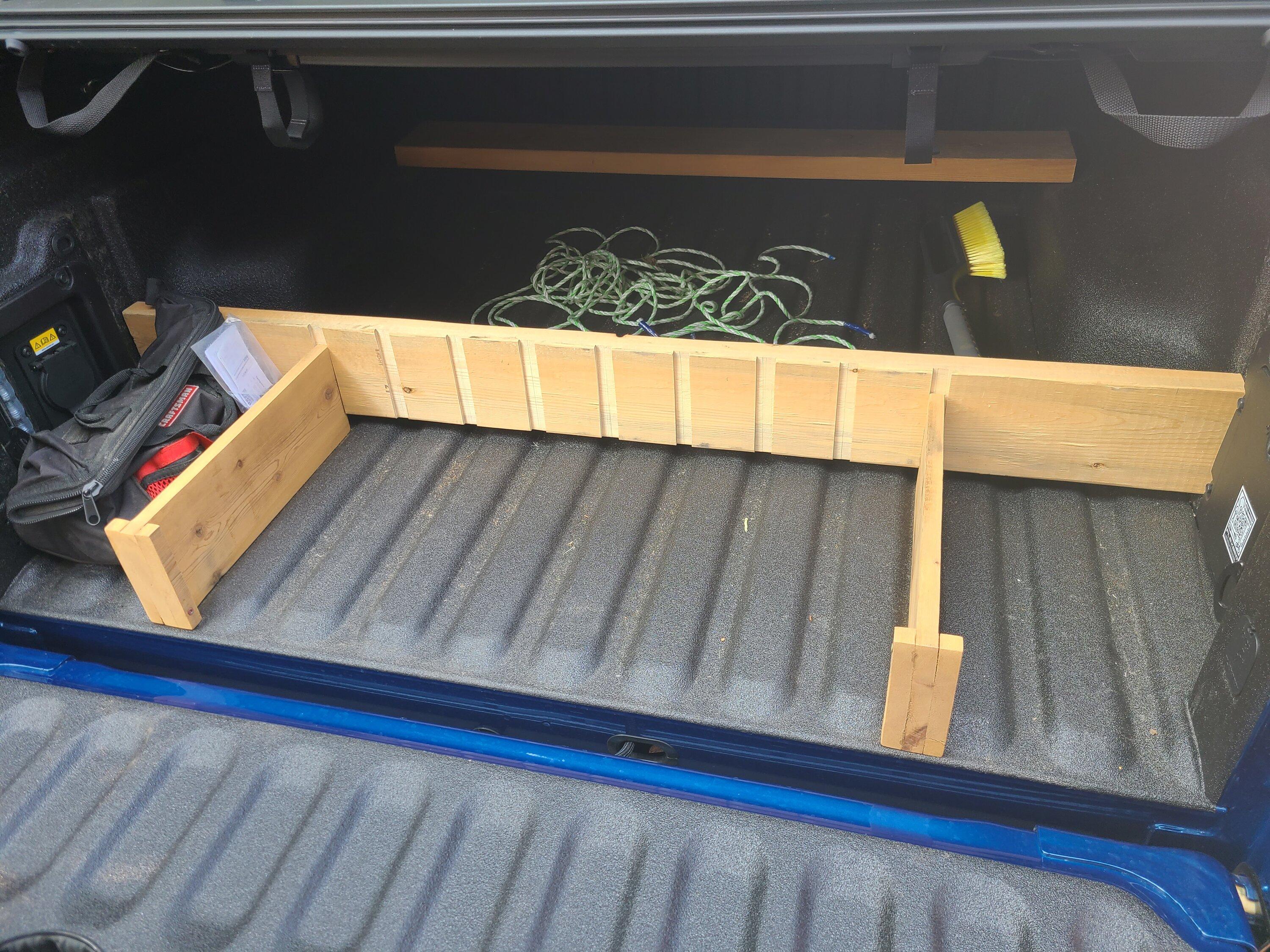

I just cut slots into the "standard" wood divider that align with slots in the bed. Then cut 1x6 for the length of the bed from divider to tailgate and added some small pieces at end for support to them, besides the tailgate closed also keeps them from slipping around. Stays in place well enough for me.

Now that's the kind of DIY ingenuity I like to see. Designs that are simple but highly functional. Great idea using the dado cuts. Thanks, now I'm going to have to make that for myself.

Very nicely done! I particularly like your use of the ribs in the floor, matching with the dados in your woodcuts. Fabulous idea.👍👍👍👍👍

That's fairly brilliant! Nice job!

Clever idea! What is the wood in front of the green rope?

I have another bed divider towards the cab, in the horizontal position across the wheel well. Just made out of spare wood, it doesnt really do much for me, but maybe will come in handy.
