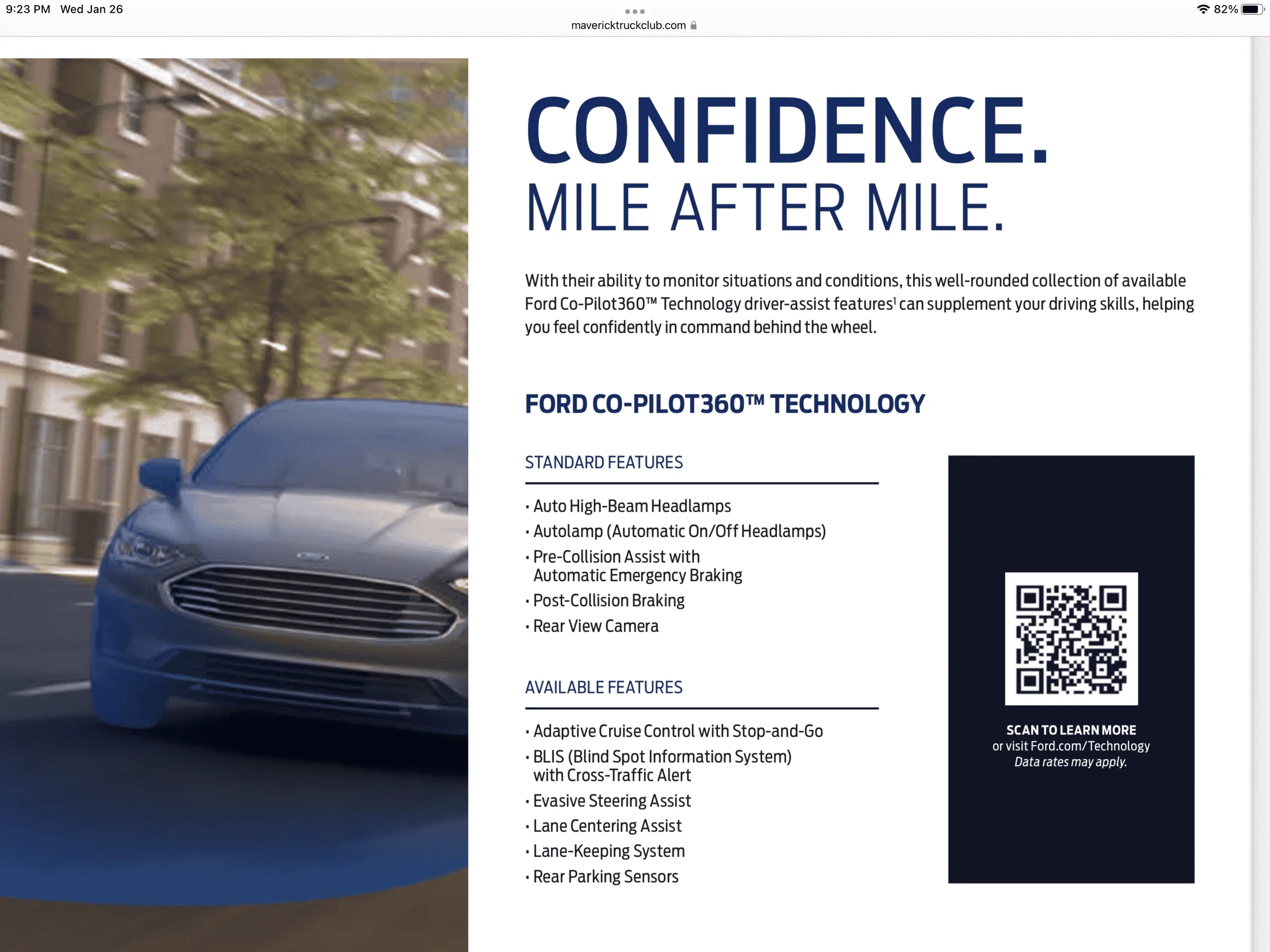

From the newly posted Brochure thread: https://www.mavericktruckclub.com/forum/threads/2022-ford-maverick-brochure-pdf.9020/
Ford Maverick Just realized XLT with 360 has actual lane correction on the lane keeping feature E88F022E-4794-425B-B006-578FEE65D8AE
and as it looks like other owners like ccubedzx3 that has an XLT also reportedly got his to work.
just sayin……
just sayin……
Got what to work? And those available features regardless of how they package them for the Maverick were being offered from the beginning.
https://www.mavericktruckclub.com/forum/threads/how-good-is-the-copilot-360-is-it-worth-it.275/
Look to Granger Ford's posting on the data sheet.
Those features are ultimately decided first on sensors installed, then if the switches are also installed. The standard features don't require hardwired switches for the features to be activated or deactivated.
Copilot adds to that with more sensors and features. The ones that use the sensors on the standard trim need their own hardwired switches aka Lane Keep System those that don't like BLIS have unique sensors and in this case mirrors that only are used for BLIS and no other features. BLIS is the big ticket item in Copilot 360 system. Frankly if anyone wants BLIS just pay for the Copilot 360 package, it will be cheaper than retrofitting in the mirrors and sensors later on.
Then you get to Lariat Luxury package which also requires Copilot 360 the features offered there require another set of sensors not in the standard or Copilot packages. Those are the front radar sensor which is used in conjunction with the front facing camera, for ACC, Lane Center and Evasive Steering. The reverse sensing system (not camera) has it's own set of sensors only used for it.
Then there is Hill Descent Control which is also a Copilot 360 feature but not documented and sold as such on Mavericks. It only requires hardwired button and some forscan changes to make work. They hid it in the FX4 package. It is not dependent in anyway on the other stuff so hence it is packaged here. That and it is a feature most probably would not use except in off roading conditions anyways.
There is a rhyme and reason to how they package these features based upon how the pieces interact and stack on each other.
Just sayin....
