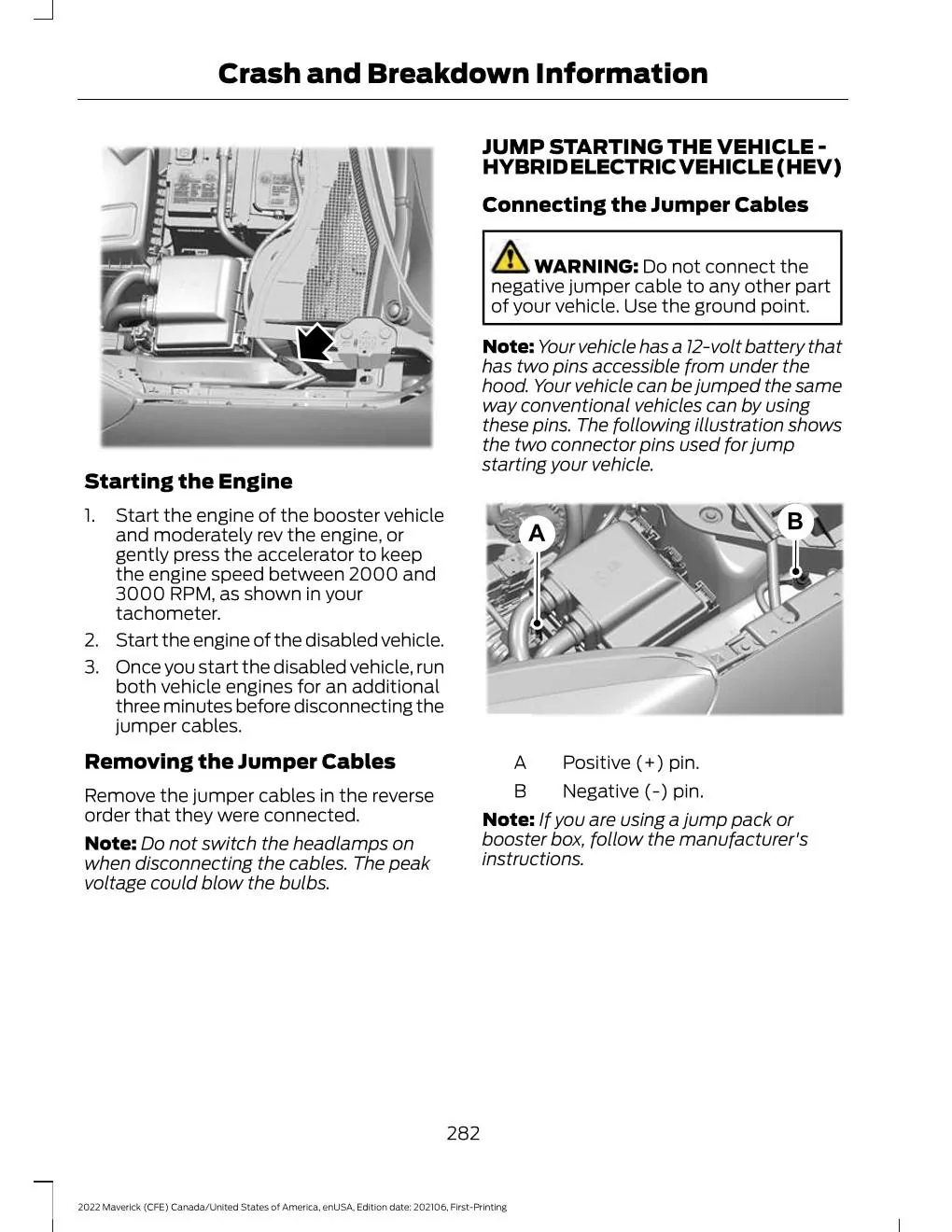

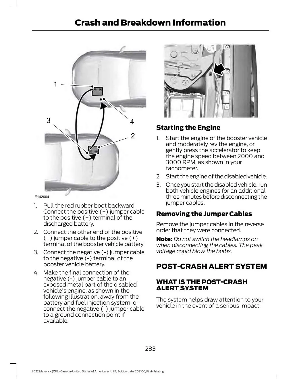

Question...how do you jump start a hybrid Maverick? Is there a connection under the hood (like a Prius) or do you connect at the battery location under the rear seat?

I believe there are terminals in the engine bay. Check the owners manual to make sure.

Thanks Mike...I’ll look it up.

This appears to be explained in a way that implies us hybrid owners can also provide a jump when asked? I don't want to be that guy!

I appreciate the perfect responses...you folks are great people.
