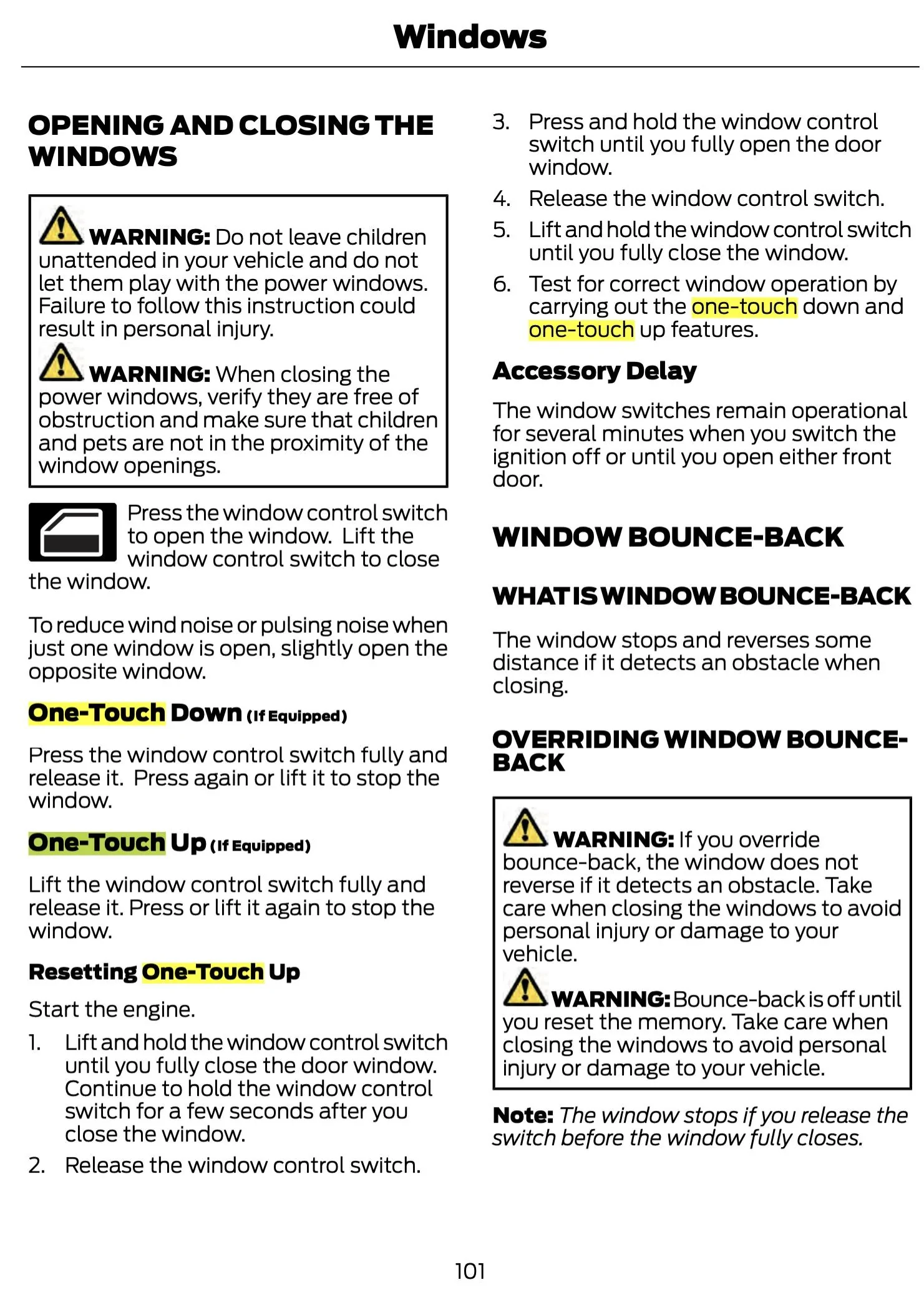

That procedure is clearly described in the owner's manual - page 101.
Ford Maverick Issue with window, taking to ford for warranty. Resetting One-Touch U
Lots of good info in the manual, if people would only read it... (Of course, I'm equally guilty of failing to find pertinent info in the manual... :rolleyes: )
I looked but didn’t look in the right section. I appreciate you pointing this out.
Yeah - glad to see I'm not the only one occasionally having trouble with the "layout" of the owner's manual. It seems like you almost have to know what Ford calls the item to be able to figure out where to look for it. Index could be a lot better. Sometimes I find it helpful just to actually read (versus "skim") the table of contents. Sometimes you get contextual hints that way.
