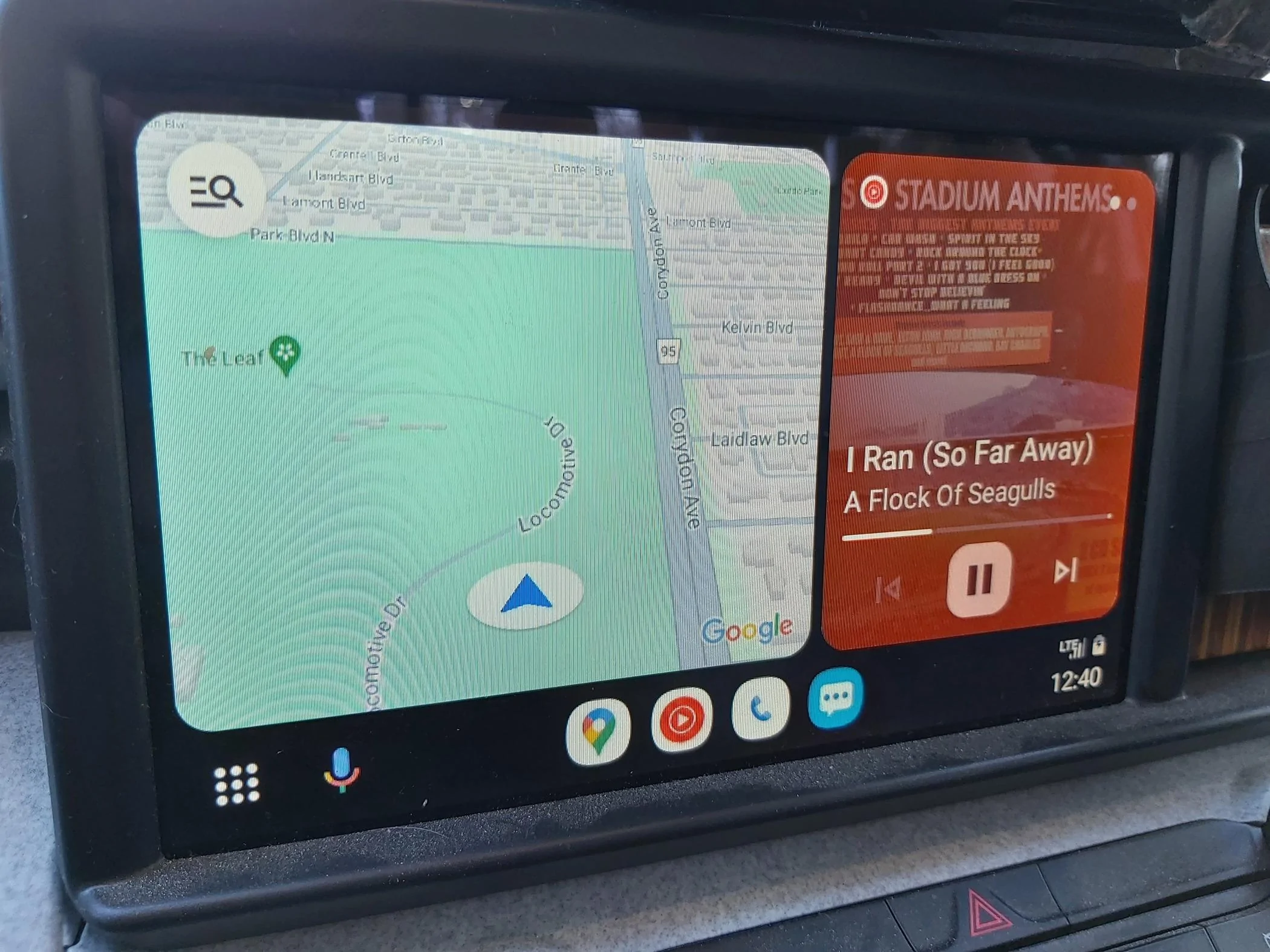

Weird thing, today all-of-a-sudden the magic Android Auto "Coolwalk" splitscreen appeared. I read they were rolling it out slowly...

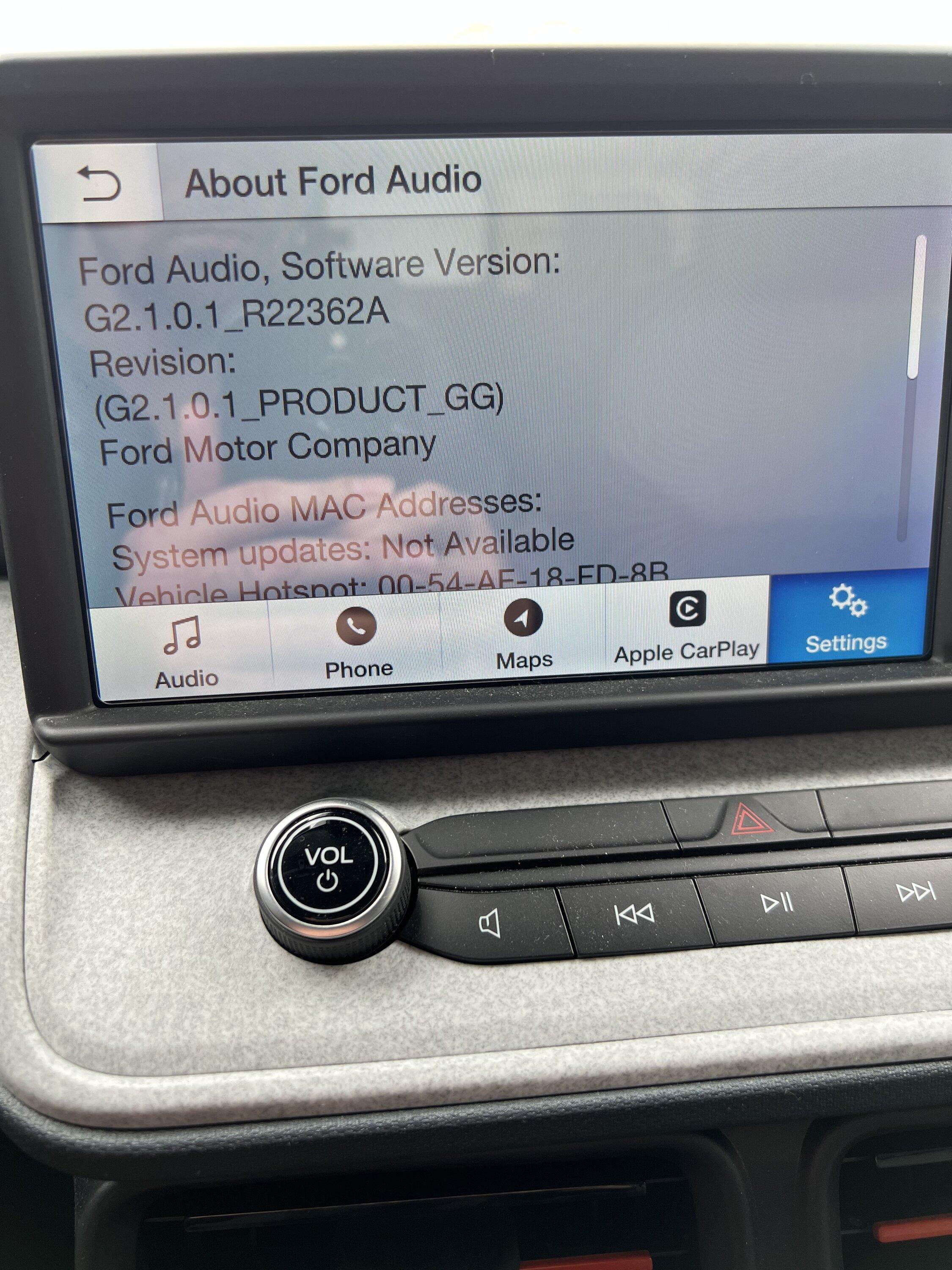

I'll have to confirm, but my screen head unit never updated, as far as I know still has original software.
So, has everything to do with the phone. I have an older midgrade Samsung A70, nothing special.
The Android Auto Vers 11.4.640814-release is what I was waiting (and waiting) for, I guess
Cool, Coolwalk... finally.

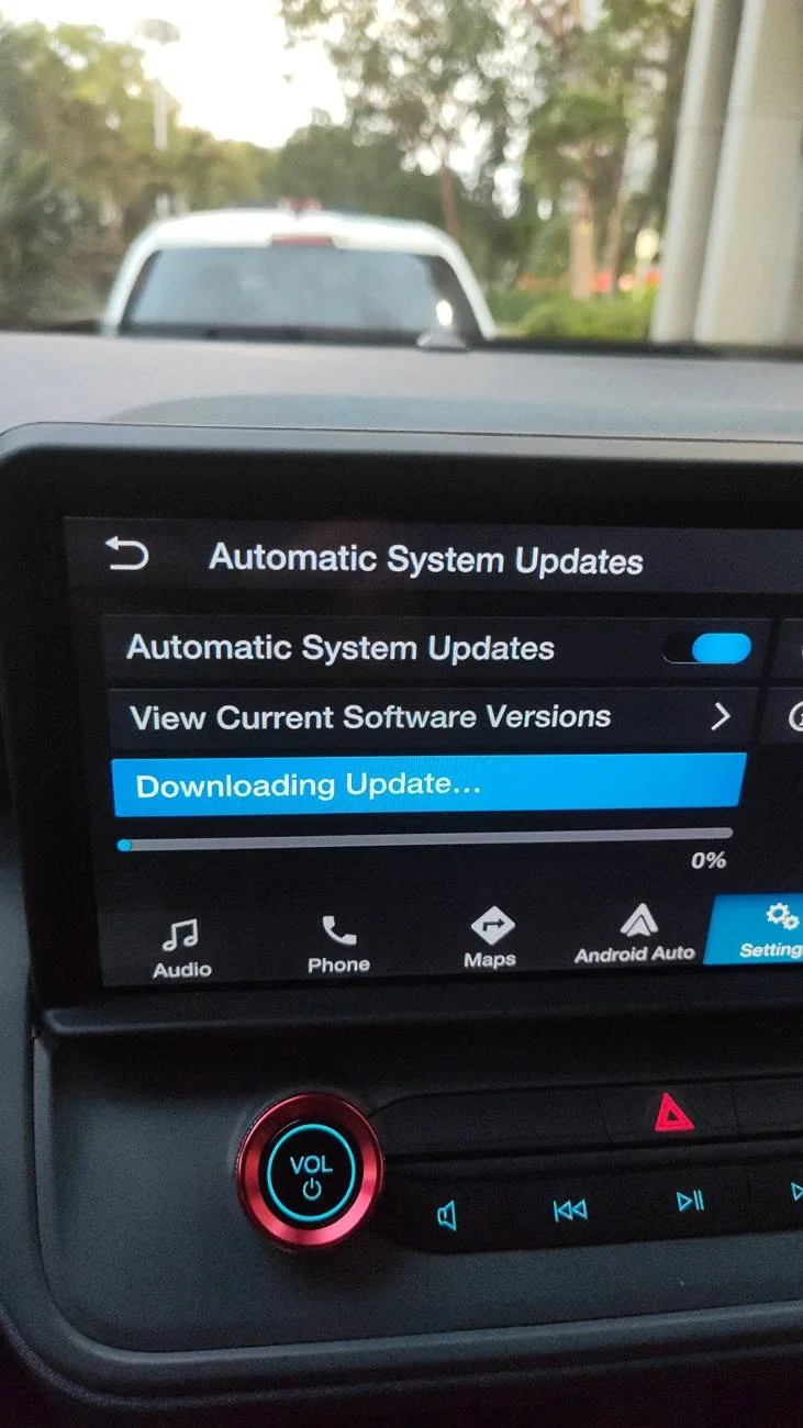

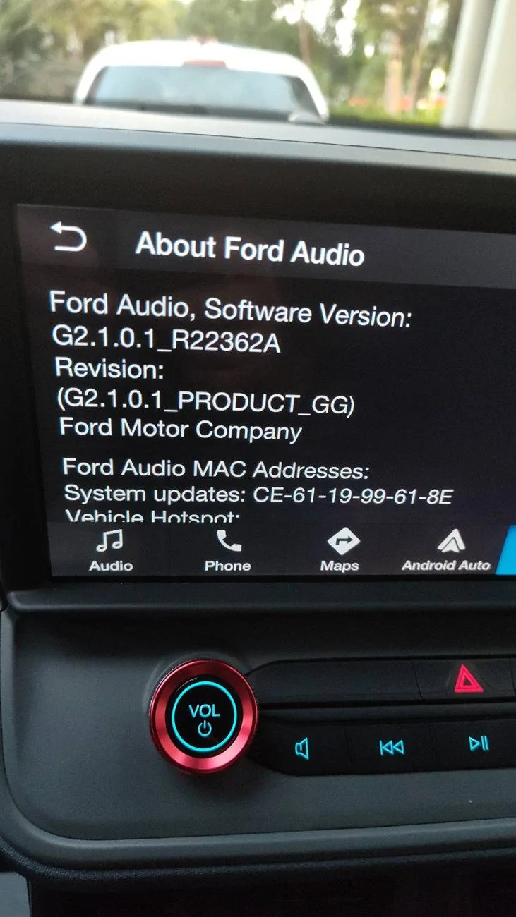

Same issue with my 2023, update infotainment downloads never pass 0% or get applied

Unfortunately if you have an XLT or XL trim, you have what Ford calls synch 2.5 lite. The Lariats have Synch 3, which you can update with a USB stick.
The only way I ever got my XLT to do an over the air update was to park in a lot far away from any other wifi signals. Once there I would do a soft reset on the system and use my phone as a hotspot. Then I would connect to the hotspot and update the software. This may take a few tries.
