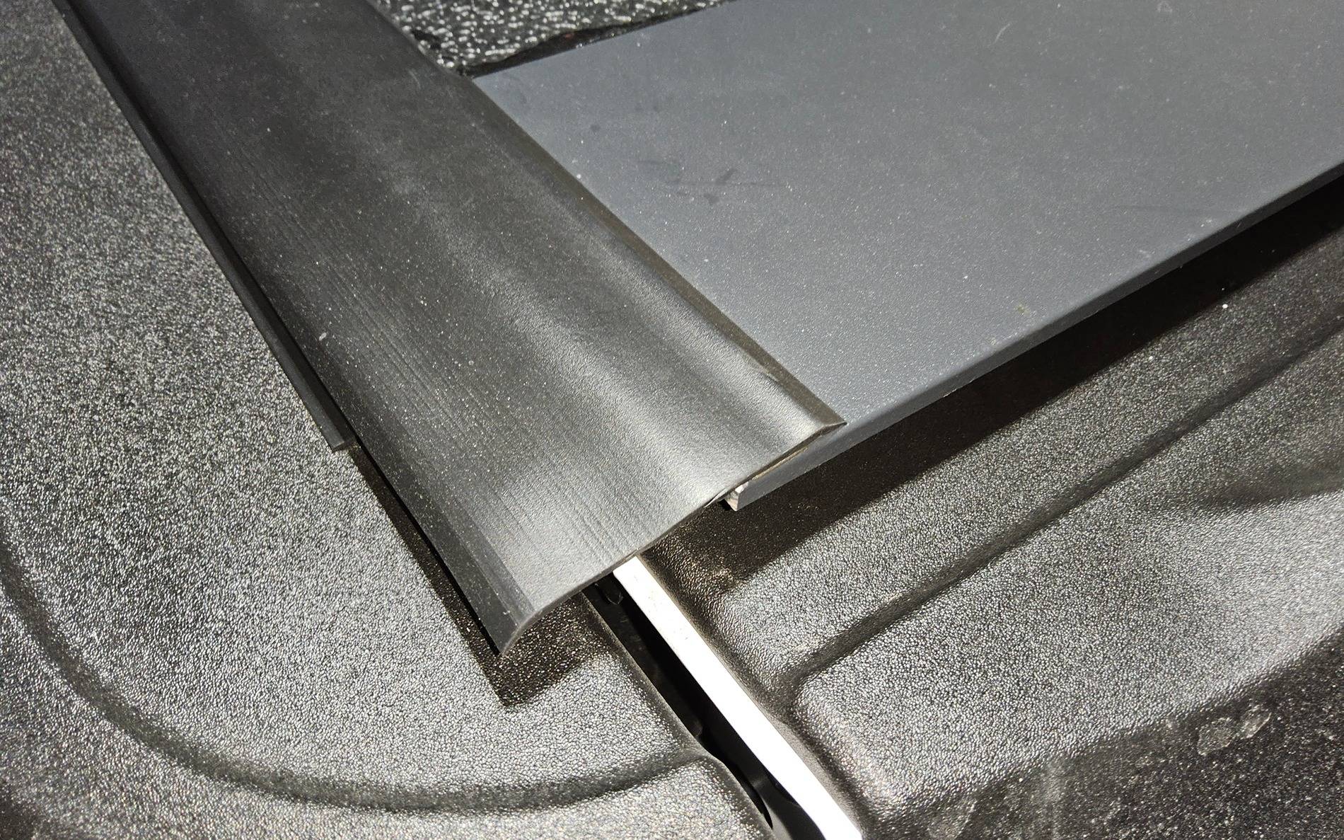

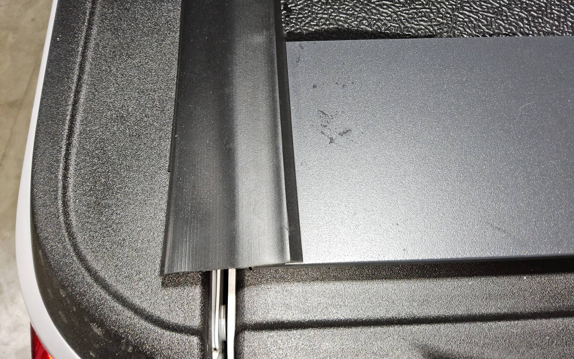

Yes it is, obviously the cover should extend over the edge of the tailgate. But I didn't buy mine from the dealer, nor would I want them to install it.
I went with the Rough Country trifold, it extends 5/8" over the tailgate. I'd be upset the cover doesn't even extend over the rails or the side of the bed.

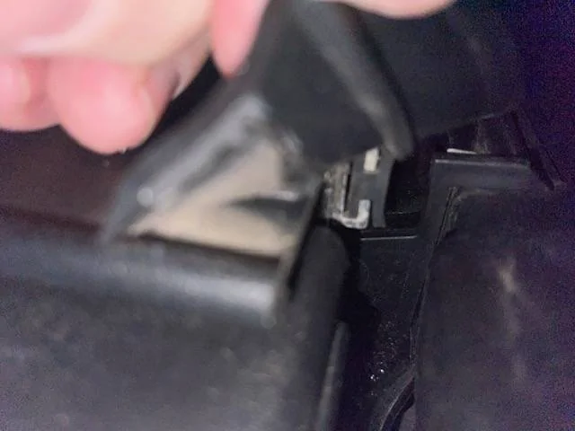

I know this isn't a very good or clear picture but I was just outside w/ the dog and decided to check the tailgate overlap on my tonneau. This is the Ford tri-fold and I don't know if it came from the factory or if it was dealer installed. However if you can figure out my crappy picture you'll see that there's around an inch overlap on the tailgate. I wouldn't be surprised if you loosen the clamps on yours and slide it toward the back until it's more centered, front to rear, you'll be happier w/ it.
