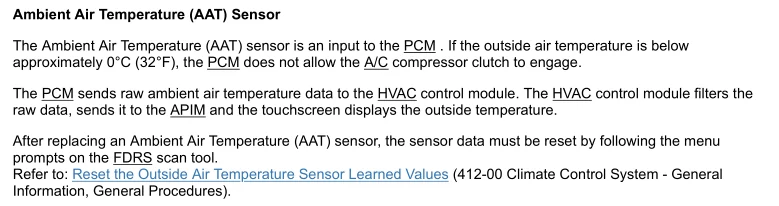

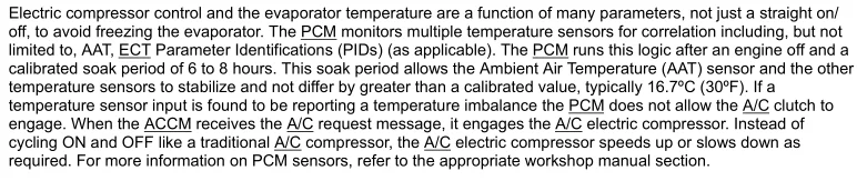

Couple of manual snips on 2025.
412-00 Climate Control System - General Information Description and Operation
Thank you, this clarifies it
