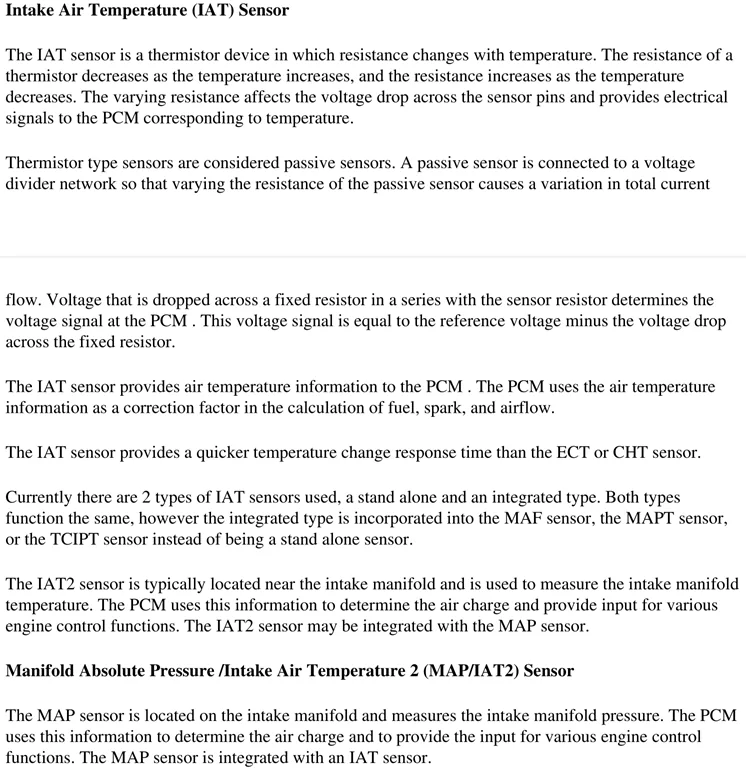

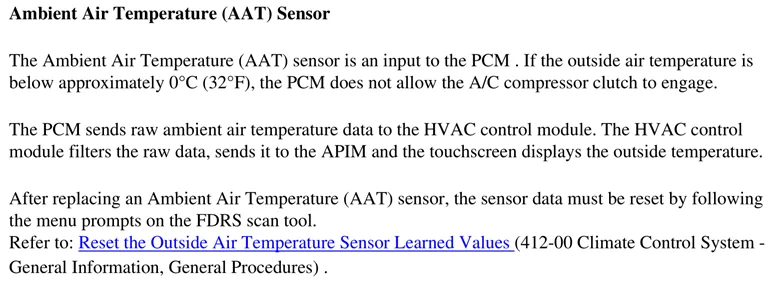

AAT, IAT Sensors.
412-00 Climate Control System - General Information 2023 - 2024 Maverick
Ford Maverick Driving Without An Ambient Temperature Sensor 1767677071919-qt
Ford Maverick Driving Without An Ambient Temperature Sensor 1767677575378-ws
303-12A Intake Air Distribution and Filtering - 2.0L EcoBoost -- 2023 Maverick

The ambient temp sensor should not cause a large loss of power, I would think the intercooler may have been damaged & you are having a lack of boost from a leak
