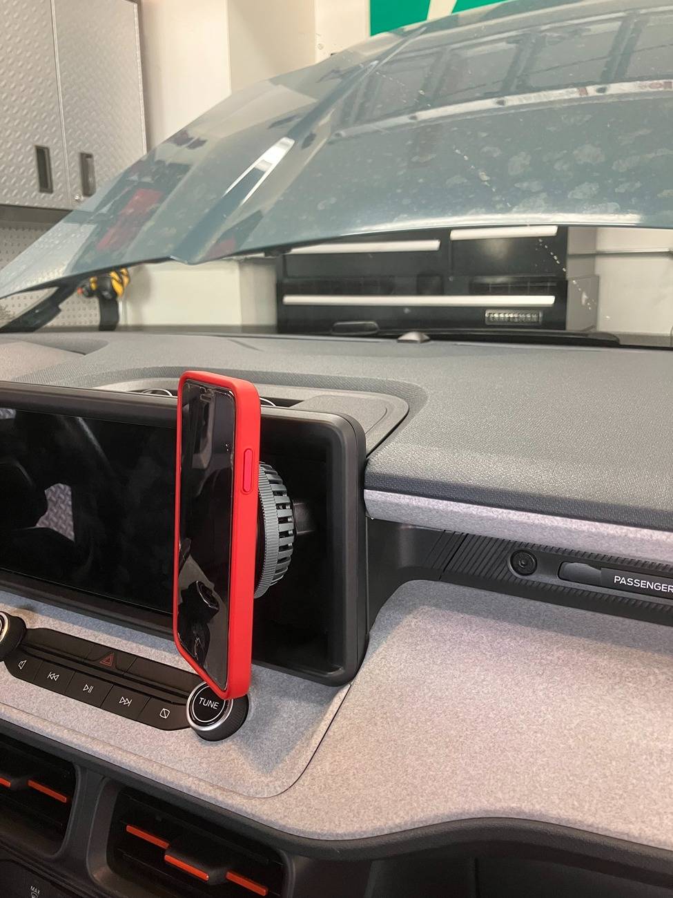

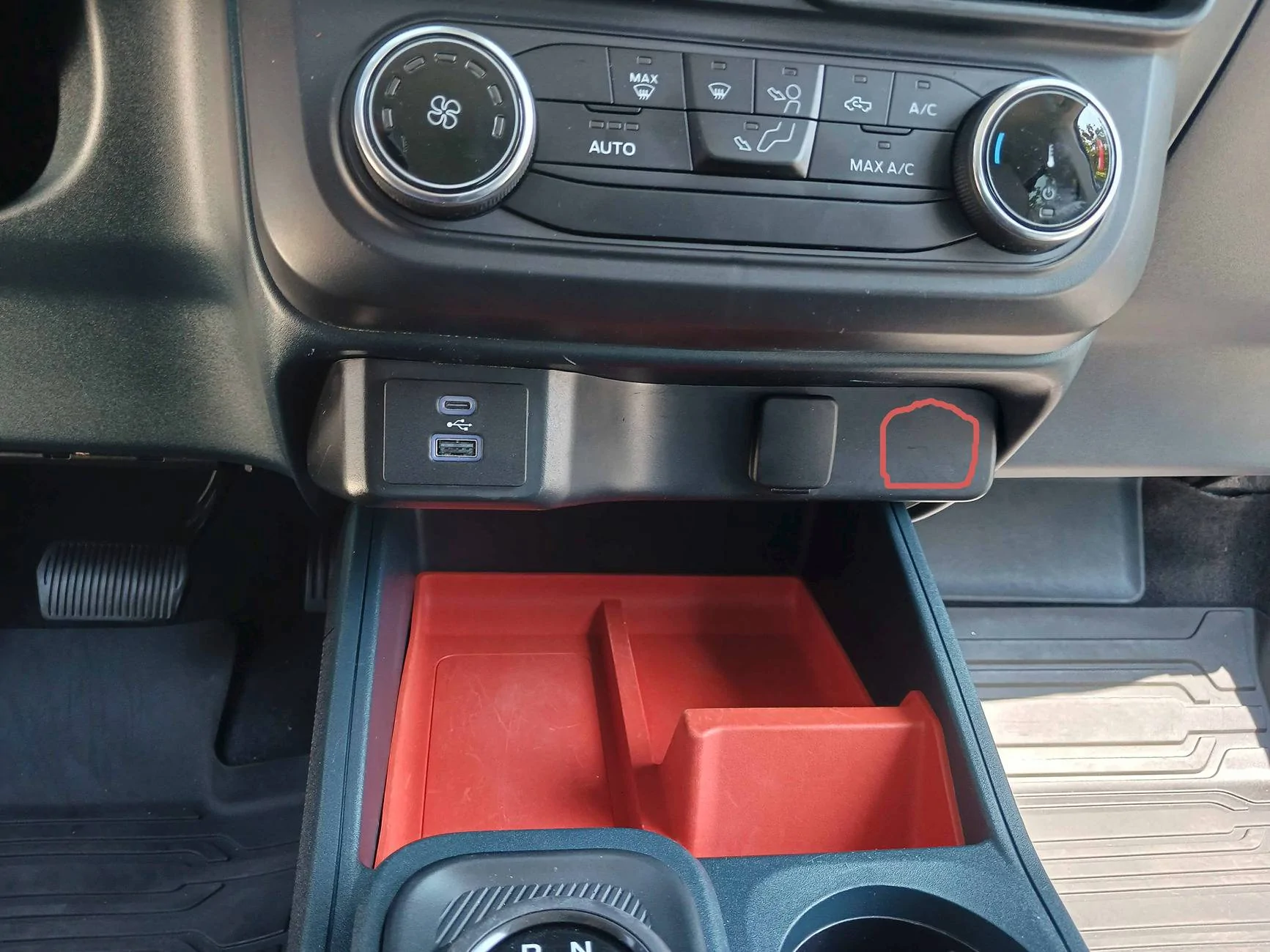

I would like to install extra USB charging ports in my 2023 XLT next to the power port. See red circle in photo. Does anyone know how the plastic panel comes out so I can drill a mounting hole and access the wiring?

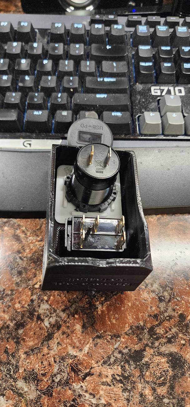

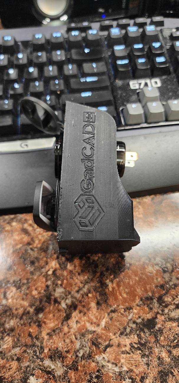

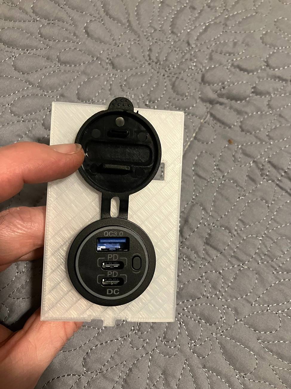

I made this up for my Cubby. The USB cost $15 from Amazon.
https://www.amazon.com/dp/B0C7KDXMDF?ref=ppx_yo2ov_dt_b_fed_asin_title&th=1
The Bracket That fits the Cubby Hole I got from GadCAD off of Etsy. I don't have the info for him. He made the bracket special with the hole for me.

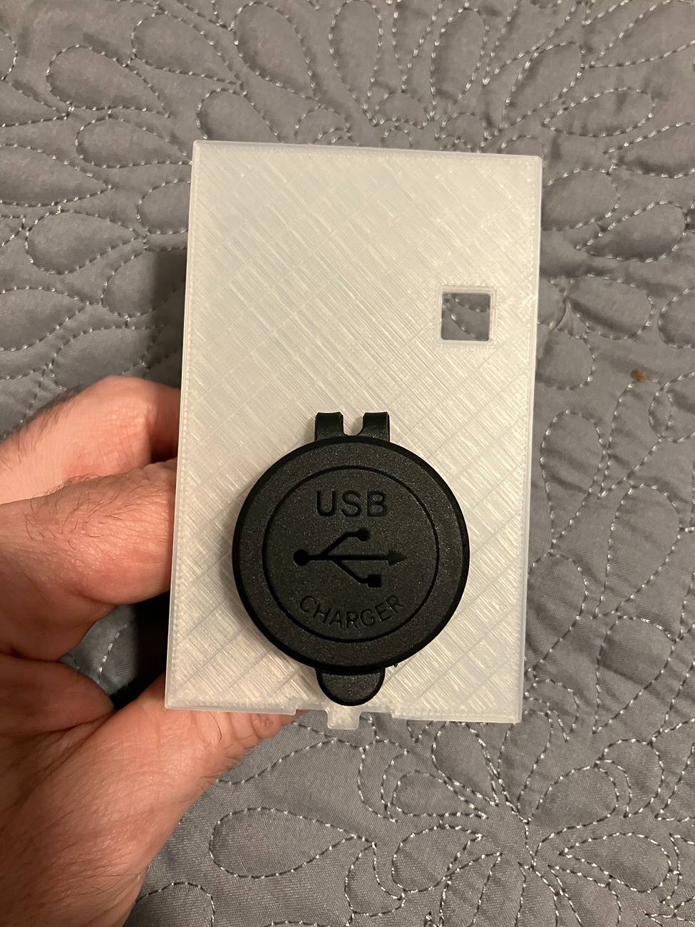

I'm Going to run the the wires to the Fuse box on passenger side to 1 or 3 I think are open.

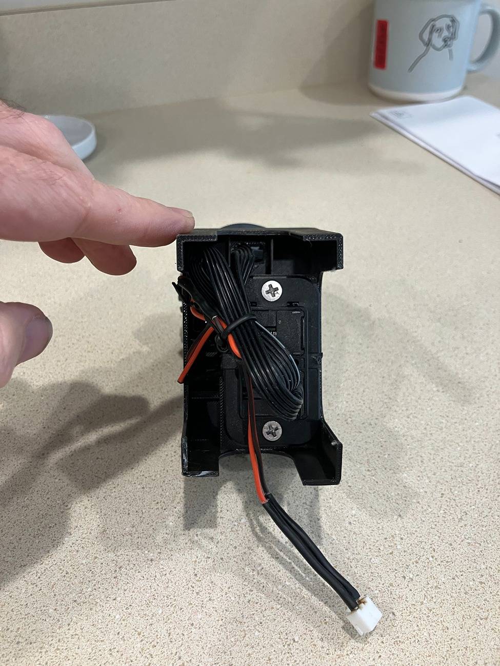

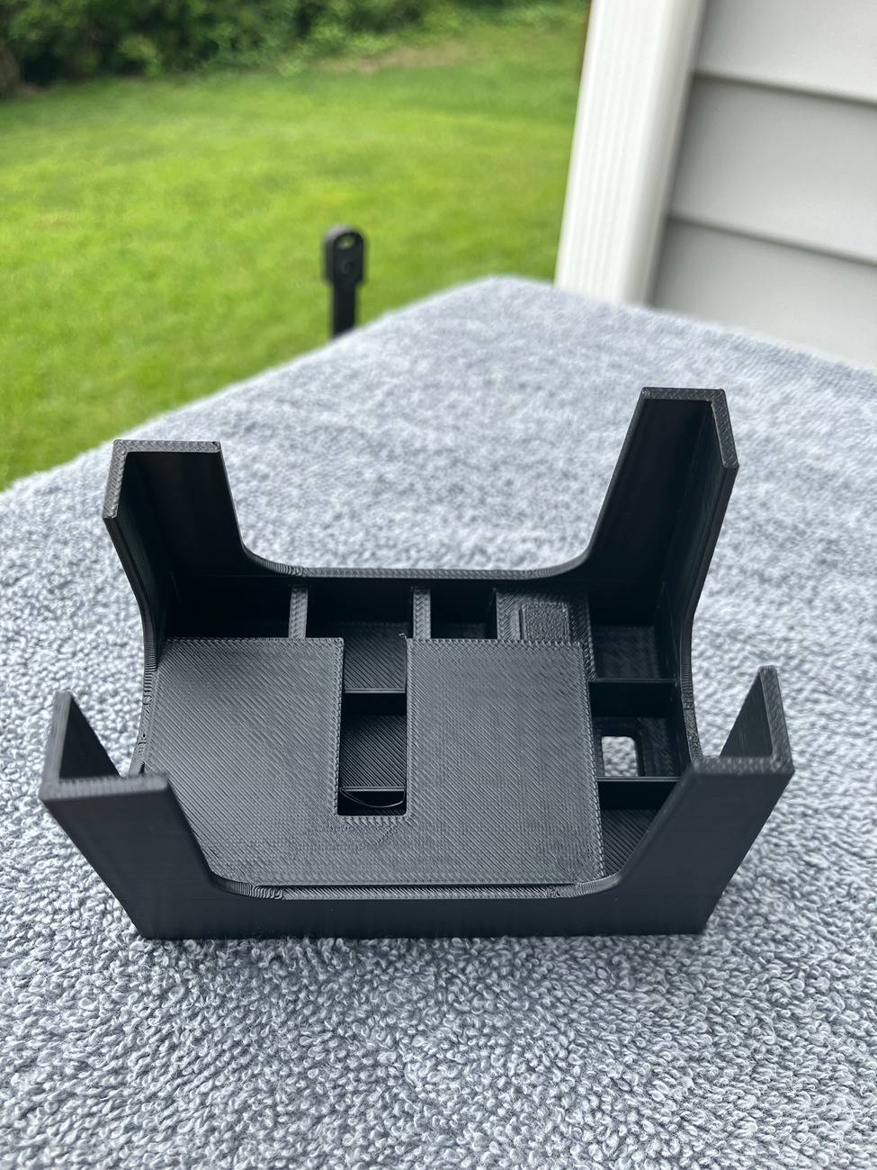

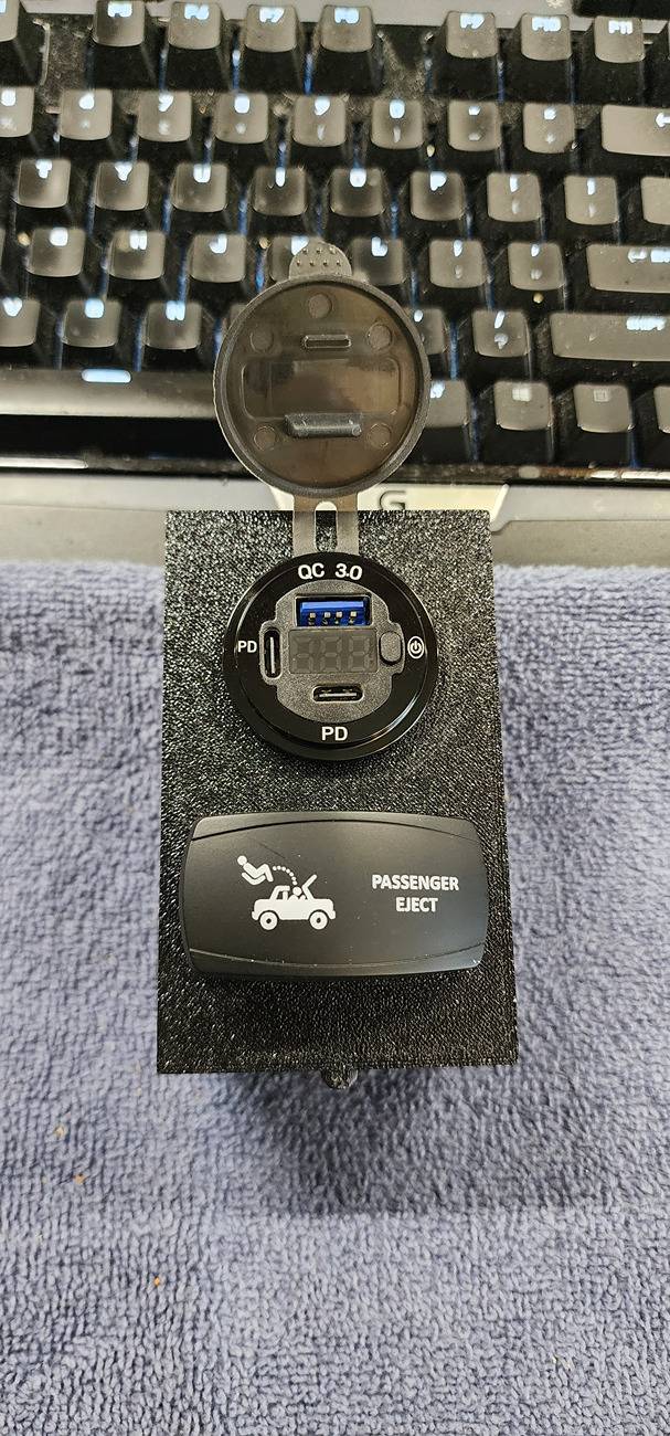

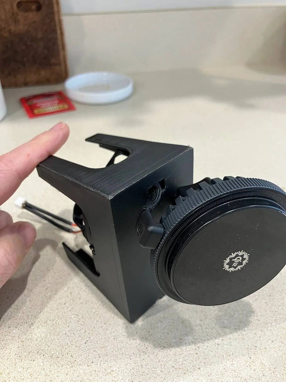

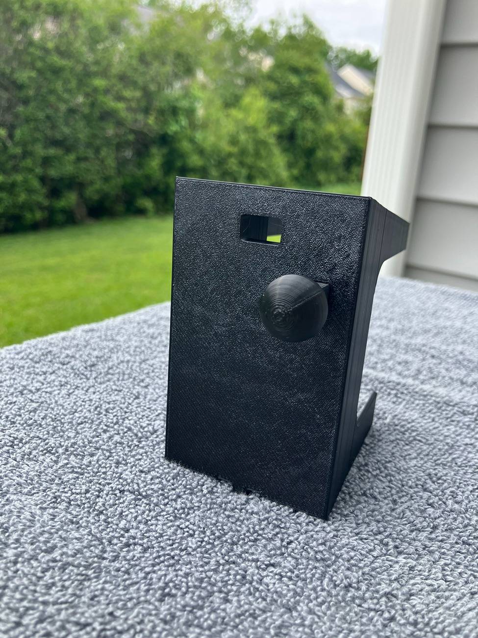

Great creative solution... it gives me ideas! How did you run the wires? Do you have a picture of the back? Thank you!
I did something similar to run a wireless charger but you can use the same concept to run that plug.
To run the wire drill a small hole in the bottom right corner of the cubby and fish the power/ground wire through it and into the fuse box under the pax side dash.
That's not a circle.
