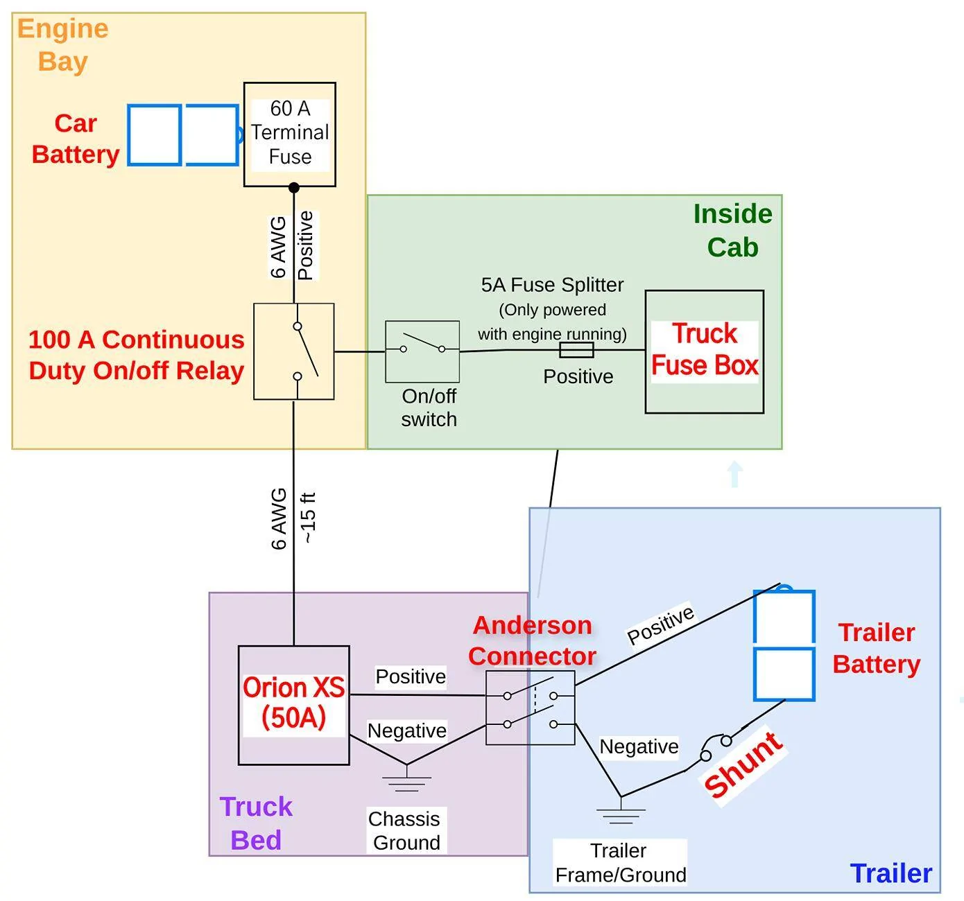

Is it worth it to ground the negative cable between the charge controller and trailer plug? (wiring diagram)
My thought, is that it helps balance any voltage potential between the negatives of the truck chassis and trailer frame. Plus, it couldn't really hurt.​
However, the trailer coupler and truck hitch could already accomplish this already, ignoring whatever interference from the grease...​
What am I missing?
Just looking for a 2nd set of eyes and sanity check before I get started.​
The Details:
Starting at the Truck's battery...
  1. 60 A terminal fuse on the battery's positive bus
  2. 4 AWG marine grade, tinned copper cable (used everywhere)
  3. Sealed, UL Rated 100A continuous duty relay (normally open) mounted near the battery in the engine bay
  4. Relay activated via a push button on/off switch in the truck cab. It stays "on," even after pit stops.
    - The truck battery hopefully won't die since the switch will only be powered when the engine is running; via a fuse splitter inside the cab's fuse box
  5. Cable goes from the from the relay, under the truck, and to the cubby in the truck bed
  6. A Victron Orion XS DC-DC charge controller is mounted in the truck's cubby. They're smaller and run cooler than a 30A system (with a steep cost bump)
  7. This is connected to a 120A Anderson plug mounted near the hitch
  8. The trailer side of the plug is connected to the battery (positive) and the frame/shunt/battery (negative)
Wiring Diagram:
Thanks for any help!

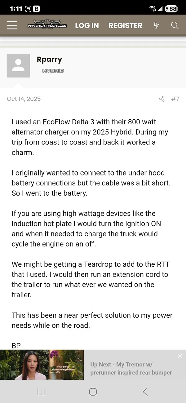

I used an EcoFlow Delta 3 with their 800 watt alternator charger on my 2025 Hybrid. During my trip from coast to coast and back it worked a charm.
I originally wanted to connect to the under hood battery connections but the cable was a bit short. So I went to the battery.
If you are using high wattage devices like the induction hot plate I would turn the ignition ON and when it needed to charge the truck would cycle the engine on an off.
We might be getting a Teardrop to add to the RTT that I used. I would then run an extension cord to the trailer to run what ever we wanted on the trailer.
This has been a near perfect solution to my power needs while on the road.

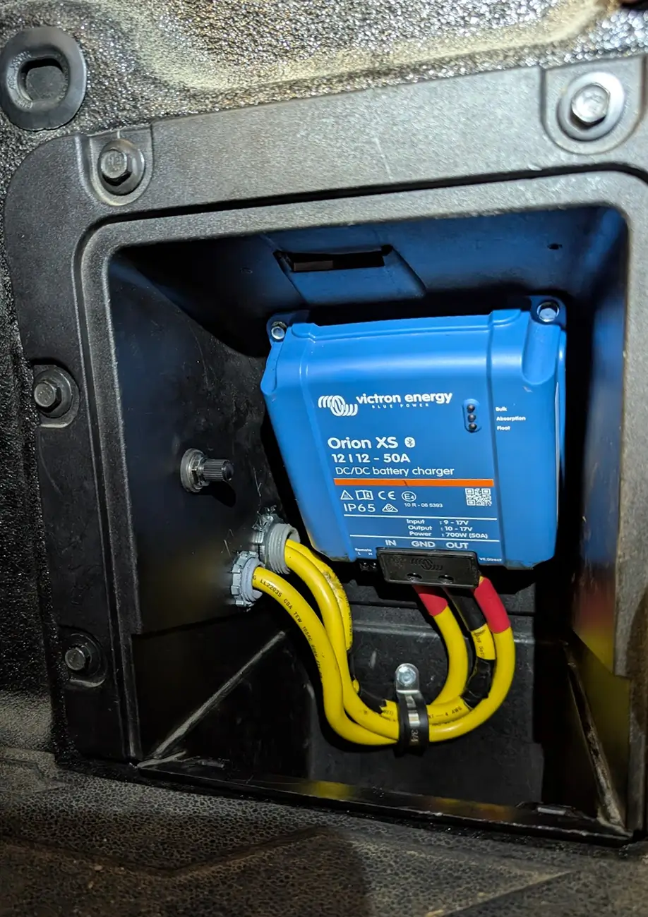

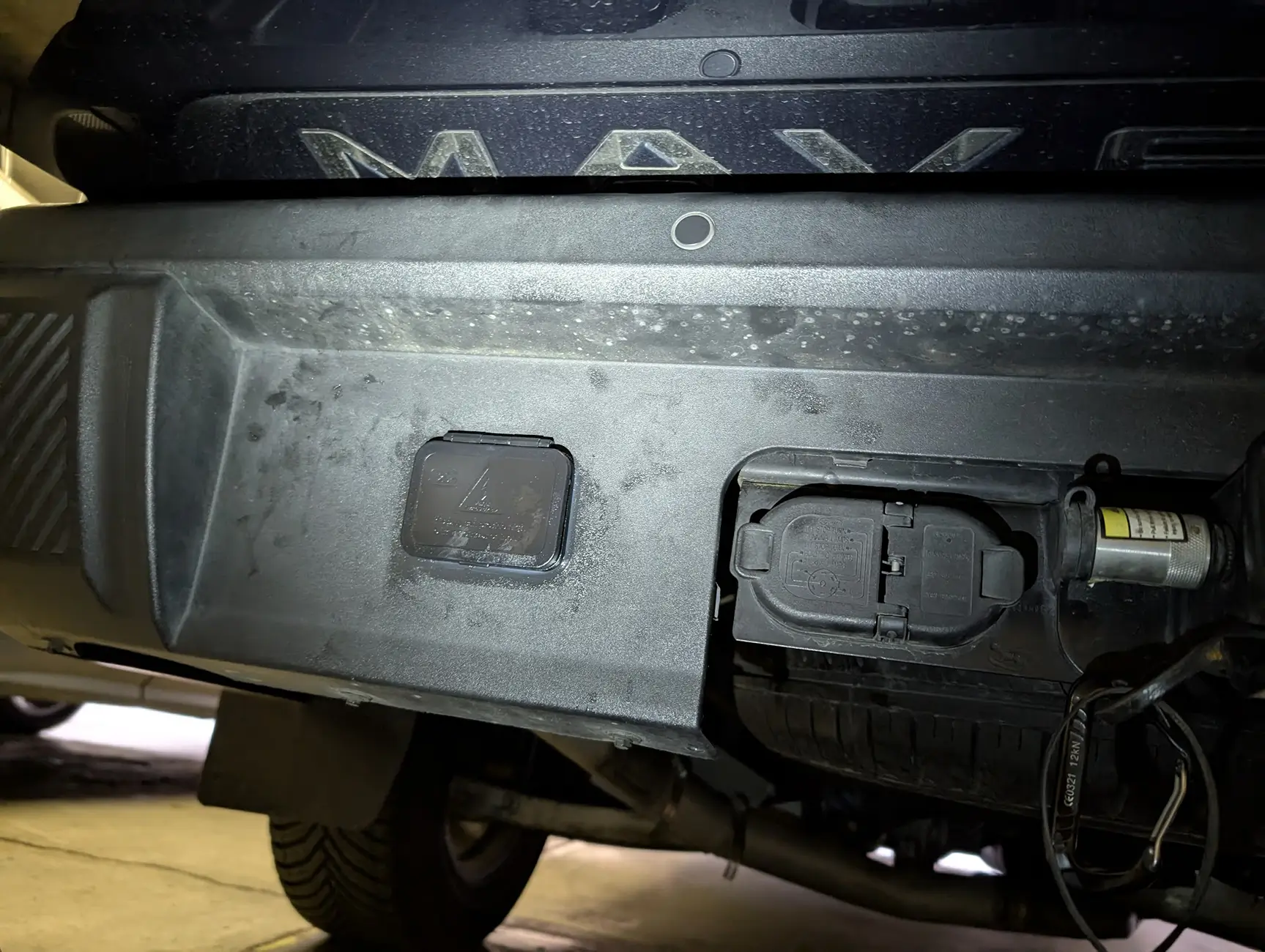

I ended up installing the DC-DC charger in the cubby and, putting a plug/cover near the license plate (pics below). I really liked Victron's 50A charger because it runs a lot cooler than their 30A (more efficient), and the app lets you customize the exact in/out amperage.
I've tested the setup a few times, but only run at ~35 amps while driving and 10-15 while at idle. I'm pretty sure these high-output alternators are rated for 175 A, so I'm hoping this won't overload anything.
I also installed a normally open relay with a switch in the cabin. This is so I can de-energize the entire system downstream of the engine bay, and it auto-shuts off when I turn off the car. The charger is supposed to have engine running detection, but figured this was safer so I don't accidentally drain the battery. Just wired the on switch to the fuse box, and went through the rubber opening in the dash
Installed charger:
Plug on back
Relay (switch is in the cabin)

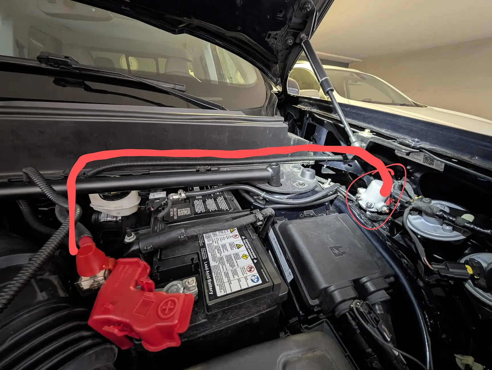

Hey! I'm planning to do the same thing (minus the plug since my leisure battery is in the truckbed). Could you explain/show how you routed the cables from the hood to the cubby and what you grounded to? What length did you end needing (I see you estimated 15ft initially)?
Thank you!
