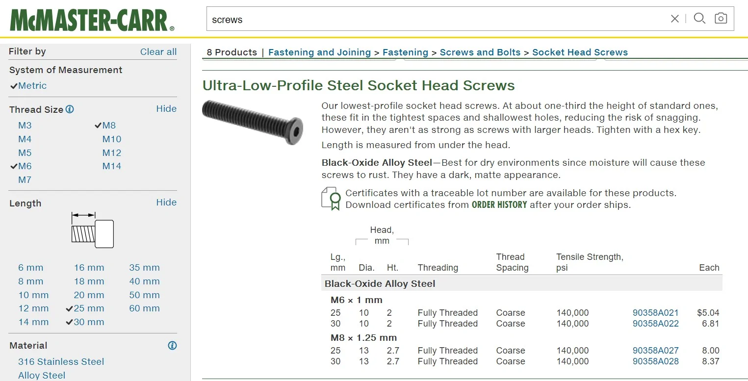

Not really. Those are flat head style, what you should be using is called a Ultra Low Profile Socket Head screw. otherwise the screw head could interfere with the cleat sliding past it.
Below is an example. HRG

Thank you for the information. This is really helpful. Should I pick 28mm for the M8 as suggested by the diagram from Ford and should I use stainless steel instead?
28mm is really an odd length, I imagine that 25mm would work fine. Stainless is fine, but a bit more $$.
