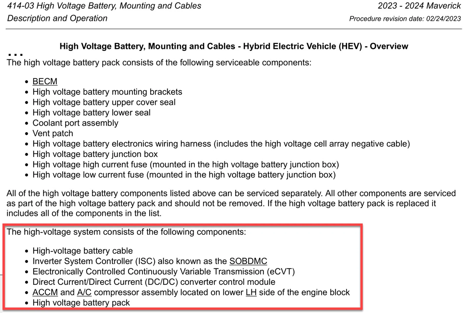

Devices/Systems Primarily Powered by the High-Voltage (HV) Battery
The HV battery drives the electric side of the powertrain and high-power components (often via electric motors or inverters). Key items include:
  • Power steering, water pump, and other "beltless" accessories (electric versions in the hybrid).
The water pumps and power steering are all 12V, not HV.
Obviously some disagreement here. I would be great if everyone providing factual statments about how this truck operates could Include a source so we can figure out which one is correct.

They run on the 12V system.
But they run when the truck is running, "Ready".
(or is power steering and power brakes there when not running?)
Therefore the 12V system is running off the DCDC converter at that time.
Radio good example.
Runs on the 12V system.
When in Accessory mode - power from the 12V battery.
Click over to On or Ready mode - power from the DCDC - which gets energy from the HVB, or from regen from the motors.
So it's very much a depends situation.
Except the AC compressor - HV system.
AC module - 12V system.
But that AI clip was wrong saying from the HVB, as if powered directly.
12V system kinda can be ultimately, but not the only source.
