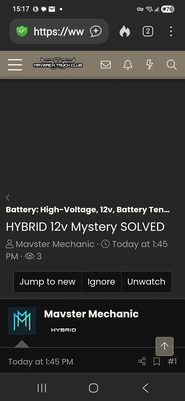

I have added a good thread to start reading on a recent conclusion put forward about this from @Mavster Mechanic .
Andy
