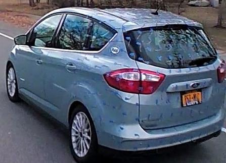

If you want to gain performance, do a "tuft test" to find where there's dirty air you can clean up. The video is far more interesting, but too big to upload.
Spoiler, nearly all the drag reduction opportunity is at the rear of the car, which is hard to change. Remember, the Hindenburg had a Cd of 0.05.

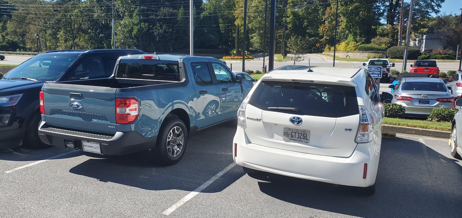

More info. I've owned a Prius v for almost 5 years.
No one wants more MPGs than the Prius community who have been going at this for a long time. There are a ton of educated owners and NO ONE has been able to get more mpgs from modifying the engine.
You get more mpgs from Hypermiling.
Pulse and glide
Keep your foot on the pedal just enough to stay out of regren while coasting so you can coast with less friction
Improve aero (think rear wheel covers and low rolling resistance tires).
How you drive is the single best modification you can do to improve mpgs. I used to drive 25k miles a year. I've had entire tanks that were almost 50mpg before when I was focused on hypermiling. Now I drive less than 5k a year and don't care anymore and now most of my tanks average low 30s.
Also, you definitely need to watch some video about how the hybrid system works including how an Atkinson cycle engine differs from a standard engine.
That's my Prius v next to a Mav I test drove.
