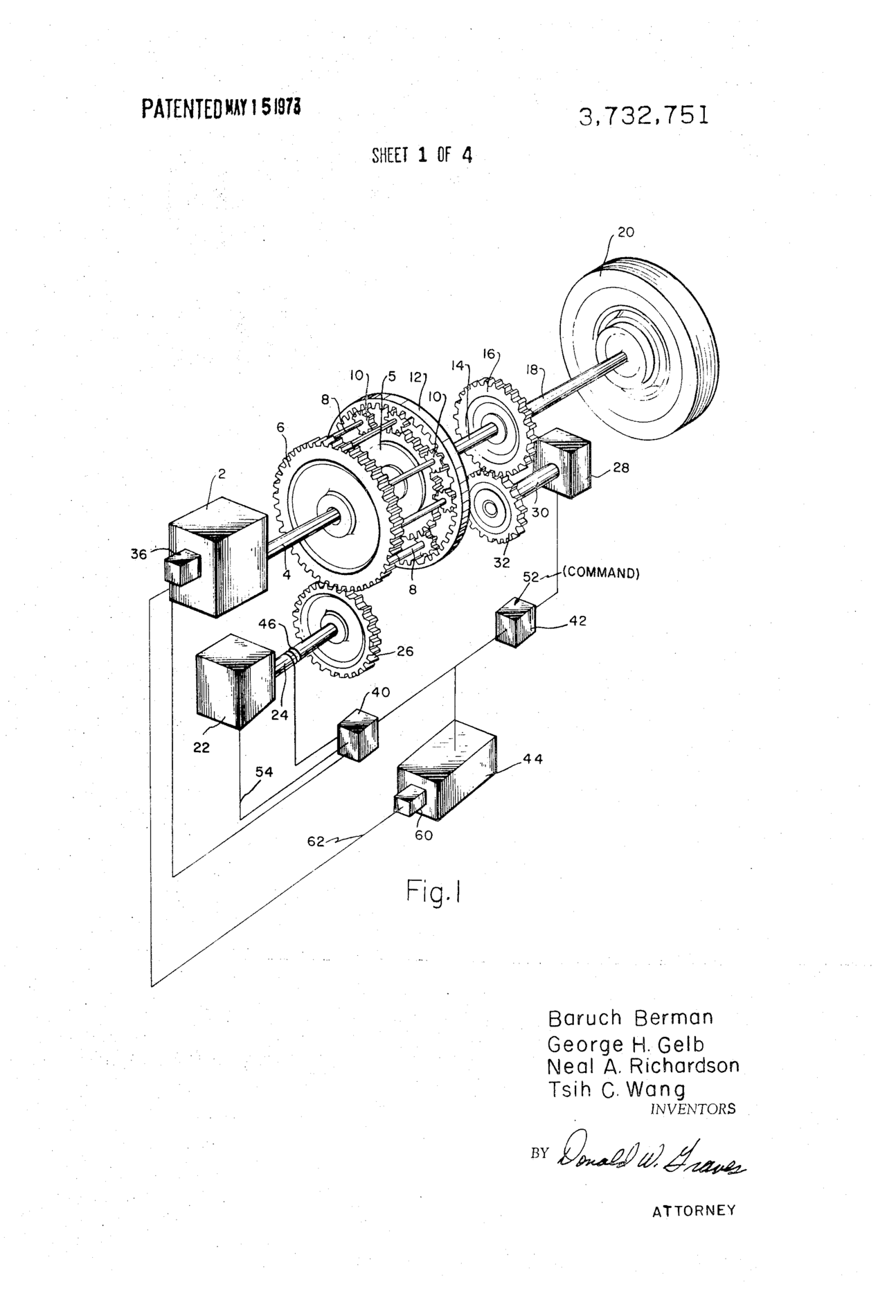

But it's not a Toyota invention... the power split device is an outdated US patent.
" A power train is described which is comprised of a prime mover, two power converters, an epicyclic gear train, an energy storage device and associated control systems. ..."

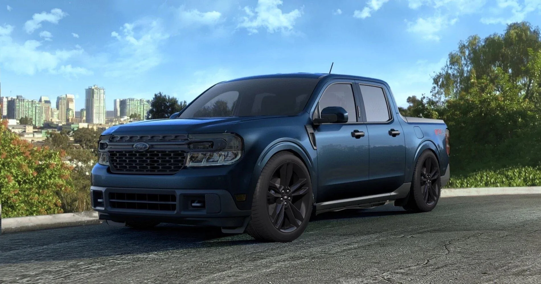

Hey everyone! New here. I plan on pulling the trigger and purchasing an Alto Blue Hybrid! I plan on throwing some 20’s on there and maybe even lower it 3-4 inches (big maybe). I was wondering, what other modifications can you do to a hybrid lol? I’ve never owned a hybrid so idk how it works. Can you tune it? Exhaust? Cold Air Intake? Basically anything that can give me more hp and more power overall haha. Thanks!
Get a bigger battery and add another electric motor (or two) in the rear. That would be slick.

Agreed but when I said wheel covers I actually meant wheel arch covers. My bad.
The Prius community has tried everything.
It is not a coincidence that the Ford hybrid system is pretty much a clone of Toyota's.
Back in the day, we called these “skirts”.
