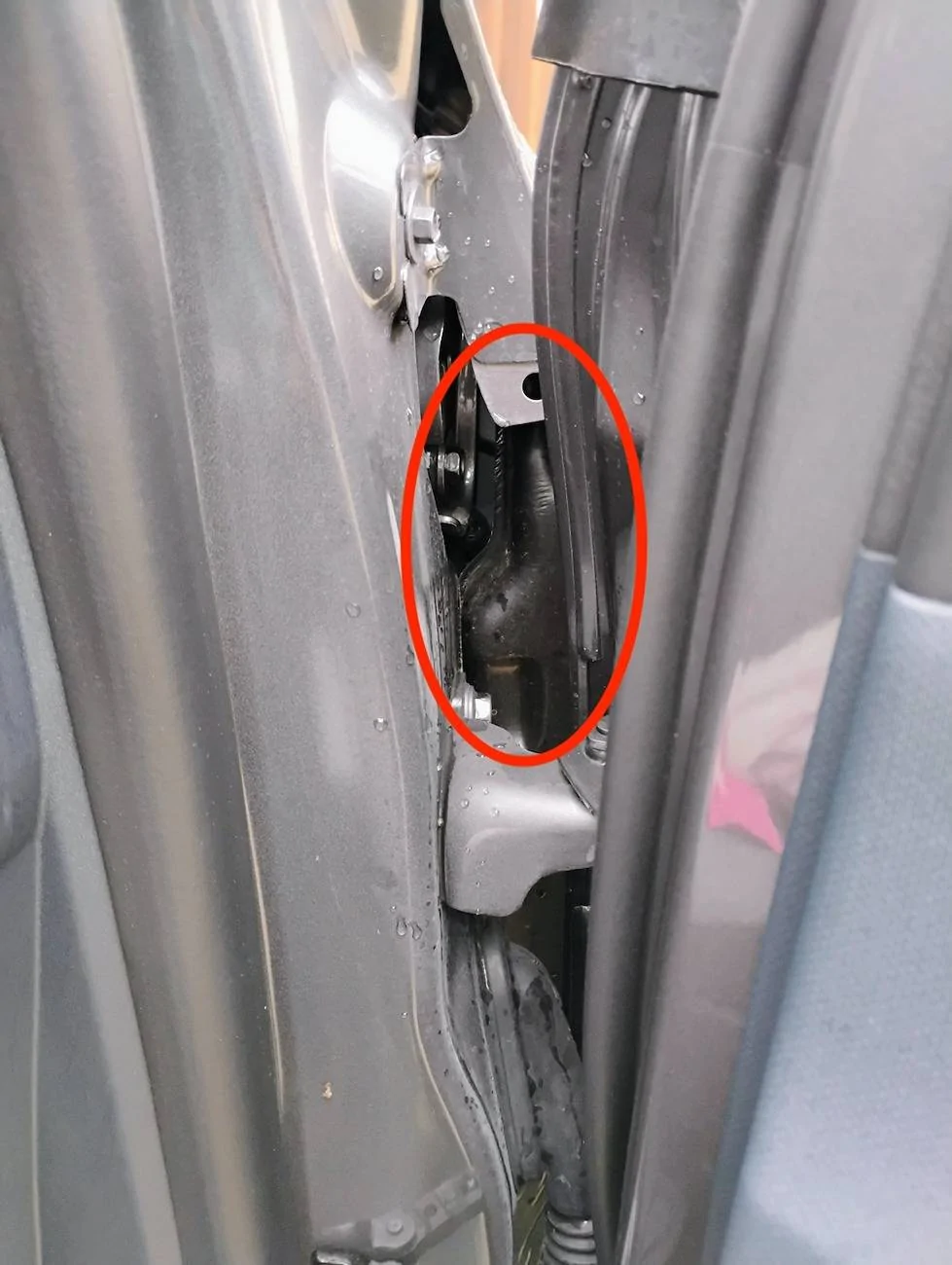

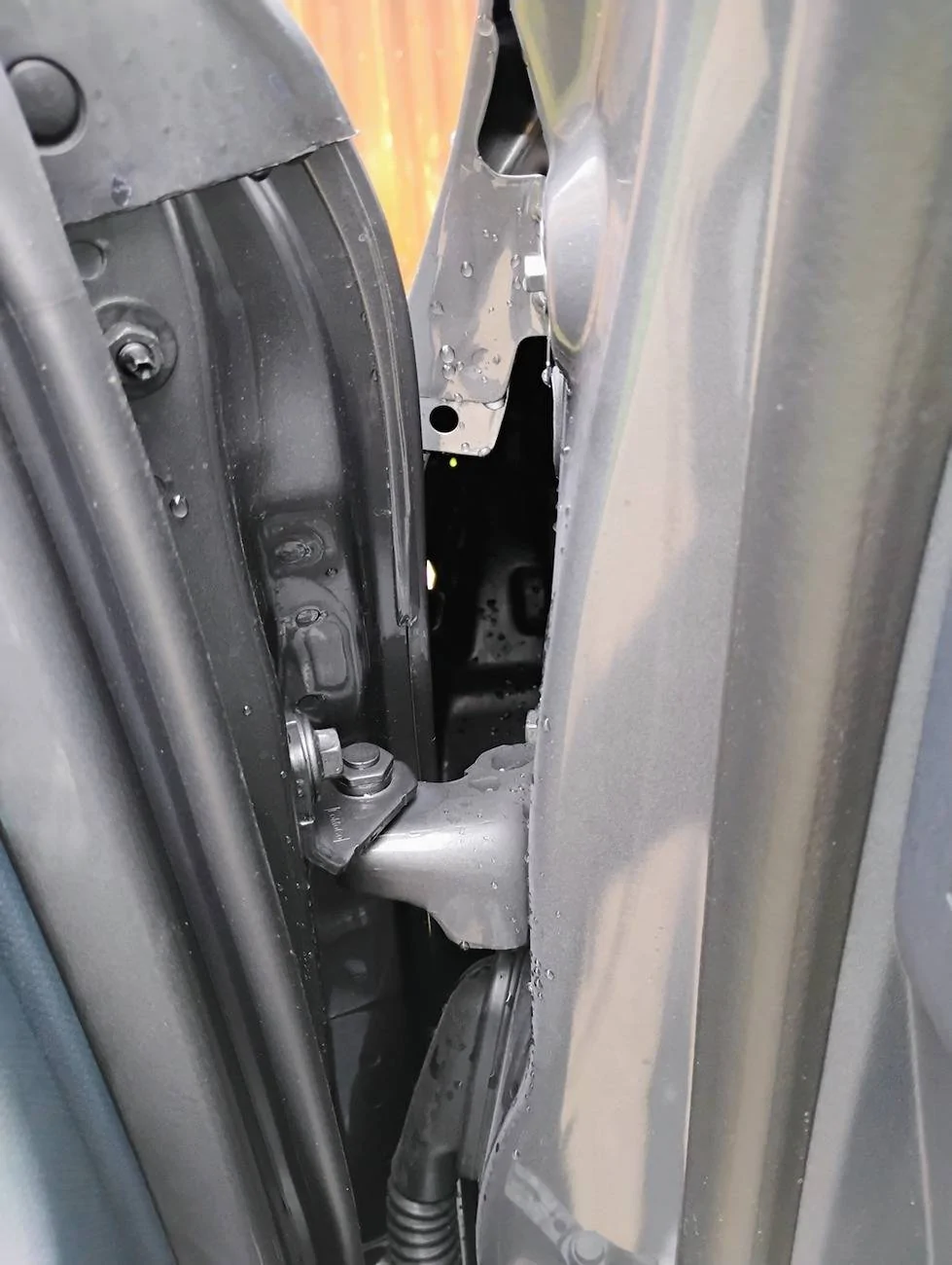

I just checked, you are right, on driver side, there is nothing, on passenger side, I can see a black faux leather foam baffle (see picture)

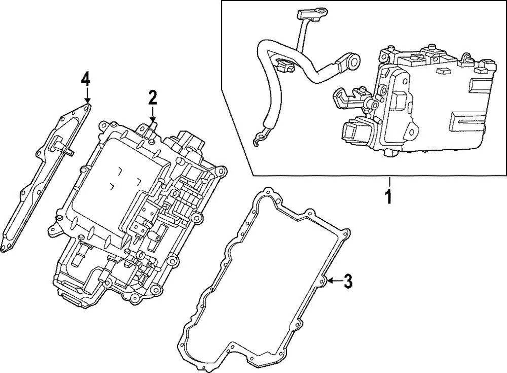

I guess if I put foam pad into the driver side gap, it may reduce the "whistle" a lot, but not sure, this is intentional, because, there are DC to DC converter on driver side, it may need more air flow ?

Actually on your driver side picture - I think that is it, almost totally fallen over.
Maybe it's the inside of the wheel fender cover.
If it really fell over that far - don't waste your arm with scratches like I did, get that coat hanger.
I had straightened and pulled mine up once, and discovered it down again recently.
This 2nd time I felt a bracket sticking out in what appeared to be a good spot to better wedge the foam on.
Time will tell if it really helps.
Oh - DCDC convertor over by tranny
