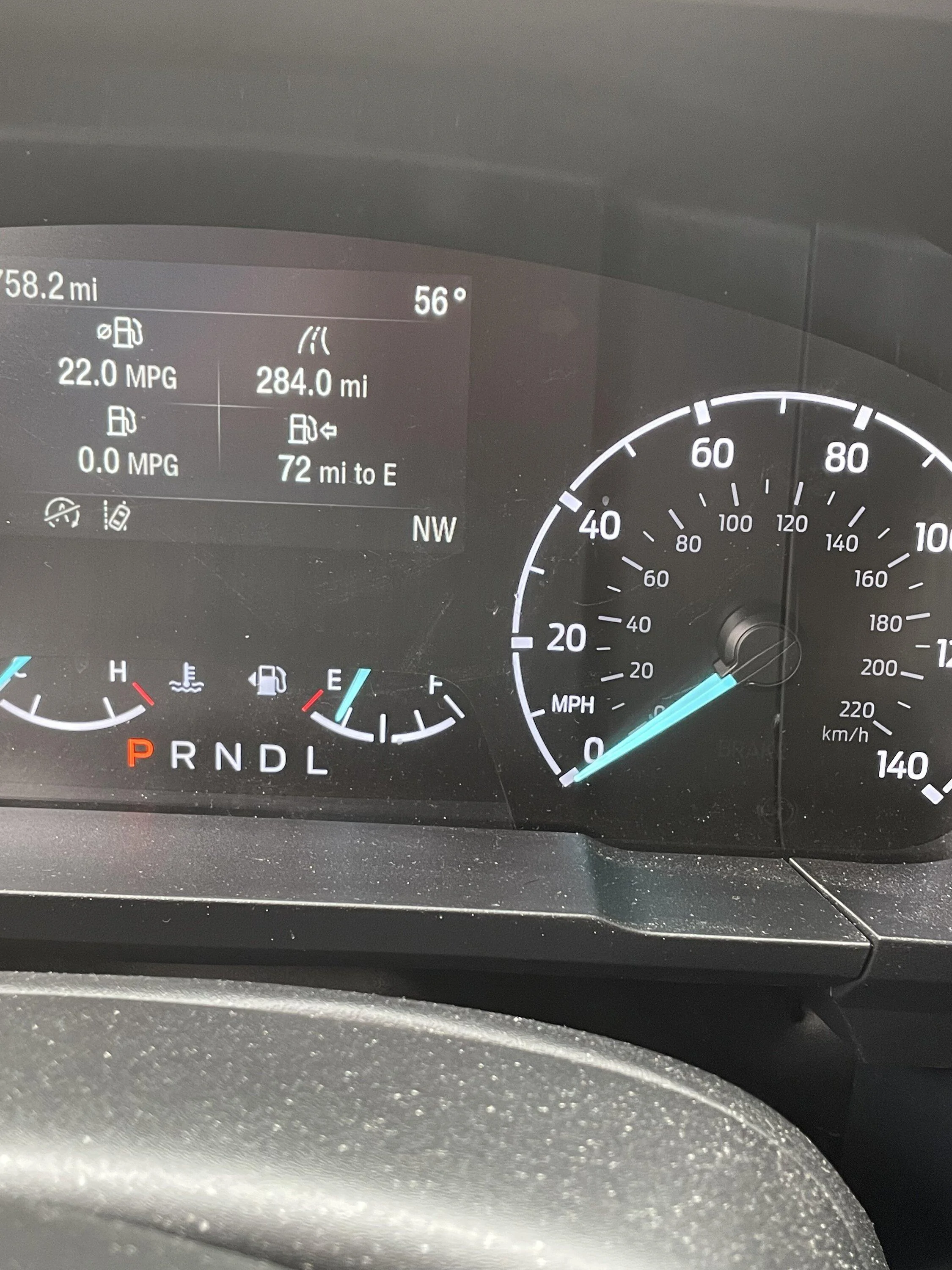

“Got a bit warm”?
The ambient temp shows 56*F and is likely the reason the AC isn’t cycling.
Good luck

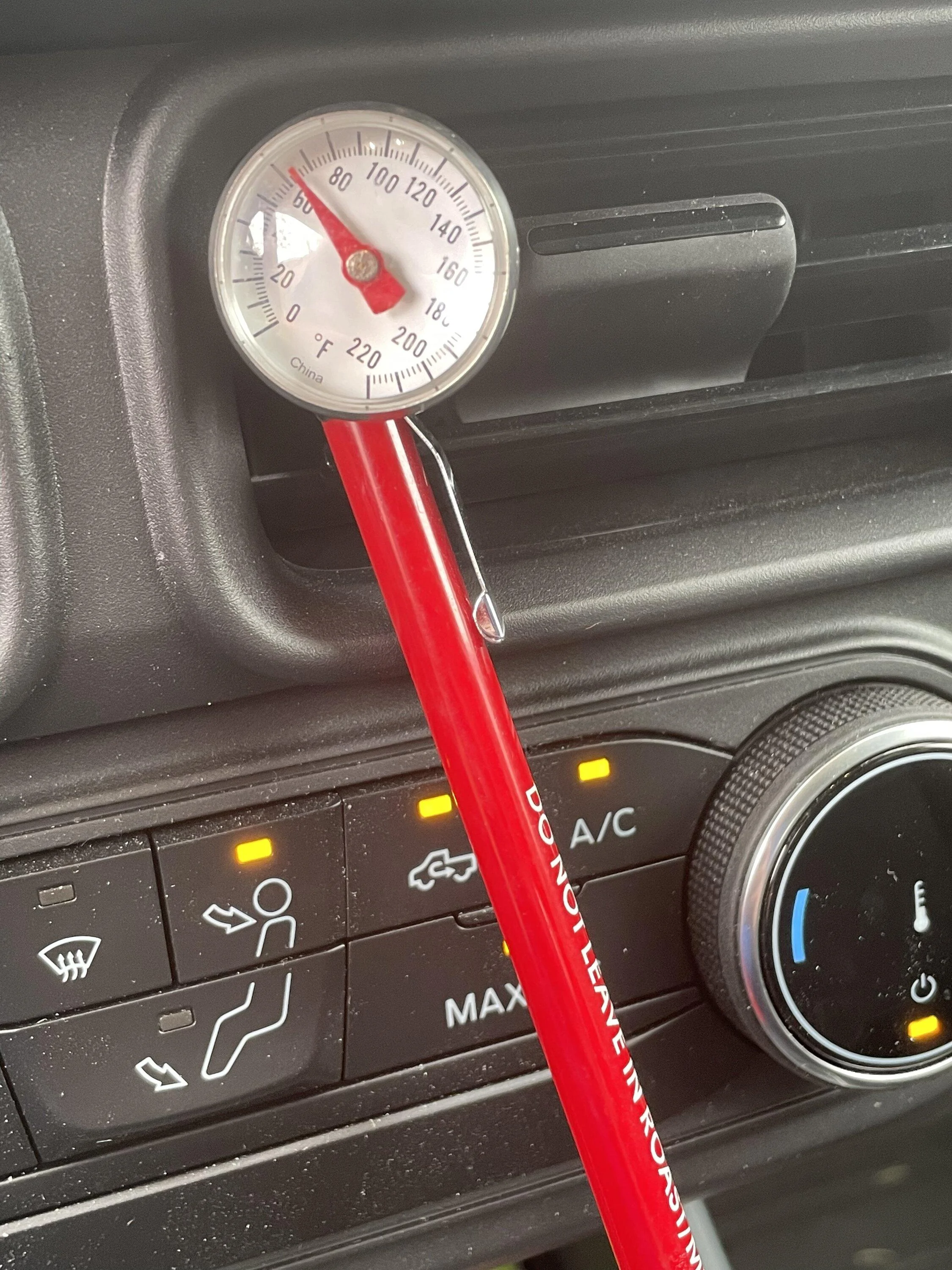

Just to clarify the 1st time I tried the AC was Tuesday and the high temperature was 77 degrees F and with the AC on full fan and Max AC button lit there was no cooling at all and the picture was the next morning on Wednesday and while the temperature was 56 at that moment later in the day it was close to 70 and no cooling at any point. Temperature reached a high of 82 today and I tried the AC at various times throughout the day and always no cooling just moving air through the vents that felt like ambient temperature. Stopped and let it idle a few times and the AC compressor is most definitely running while AC is on and not running when AC is off. By running I mean the compressor clutch is engaged and turning.

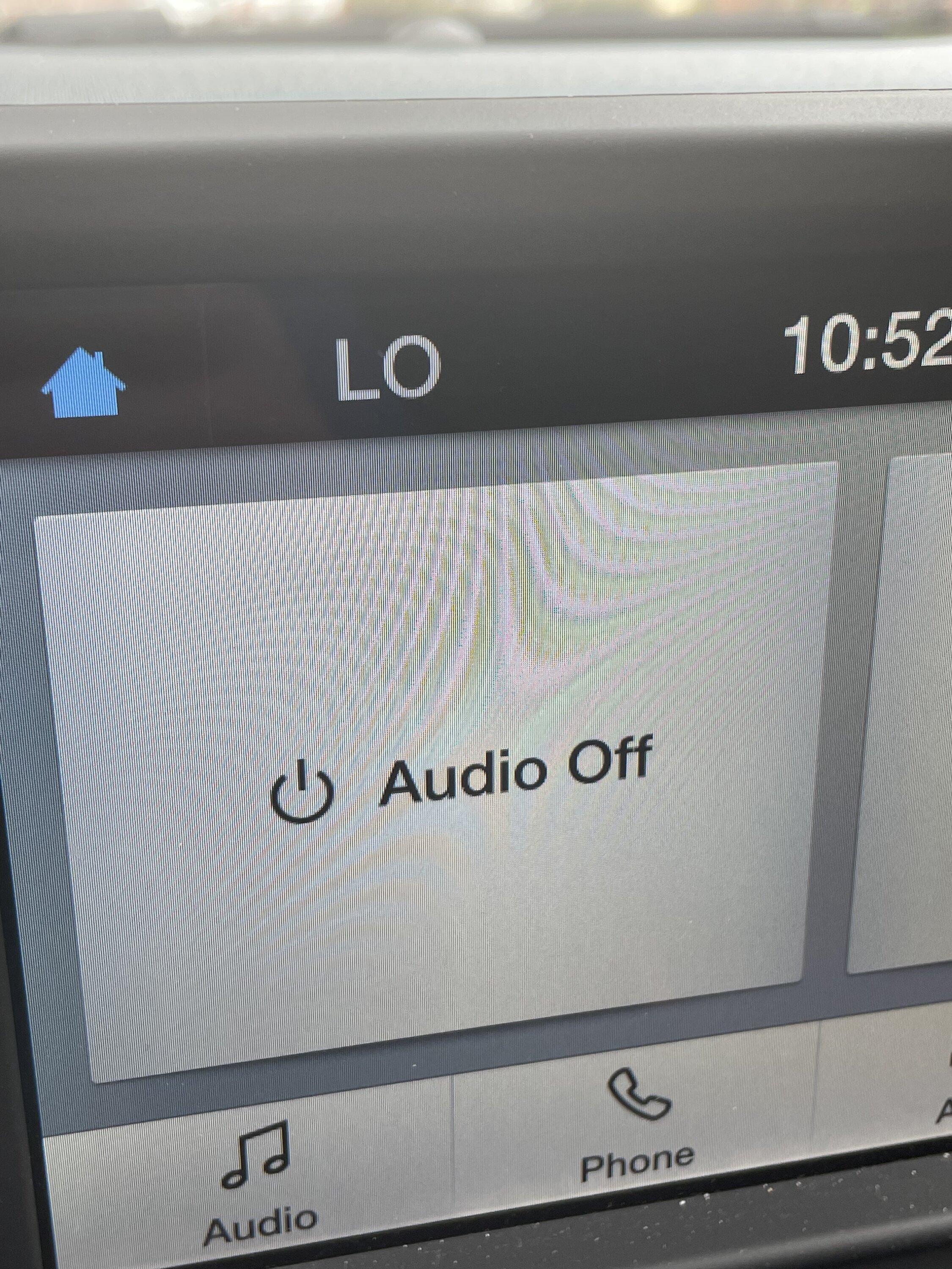

Sorry for your troubles. It is of course possible that you have a bad sensor but also remember that the system has among other things a humidistadt which when the LO condition happens regardless of your settings in order to prevent condensate forming at the dewpoint on your windshield the AC condenser is turned on and the defrost cycle is turned on which directs air output to windshield as well as as the deflector vents to the front side windows. Try turning off the recirculating air to help lower the humidity within the cab. Also it appears that you have MAX AC selected (red thermo handle mostly covers the light up on it) and this also can over ride some settings so I use max only temporarily and let the automatic stuff do it's thing. Try reading the manual on remote start and AC paying attention to all the details lines. It is a hard read!!! Good luck.
Perhaps you are low on refrigerant or it's not circulating due to bad valve?
Thanks MakinDoForNow, I am leaning towards an electronic issue myself. I tried with Max AC on and off (it was on in the picture) with no change and today the air was actually a few degrees warmer than outside temperature so it is definitely not cooling at all.

clearly either the compressor or the blending door aren't working. There is nothing that makes that AC not work in normal temps.

As far as the AC /Heat they said the temperature sensor was showing a low voltage reading and when they physically checked the wiring one of the pins was dislodged from the plug. Once they repaired that everything’s working as it should.
