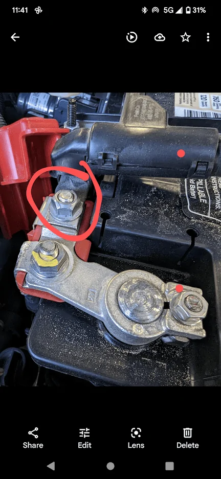

After getting my battery exchanged, I started to get dash error/warning messages about a charging system problem. At the dealer this morning we found one of the positive battery lugs was loose- Its one that attaches to the harness and in that you can change the battery without even touching this nut but it was loose. Tightened and everything checks out ok now with diagnostics.
Attached a picture for reference.

That yellow paint stripe on the other bolt indicates it had an additional quality check performed, most likely to verify torque.
Perhaps they should refocus their efforts.
Yep lug without that stripe just left to rot- lol- A/S/S works fine now even in cold weather-

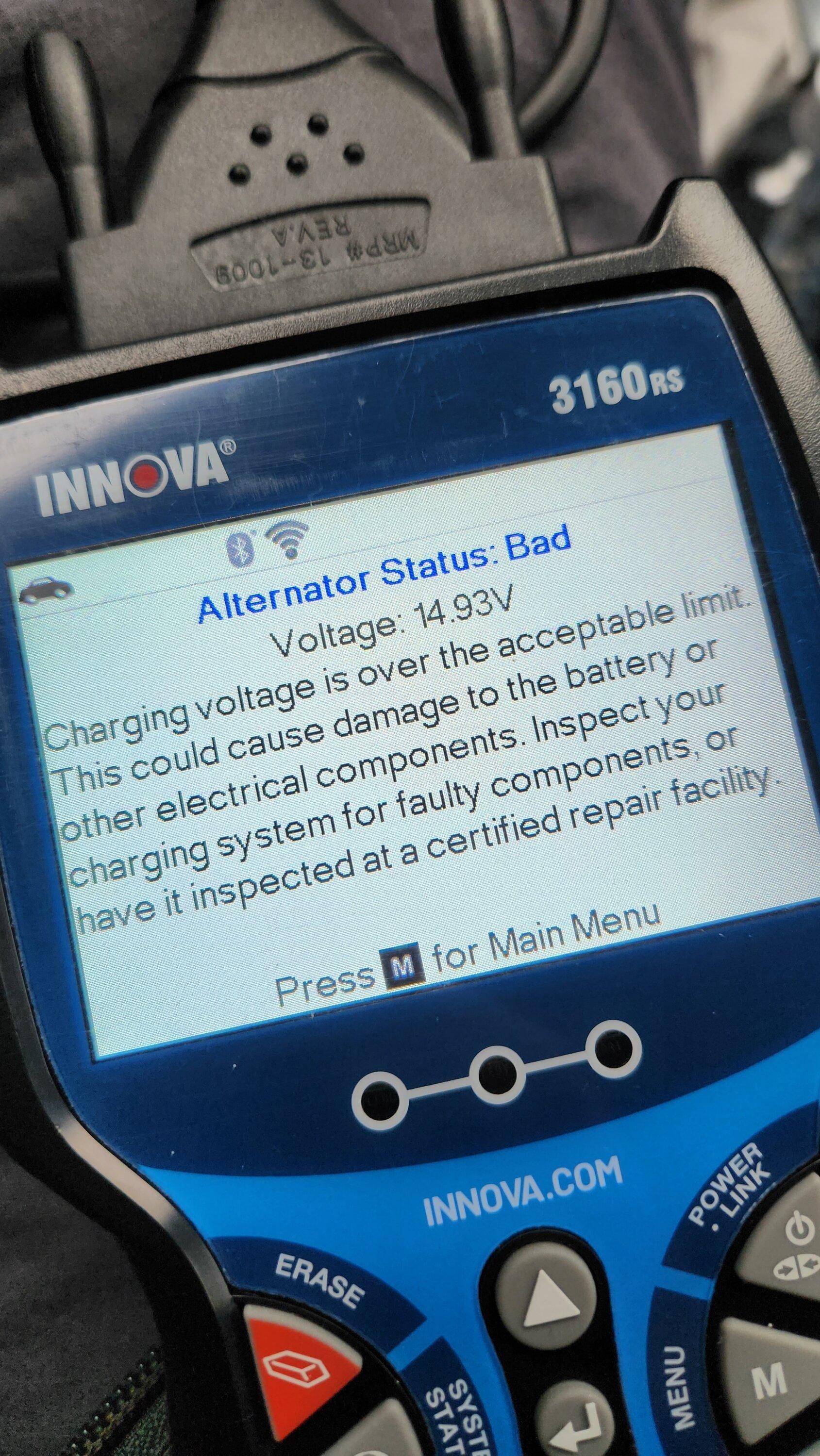

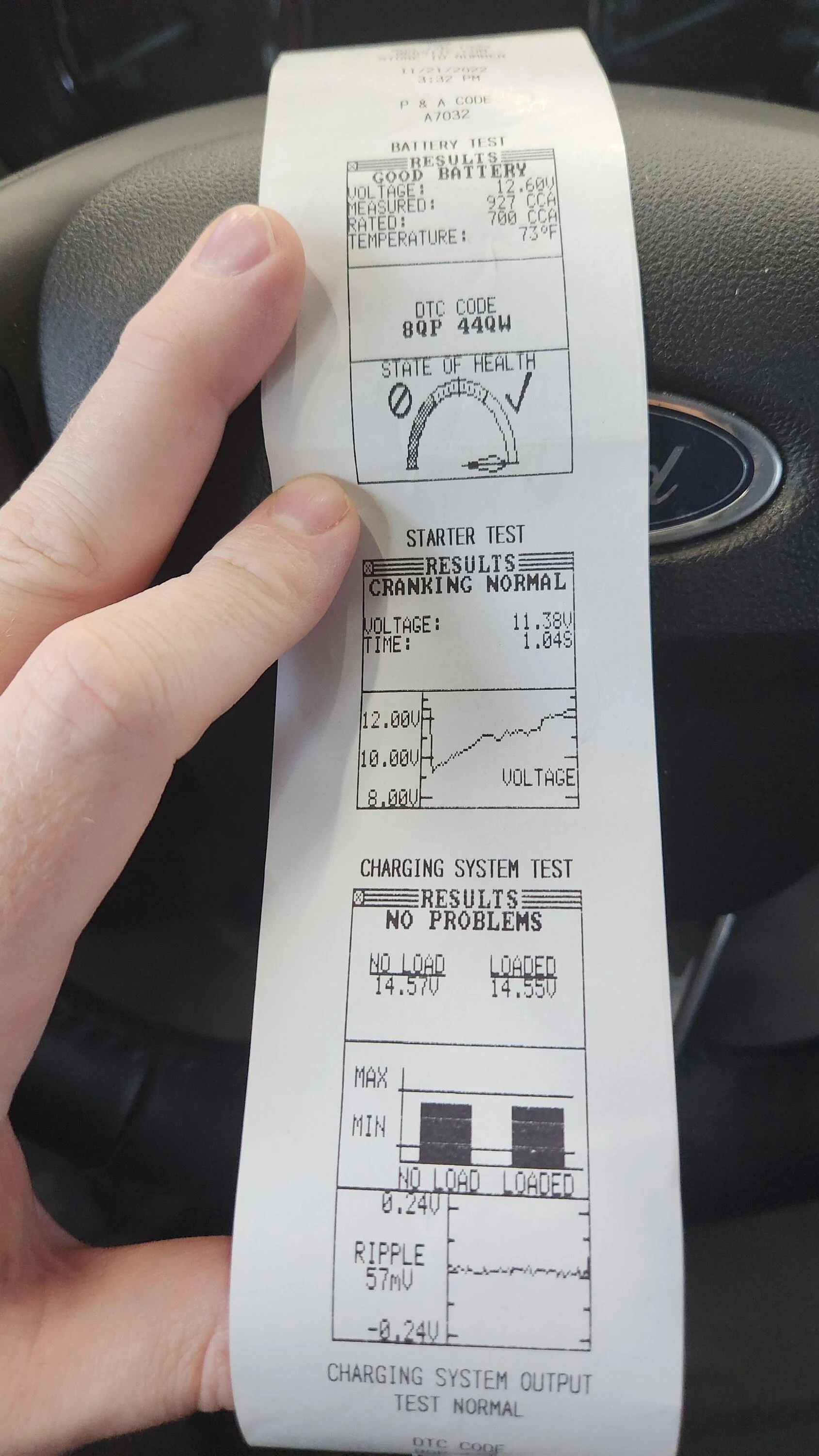

Found nothing for the 4th time in there won't charge the battery so starts stop won't work. Won't go over 12.6 no mater how long its on for
Just curious have u done the battery/charging system reset ?
