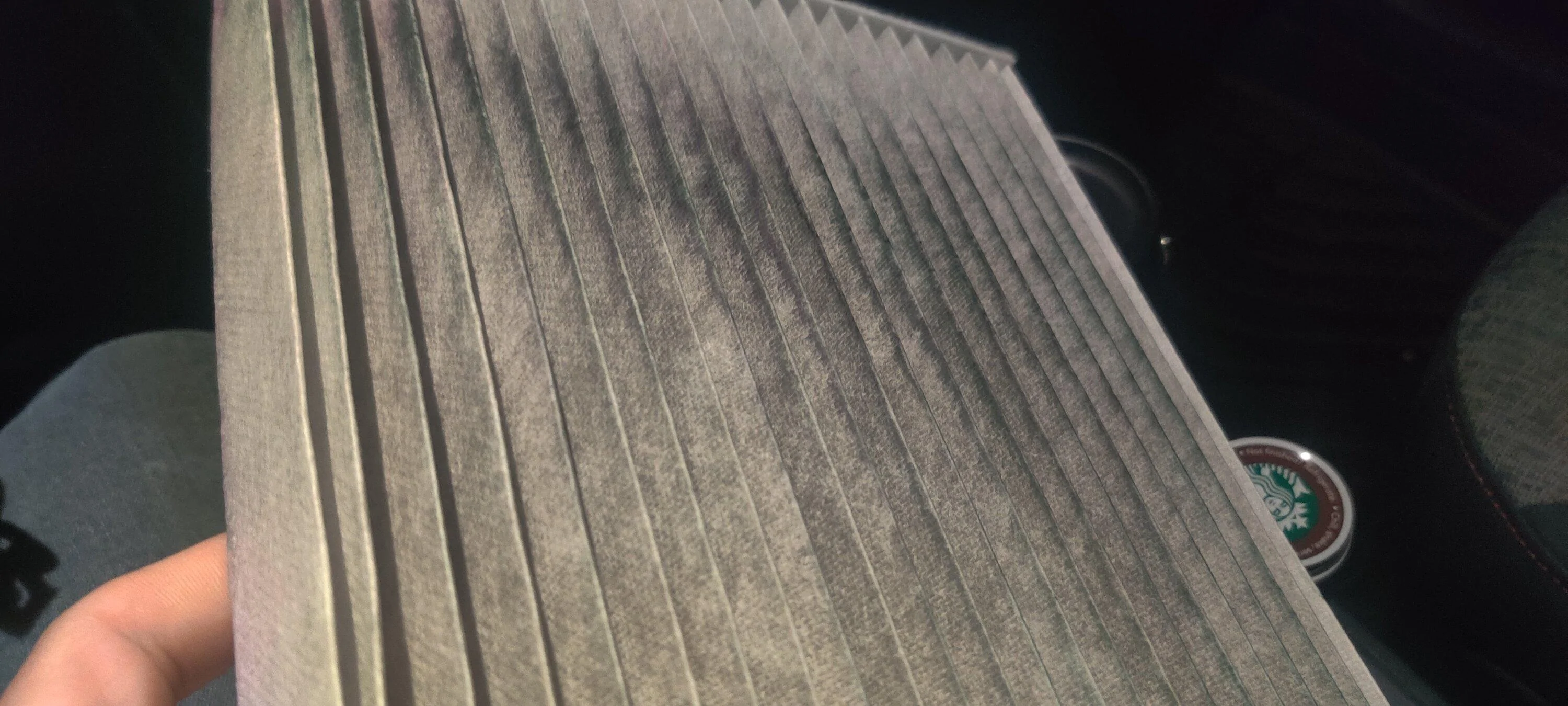

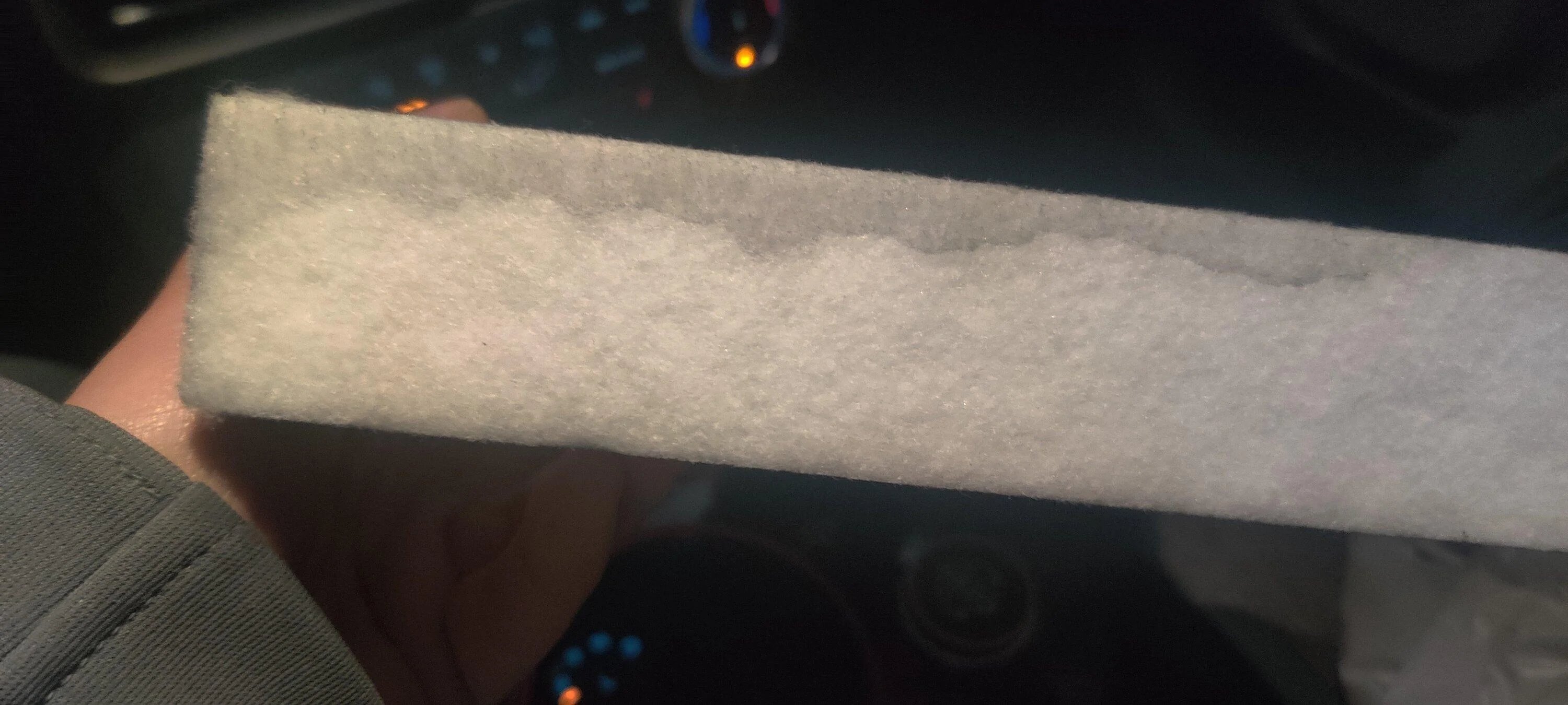

Here's a couple pics after it dried. You can see the discoloration of the filter from the foam and the water line on the side. Only has 1500 miles on it.

Wow that's kind of crazy - Good learning experience though. Turn HVAC /OFF during car washes -

Seems like a bad design. Wait till the lawyers see this and grab a class action suit for mavericks with mold
I can see this being both a health and safety issue. Between the abundant of moisture within the filter causing mold. And the wet filter blocking aif flow enough to prevent the windows from defrosting after a hard cold rain on a hot day as an example.
This has me curious enough to pull it apart and see what kind of design they came up with. And see if there is something I can fabricate to better prevent this from happening again.
