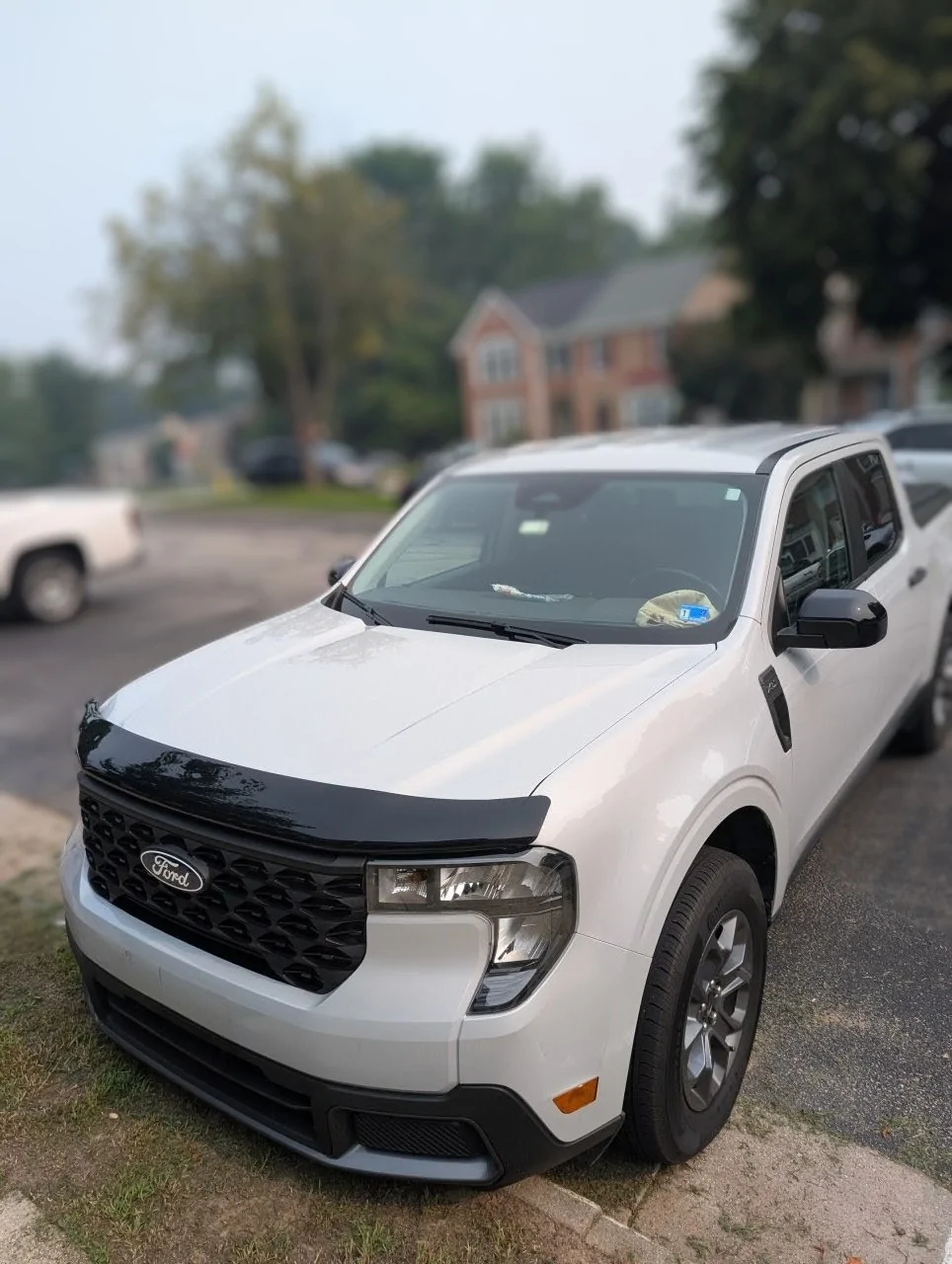

I have a 2025 XLT AWD HYBRID. You have to pop out the fasteners holding in the hoods rubber seal, slide the liner under the seal, then put the fasteners back in to hold it in place. It is in the Husky install video.
The only thing I did different was I didn't remove the entire rubber seal, just the fasteners where the holes I needed were. Worked like a charm.
