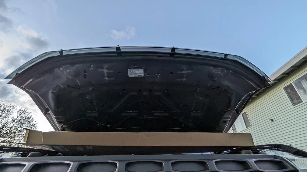

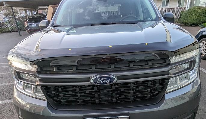

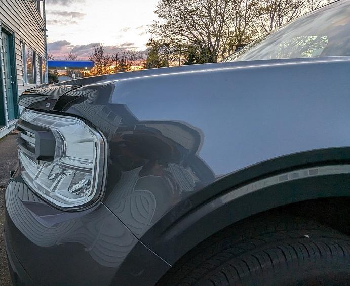

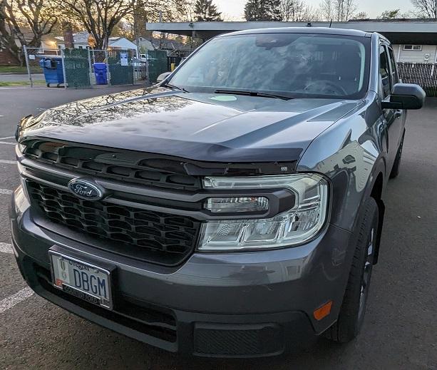

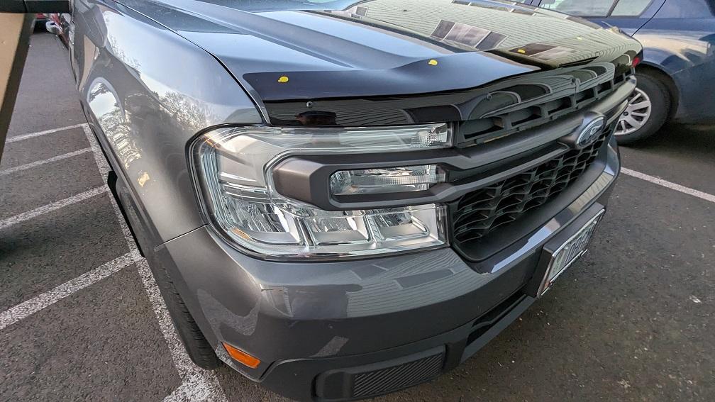

Note:
  • There is no drilling required.
  • Only the 2 center brackets screw into the hood, I am worried about removing the gasket clips, I might add double-side tape to keep it in place.
  • The last four end brackets slip over the hood, no matching drilling needed.
  • I did not mark the hood with a marker, I placed the clear tape inside the bracket and slipped it on.
  • I did not install the hood bumpers, its looks strong enough to hold its shape, and it would make it difficult to clean under the deflector.
  • If I do install the hood stops in the future, I will stick it to the underside of the deflector instead of the hood so I can remove it and wipe under it.
  • It doesn't stick up as some photos suggest in other posts, it is pretty low to the hood.
  • Recommend preinstalling the clips into the brackets, and preinstalling the brackets to the deflector, this will make things go smoother / faster.
  • Total install time less than 5 minutes if you preinstall everything together.
  • The edges align with the hood seam / gap and do not extend past.
  • I chose this removable deflector because it reminds me of the old school deflectors, the Ford ones do look cleaner.

That looks alot better than the sticker type ones.
