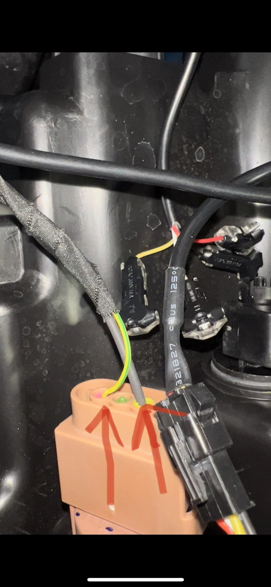

Here is what you need to tap into. On the driver side you’ll connect the white DRL+ into the white wire and the red 12V+ into the brown/blue on the main headlight plug.
Ford Maverick How to wire switchbacks on Lariat DRL 512918DF-7518-4A2C-A069-642D45E081A4

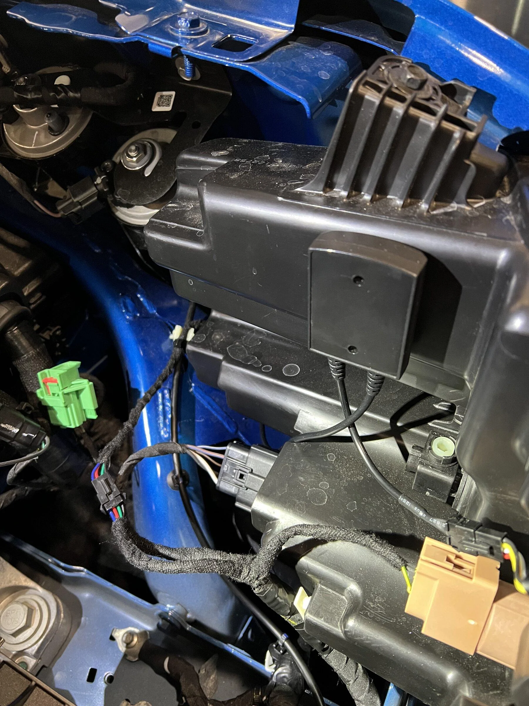

Next you’ll be tapping into the turn signal wires, there is only 2 wires so it’s simple. Take the black 12V- and tap into the black wire off the harness, final will be the yellow wire Turn+ and that will tap into the yellow/green wire
Ford Maverick How to wire switchbacks on Lariat DRL 6275FC0D-D2B1-4D9D-B808-CFA537498896

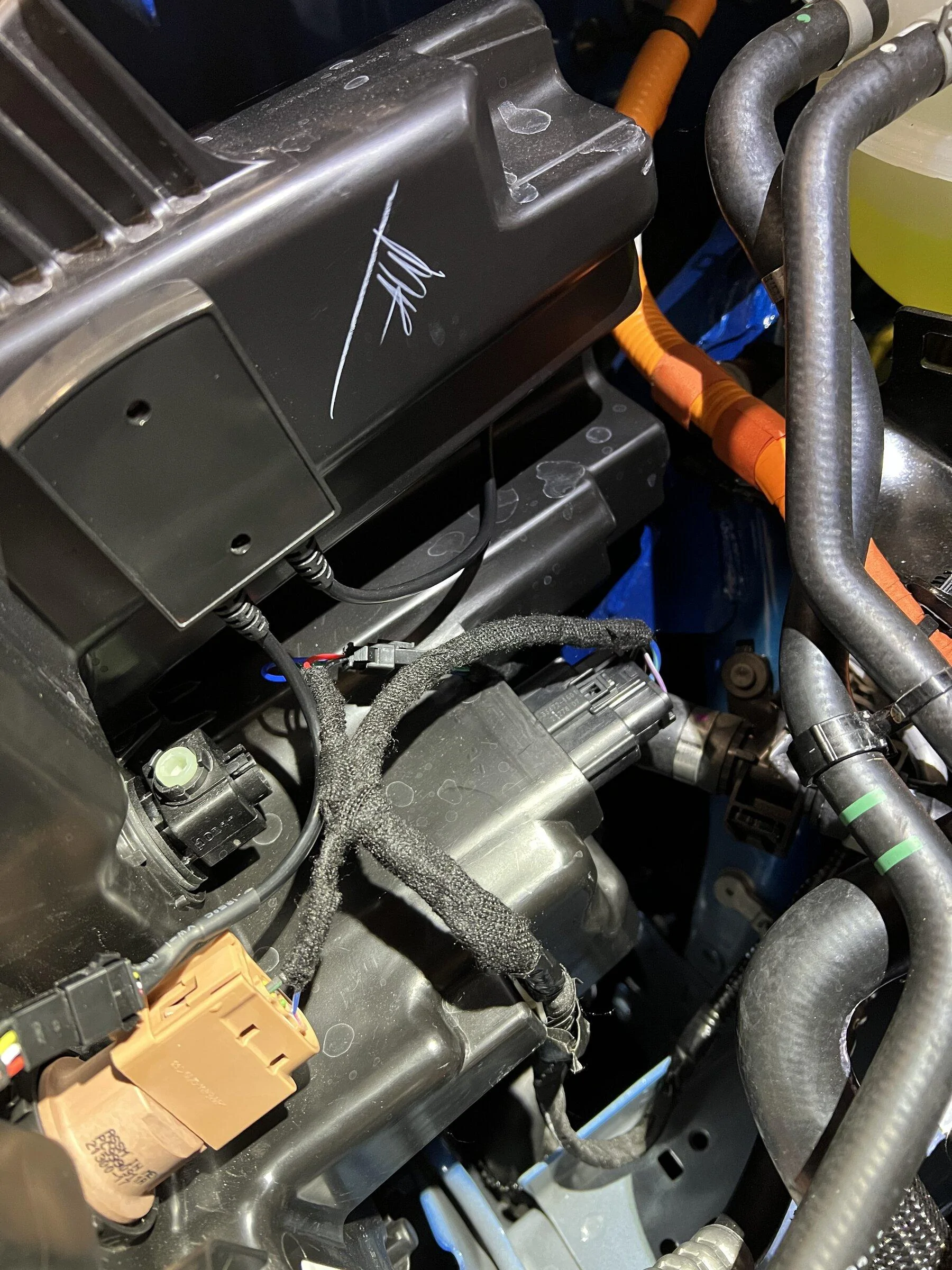

I do not suggest using “T-Taps” or vampire taps but you do you. What I did was bough cheap 4 wire harnesses off eBay and just soldered into the factory harness. I wrapped it with wire harness electrical tape and it looked very factory.
Ford Maverick How to wire switchbacks on Lariat DRL 99C98C9A-D941-42EF-BF96-EEF7227736B0

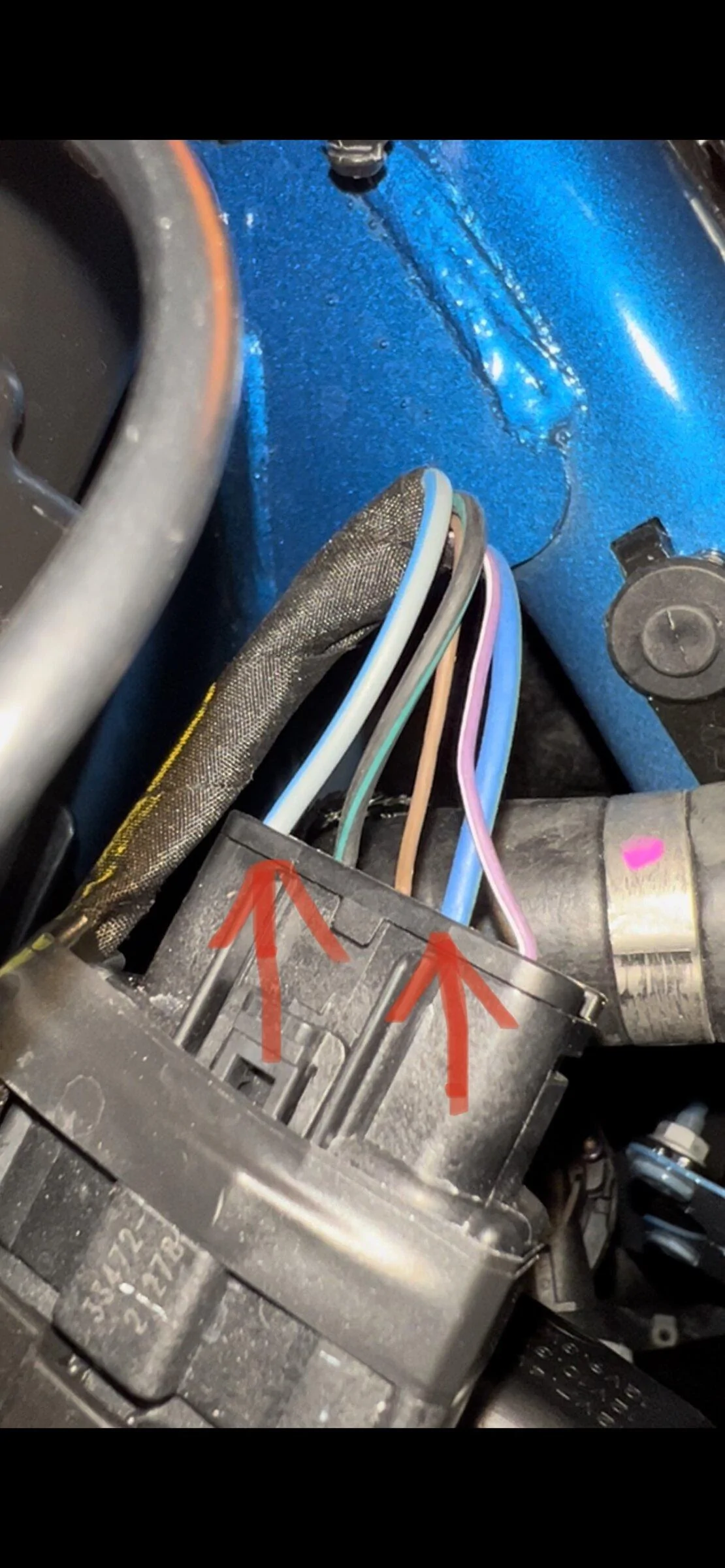

Next up passenger side, wiring colors are different but same pin orientation.
You’ll connect the white DRL+ into the Grey/blue wire and the red 12V+ into the green/blue on the main headlight plug.
Ford Maverick How to wire switchbacks on Lariat DRL C03F7876-5A46-41B2-8B69-29BC3DF4C57D
Next you’ll be tapping into the turn signal wires again, Take the black 12V- and tap into the black/green wire off the harness, finally will be the yellow wire Turn+ and that will tap into the blue/white wire
Ford Maverick How to wire switchbacks on Lariat DRL 30A36F7D-D66E-4481-ACB1-15FBD66DFA3C

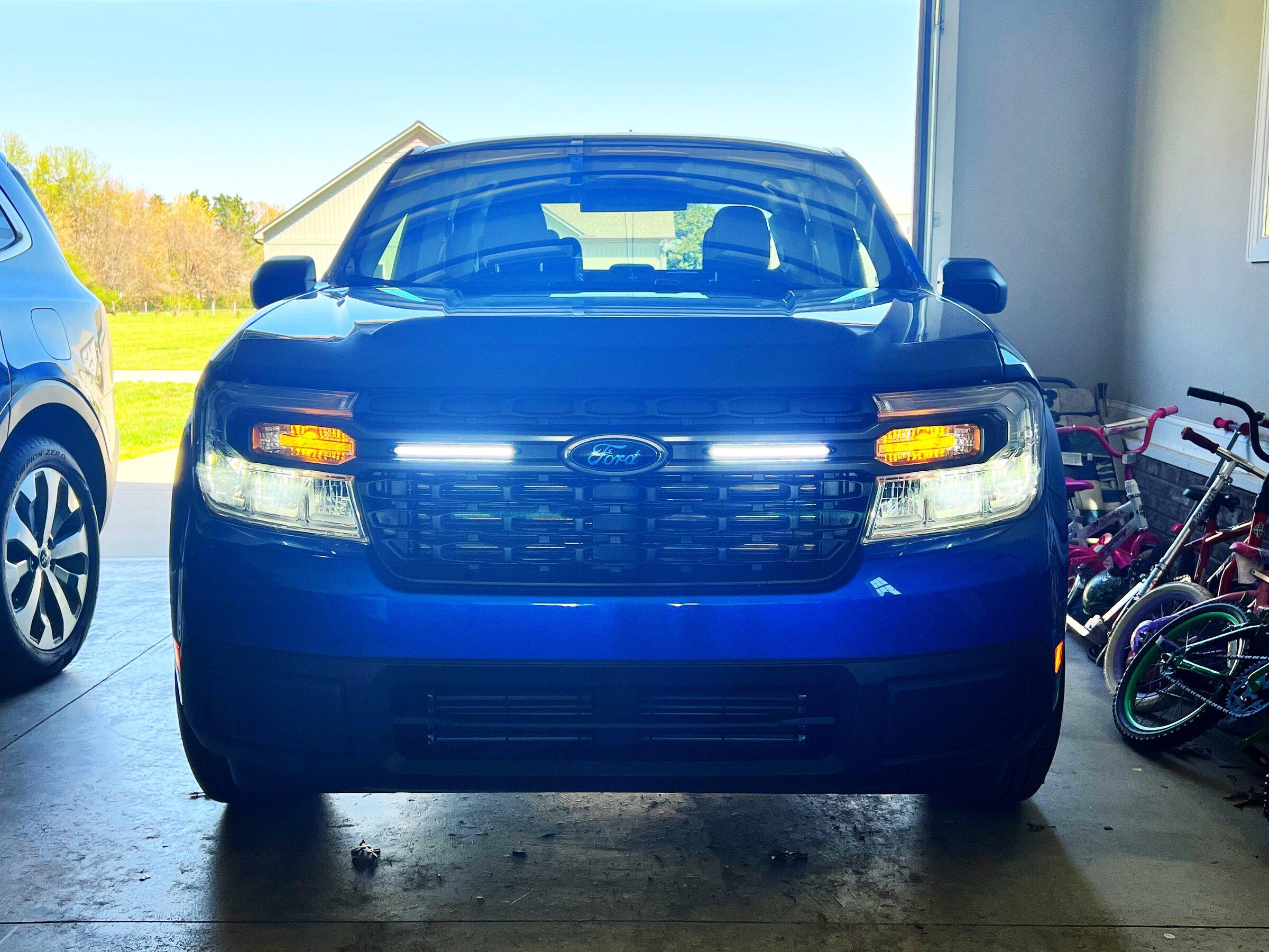

I did the same sub harness on the passenger side as well.
Ford Maverick How to wire switchbacks on Lariat DRL AE3C5F3F-7F7B-4C41-94E2-8F943DB078EF
Final product will result in this

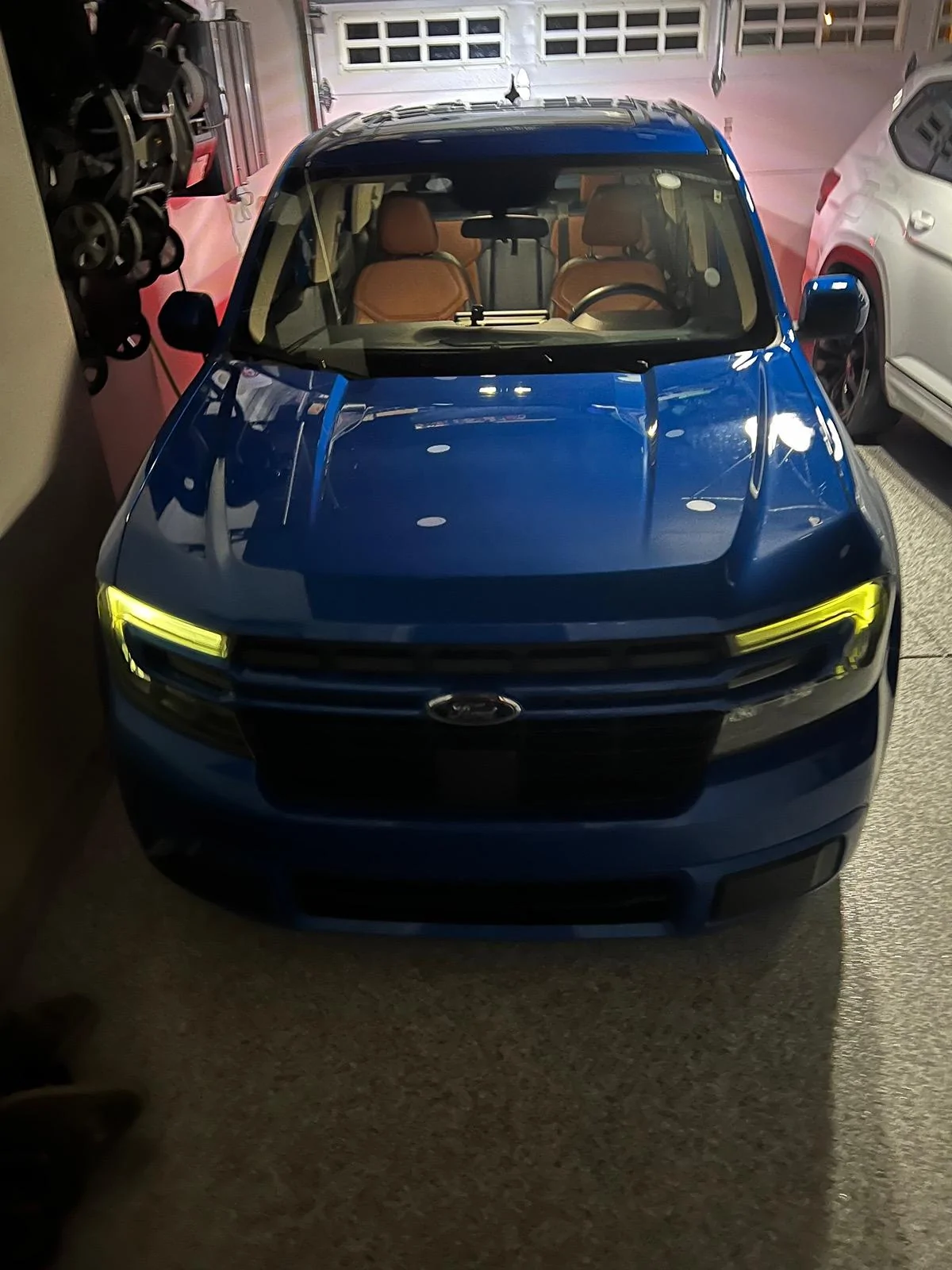

Only issue is having is the DRL portion of the light isnt at its full voltage causing the aftermarket switch backs to be dim
Ford Maverick How to wire switchbacks on Lariat DRL IMG_2805
however once the headlights are actually on they are fully bright and the switch back function works. It’s doesn’t work if the headlights are not on.
