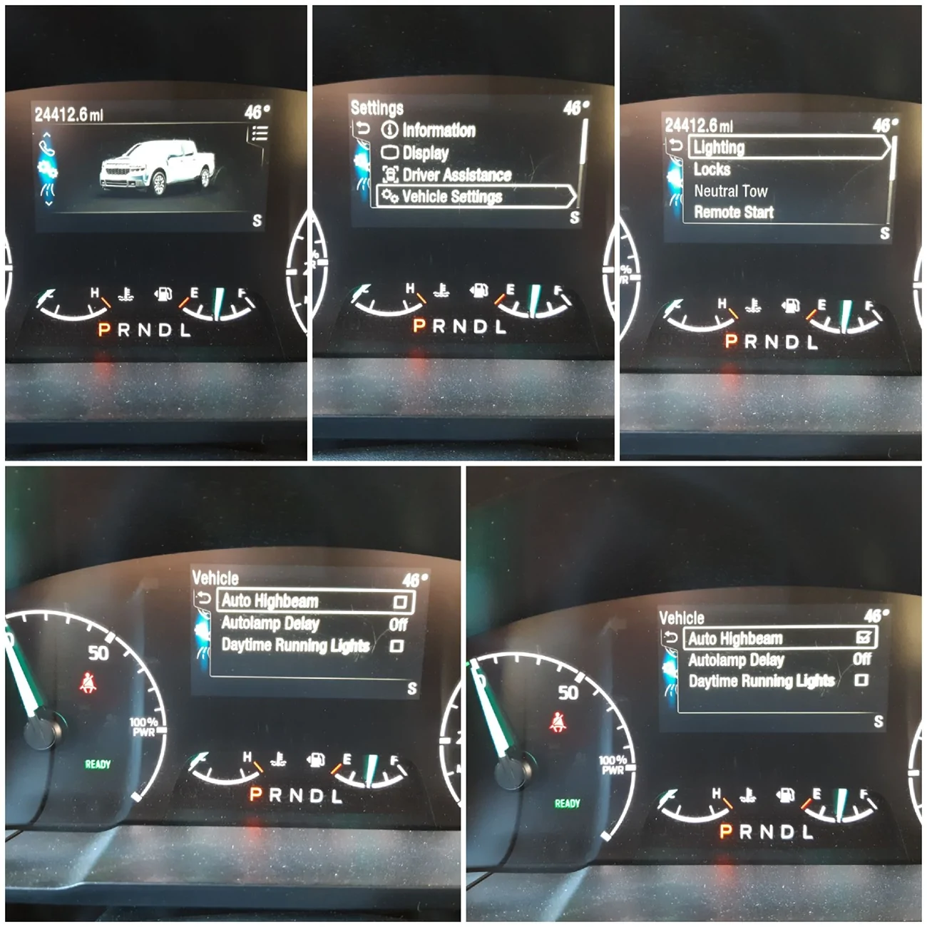

I don't own a PC, laptop, tablet or skills to mess with the trucks build code. Therefore I have never touched the FORScan system.
As far as your headlights on during the day because you have a 23 xl your headlights are on because they are used as Daylight Running Lights.
Using the right controller on your steering wheel. You will be using the the right button the OK toggle for up and down and OK.​
To toggle through your different screens. You'll highlight the daytime running lights and then press okay and it should uncheck the Box.
Then you'll use the button on the left or the return button and return through your screens to the beginning. I hope this helps.
