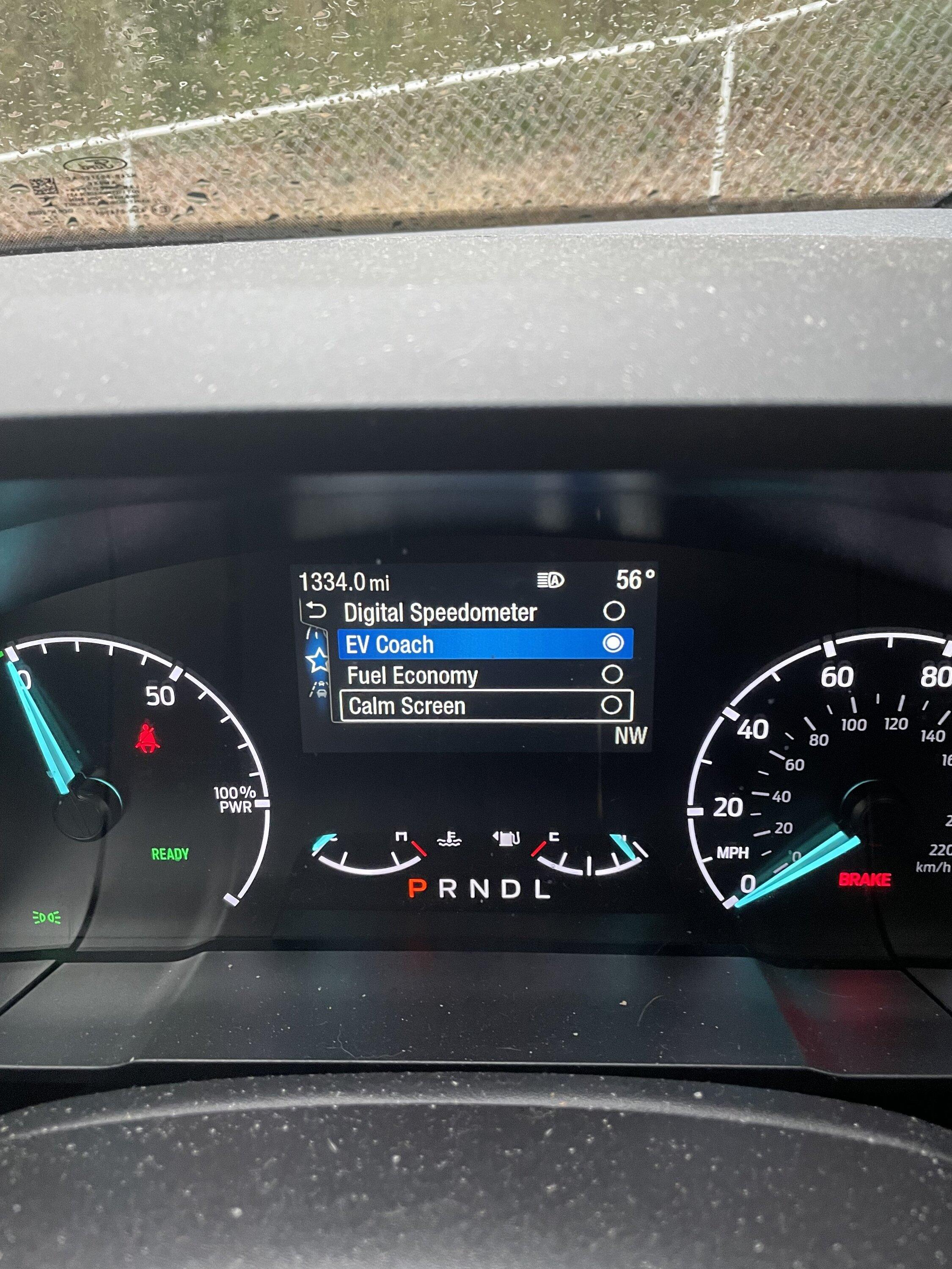

Owner’s Manual 2023, page 116? Calm Screen I think, maybe only hybrid

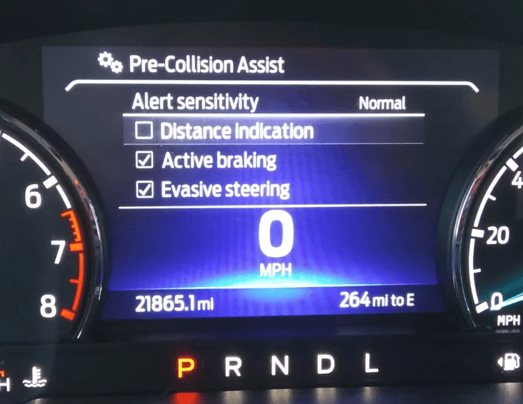

I was able to get the larger speedometer displayed after unchecking Distance indication in Pre-Collision Assist, and when ACC and Lane Keeping are both off.
