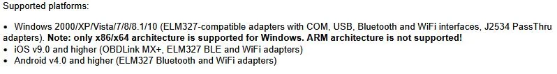

it "should" be good for basic things, including Forscan. Forscan supports windows 11 and requires and x86 process (the Dell you're looking at is a Celeron core, which is x86). no guarantees though!
