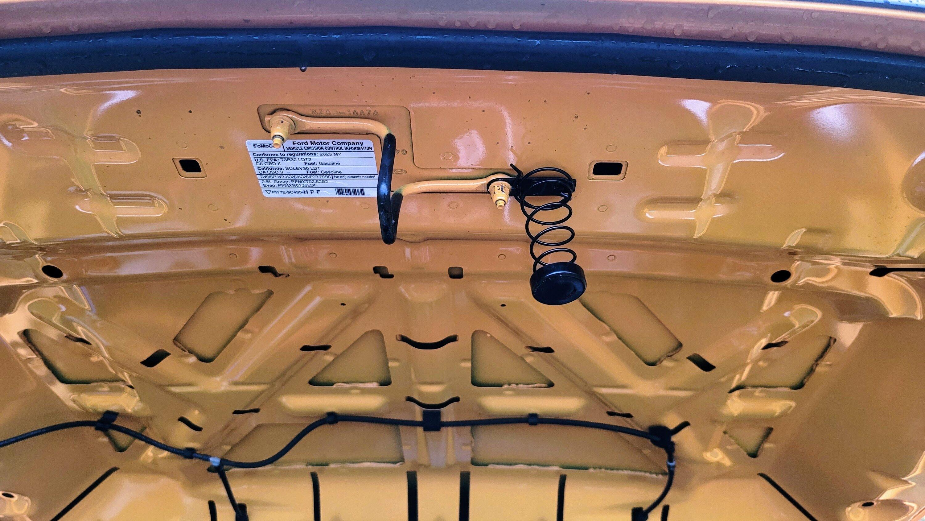

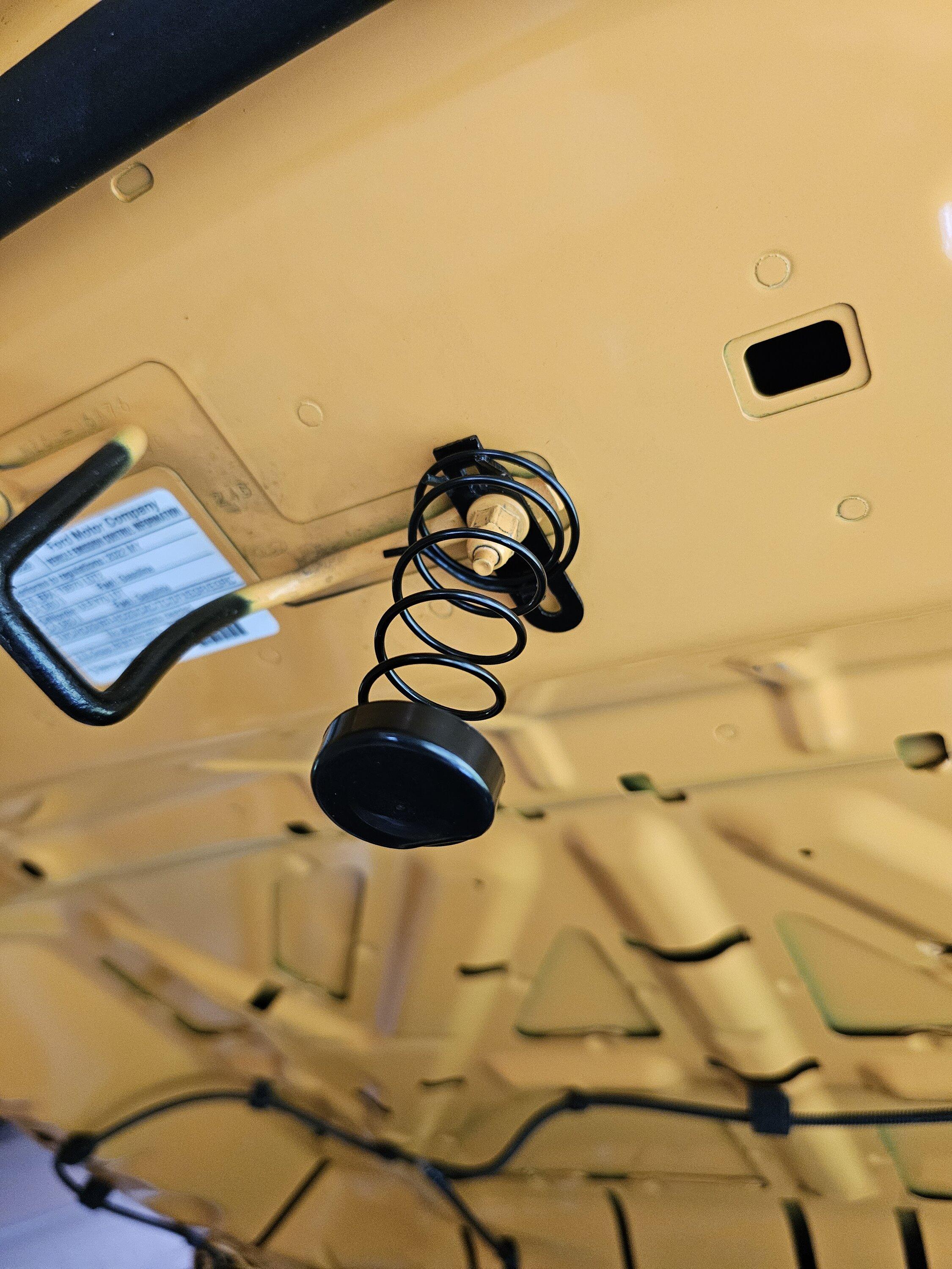

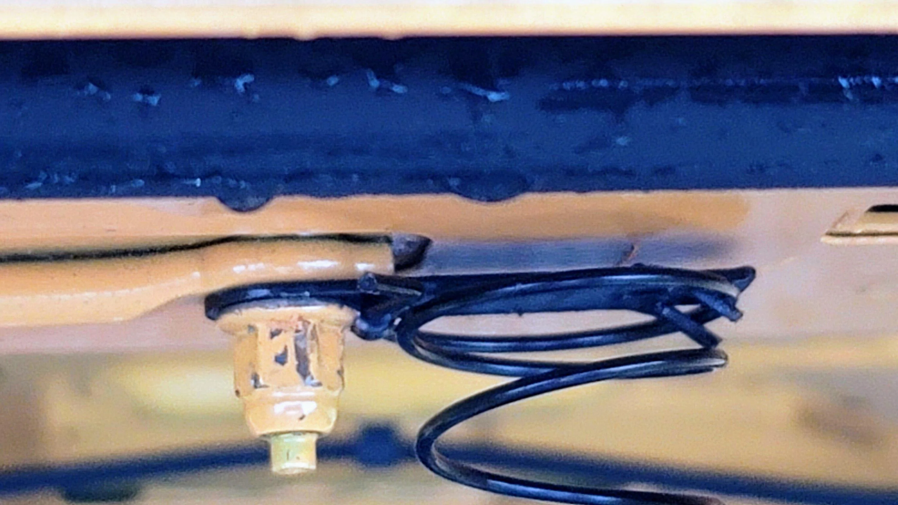

Guys, I have the aftermarket hood struts installed. No issues until today. Popped the hood once, but couldn't get it up all the way.
In the past, I have had someone hold the lever up so I could get it to release all the way while I gave some gentle pull on the partially opened hood. However, this evening no one else was around. So, I just closed the hood. No problem, right? Wrong!
Now the hood won't open at all! Needless to say, I am pretty annoyed. Really do not want to have to take this into the dealer to get un-stuck. Anyone else out there experience this, or have a solution?
I have seen a thread where someone installed a spring-loaded bumper to avoid the partial open, which may be something I need to add going forward. But right now, I just need to get the hood open again. Turning to my MTC family for advice. What'ya got?
Here's a video showing the cause, how to fix it and then add the spring to keep it from happening again.

Have you seen any further threads where getting the cable pushed back up to its spot and clicked into place STILL doesn't get the hood open ? Mine opens a bit on the first try , but then the 2nd pull does not do anything, not even move the cable . I feel like the release lever on mine might be disconnected somehow idk. But I need my hood open like a week ago lmao
Techcar
Wyatt
Nov 6, 2023
80
151
Stokes Co,NC
2023 Maverick XL, 2019 RangerXLT
Maybe this will help you
