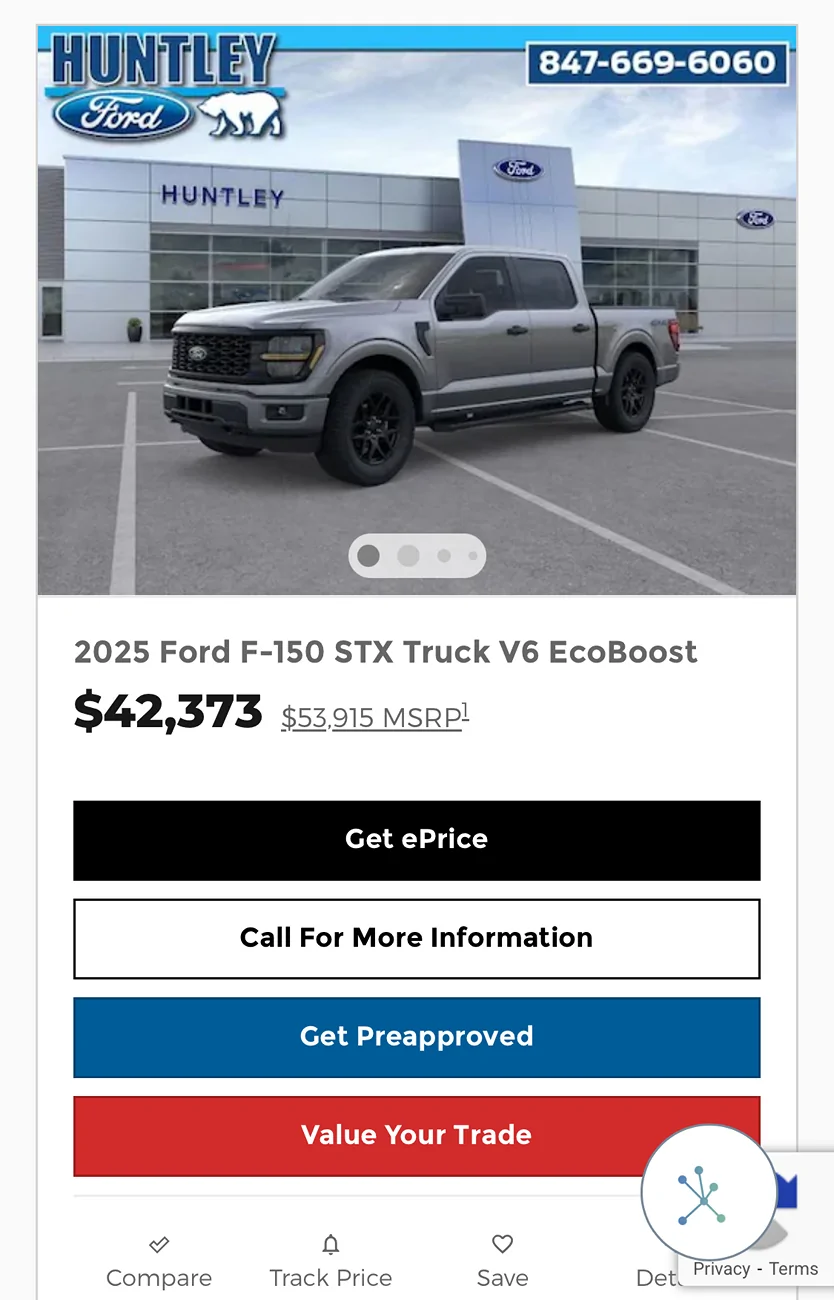

Well I didn't have the TT 3 years ago.
And I commute 88 miles a day.
But it did surprise me a little that 2025 model year close-out F-150's are priced the same as a well equipped Maverick.
Careful Careful, Ford Finds out you exposed the bait and switch to the Maverick addicts and your extended warranty just might expire a bit too soon. :'P
