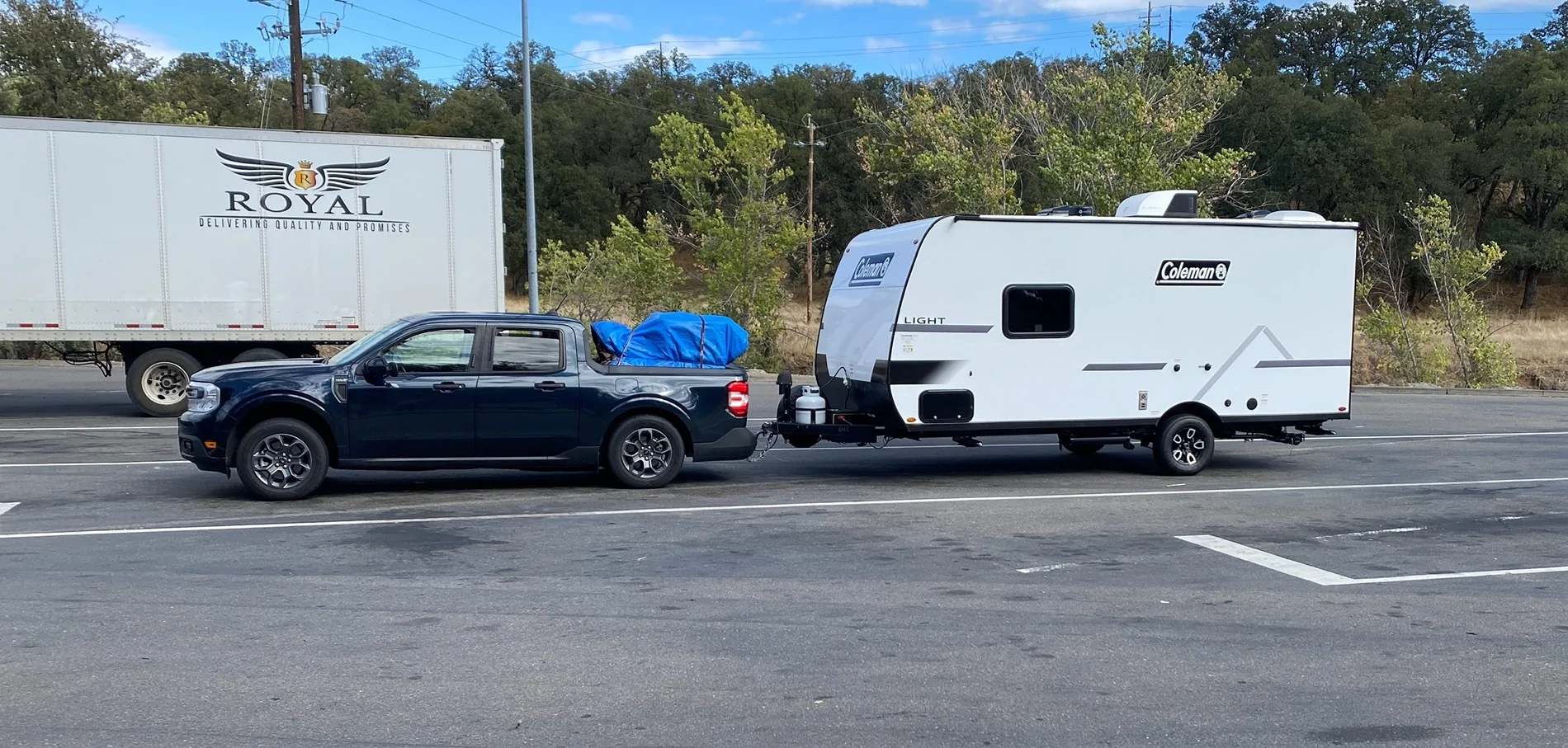

It was the cheapest the dealer offered, and they included it at no cost. I knew without it, the single axel would "porpoise" and this was the safest option to use with unibody. I would not use any other hitch on a maverick.
No porpoiseing here.
$110 air bags in my rear springs prevent it.
Normal simple ball hitch working great so far. Close to 400 lbs on the ball.
I think being on the heavy side reduces tendency to sway too.
I would not go any bigger or heavier than this. This is maximum, and speed limited to 65 mph and under.

The Anderson hitch prevents the bed from lowering so much. Your bed is very compressed. My bed only lowered 1/2" pulling my trailer. Without the hitch, it lowered significantly, like yours. I was not comfortable with that kind of stress on the frame.

My bed had 1300 lbs!
900 cargo plus 400 on the ball!
A WDH tends to put more stress on the truck body, but if not overdone will be fine.
Yes, I was heavy. But the extra weight in the truck, I liked. I felt very "planted" and stable. It handled very well. Steering and braking events were confident and unremarkable. Trailer brakes braked the trailer. Stopping distance was not grossly changed. Needed a little more space, sure.
I think a light truck with a heavy trailer would be worse.

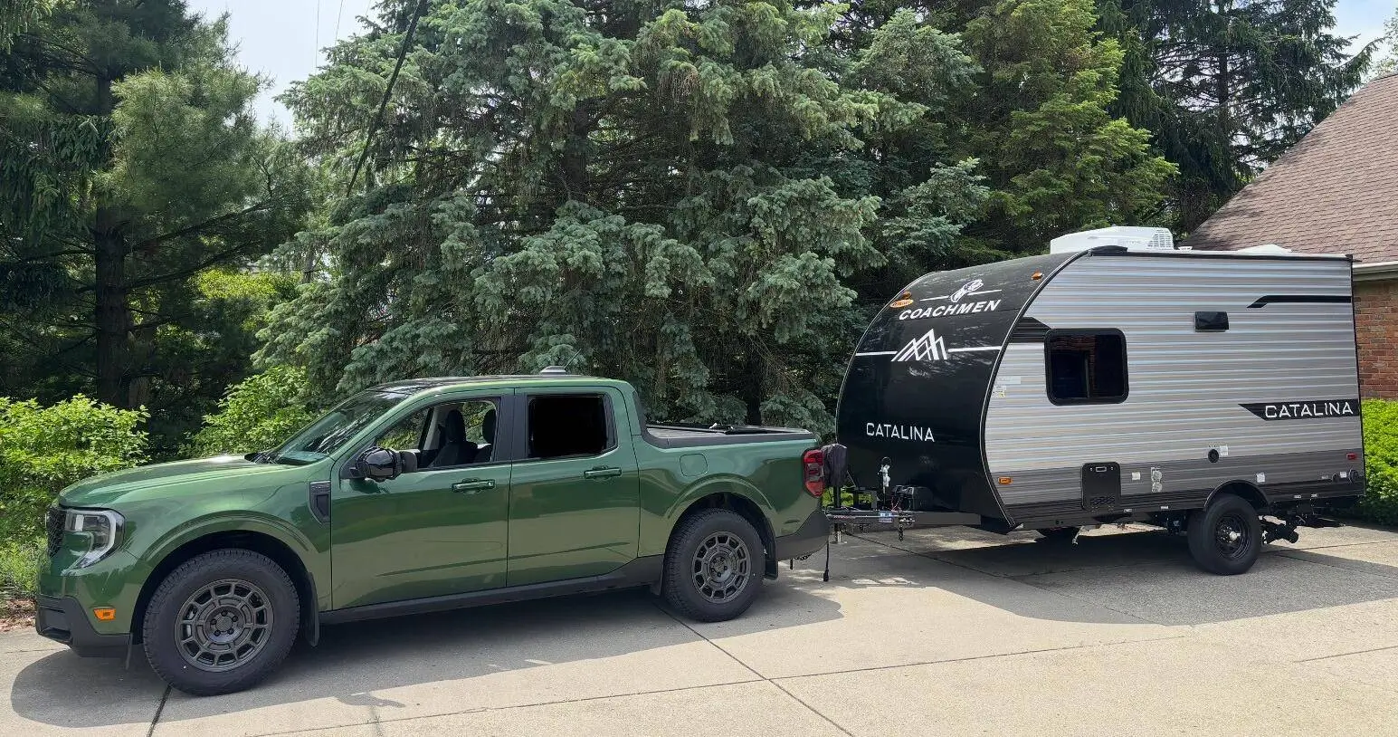

We purchased a Catalina 134BHX. I removed the propane tank and installed a lithium battery to keep the tongue weight below 400lbs. I am also using a Camco R3 WDH hitch (600 lb springs) which keeps the truck pretty much level. Towed great and we did about 2000 miles with it this year. My overall mpg was about 12 mpg, and towing speeds were usually between 65-70mph. Overall weight of the trailer was around 3400 lbs and had the truck bed filled up with a spare for the camper, cooler, grill, etc. I use a wireless camera on the back of the camper to see behind me while driving which is a must have.
