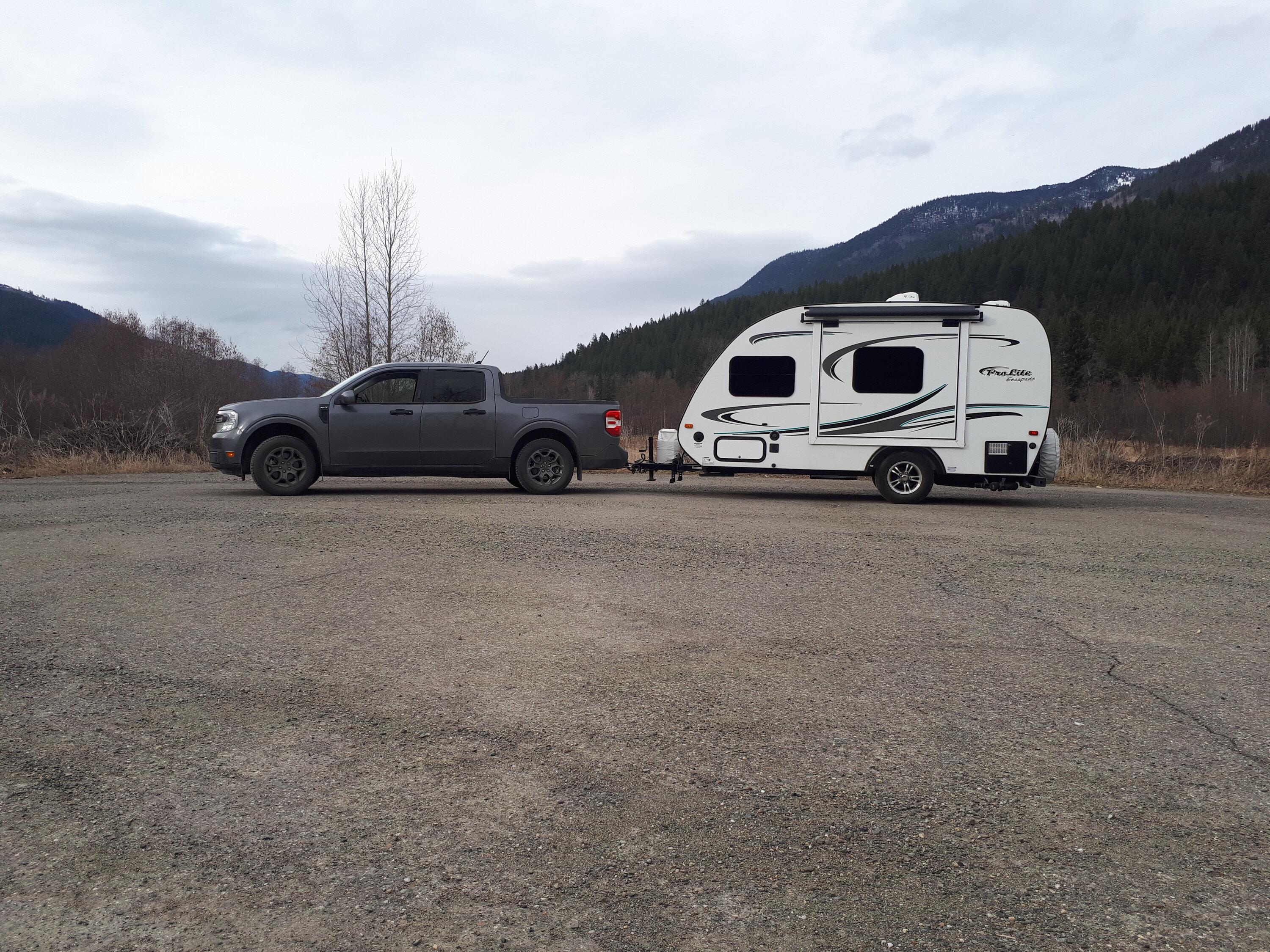

2700lb loaded, 300 on the tongue. pulls like a champ. haven't figured out the frontal area. cruising at 95kph over 300kms I averaged 11.2 l/100km.

Thank you for the reply. This is quite a trailer. I looked at the specs an it about 500 lbs lighter than mine with about a 50 square foot frontage (something like 6.6 x 7.1 ). I am hopeful that a few more members chime with their experiences.

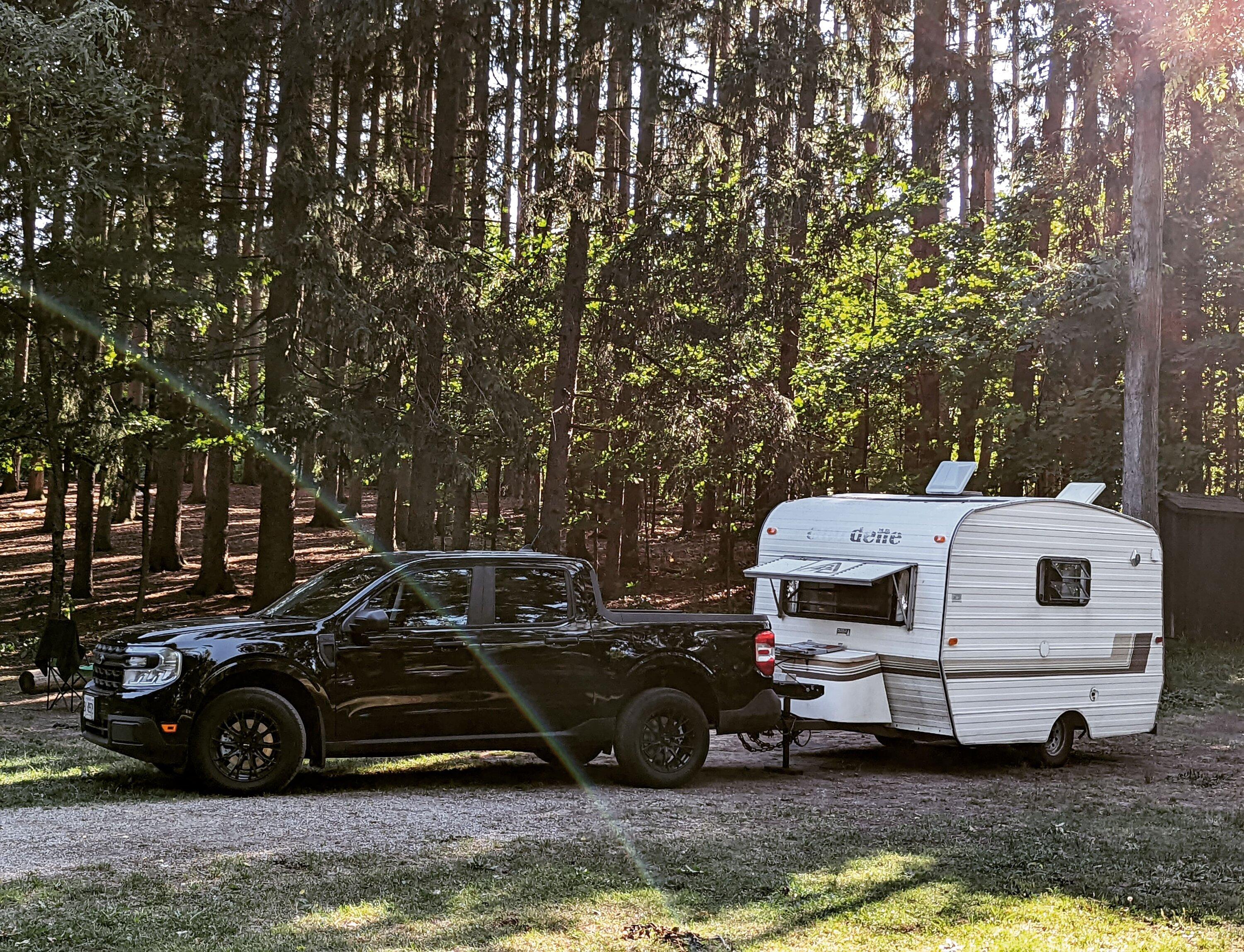

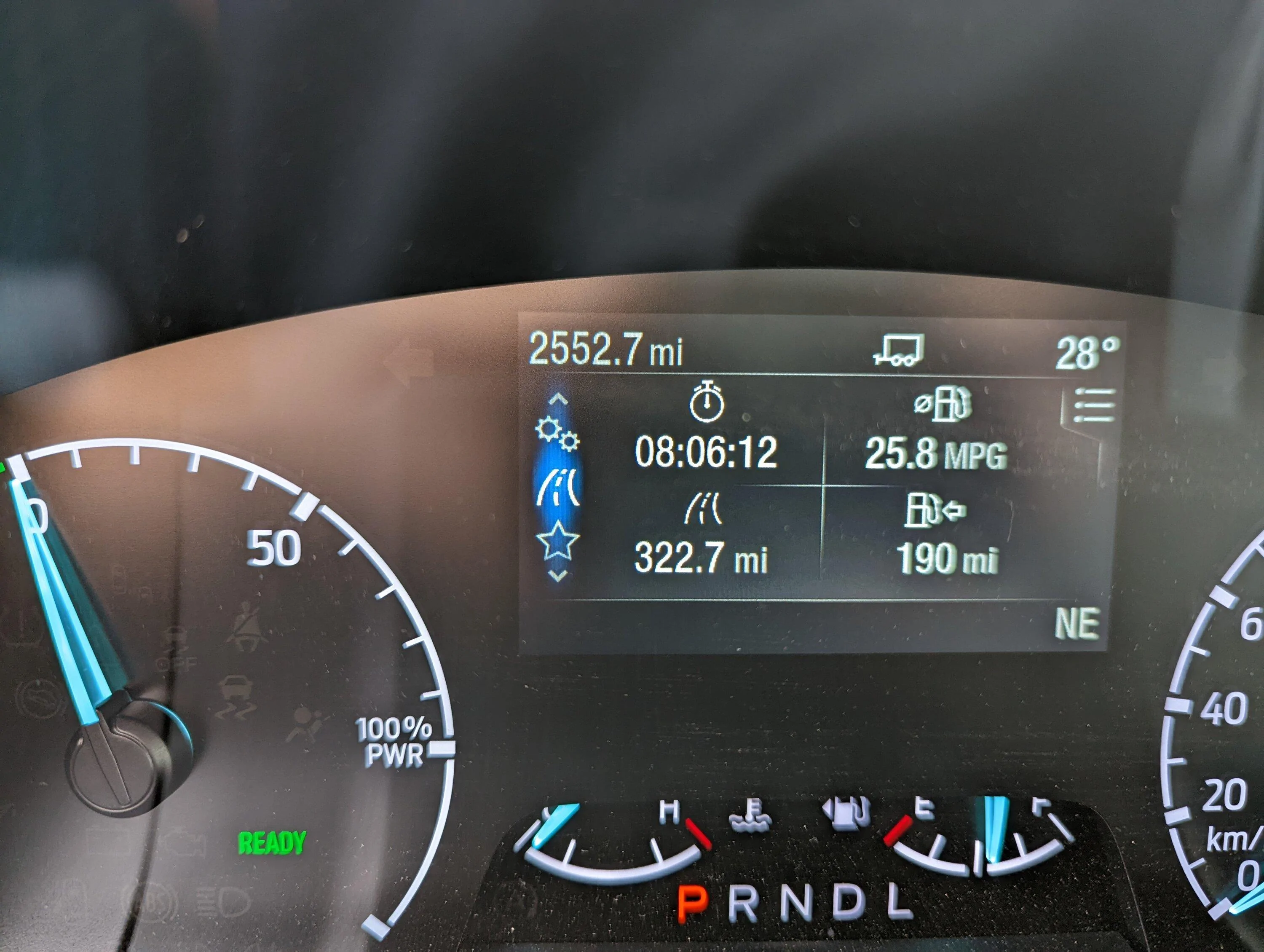

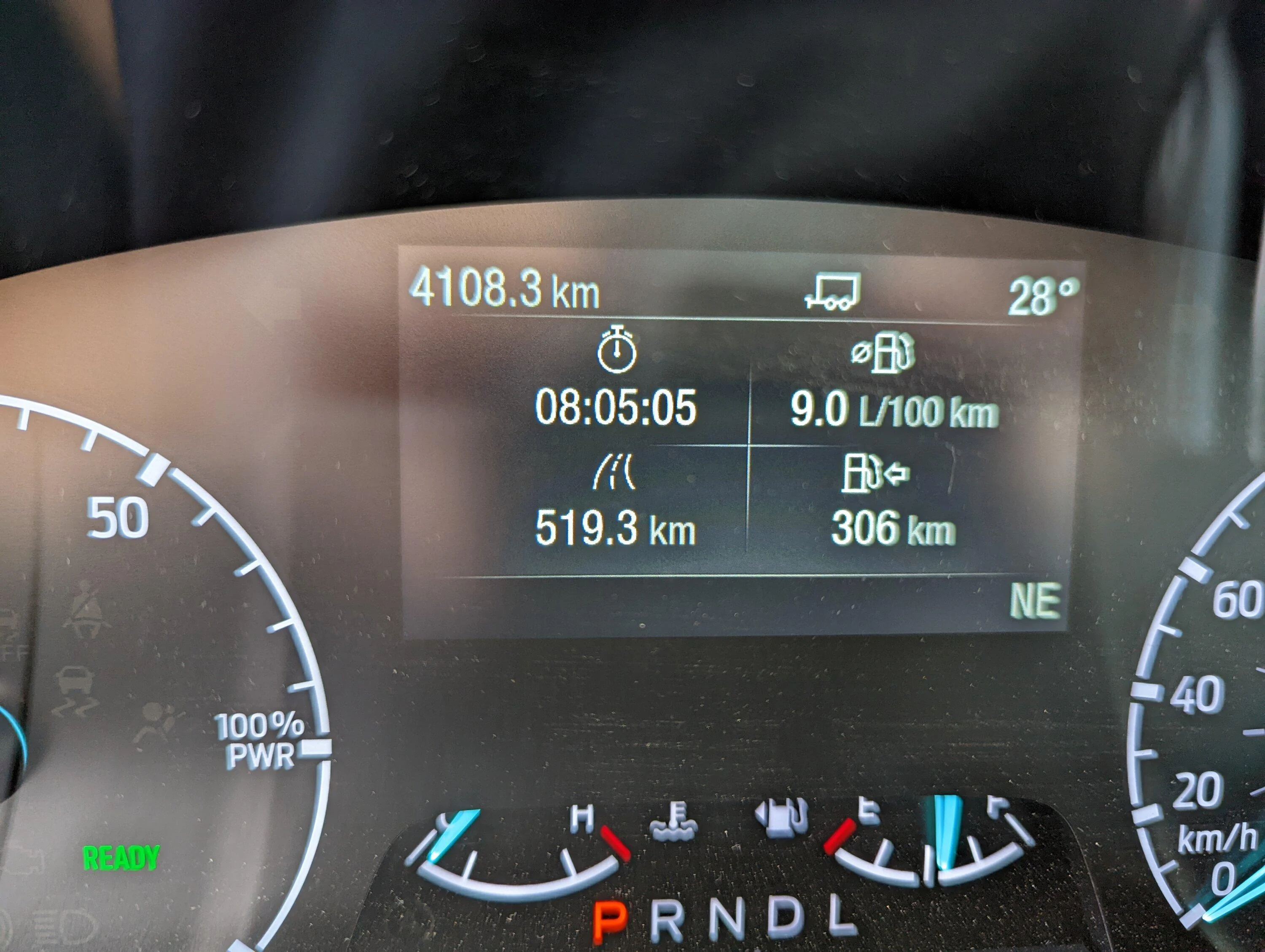

I have a 1500lb 1980 travel trailer, weighed everything at a cat scale. Tongue weight approximately 180 lbs. Frontal area square footage well beyond recommendations. Pulls great. Recently did a 320 mile trip at approximately 55 mph and averaged over 25 mpg with the hybrid.

this looks like a little sag on the back of the truck...weight distribution hitch? Seems like too much tongue weight to me, just from the picture. Water in the tank in the front of the trailer? If so, I would haul as empty in the front as possible, put all the cargo in the back half of the axle. Just my .02 from looking at a picture. I do have tens and tens of thousands of miles, towing campers, 5th wheels, etc.

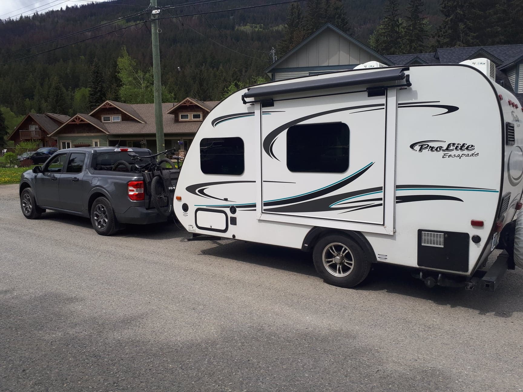

maybe an inch lower than normal on this particular as we went off grid with 2 bikes, 2 totes of firewood a full fresh water tank and 10gals of drinking water. she normally sits like so below, in this picture it has full water tank and 2 totes of firewood on board. I often balance it by putting water in the grey tank which is just behind the trailer axle.

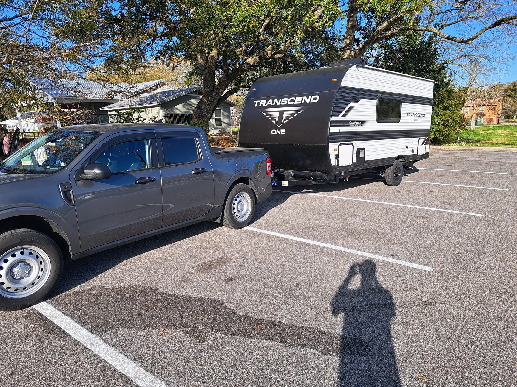

151BH and lots of gear.
13mpg at 55 to 60mph in eco.
11mpg at 60mph in tow mode.
I only pulled it once. Decided to buy a bigger truck 1 hour into the trip.
Got an F350 1 month later.
Edit...this trailer was too big for my 2k hybrid FWD.

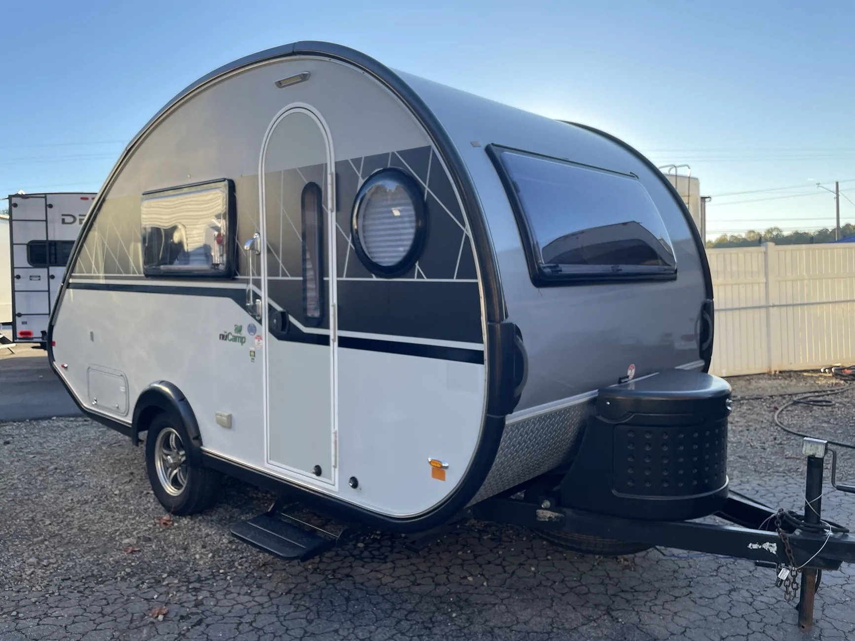

I have a 2018 T@B 400 that weighs approximately 2,750 lbs. . I haven't measured the tongue weight yet. My limited experience with my 2.0L engine in normal is about 16 mpg AT 60 MPH. My echo mileage w/o a trailer is 35-36 mpg. while I drive 18,000 per year and the trailer mileage is less than 2K I find my Maverick is just fine.
