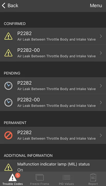

@jerrisn what DTC code or codes are present when you scan it with forscan or an obd2 scanner? If you're taking it to the dealer I would not clear the codes but you can definitely check them to see what they are.
I just read them and posted above.

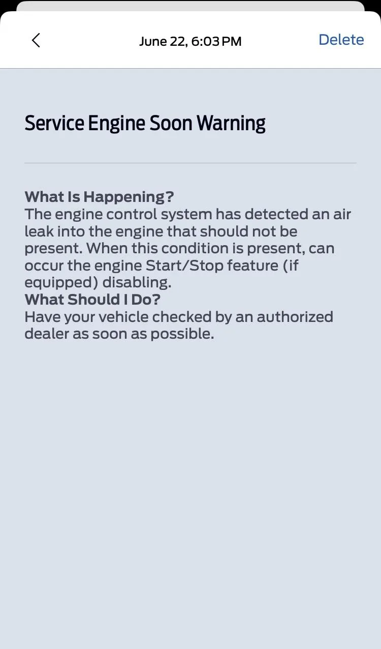

While driving my 2023 XLT hybrid on a road trip, I noticed a message from the FordPass app on my phone indicating a check engine alert. I checked the dashboard, and sure enough, the check engine light was on. I had just passed 20,000 miles earlier today, and the alert appeared around 20,200 miles. This is the first issue I've had since I bought it last June, not even a year ago. I'll have to wait until Monday to schedule a service appointment at the dealer. Is it safe to drive in the meantime? What has everyone else's experience been? I know this is a common issue.
*****UPDATE 6/23/2024*****
After reading the codes, this is the same error reported in the 23P18 CSP. Go figure.
