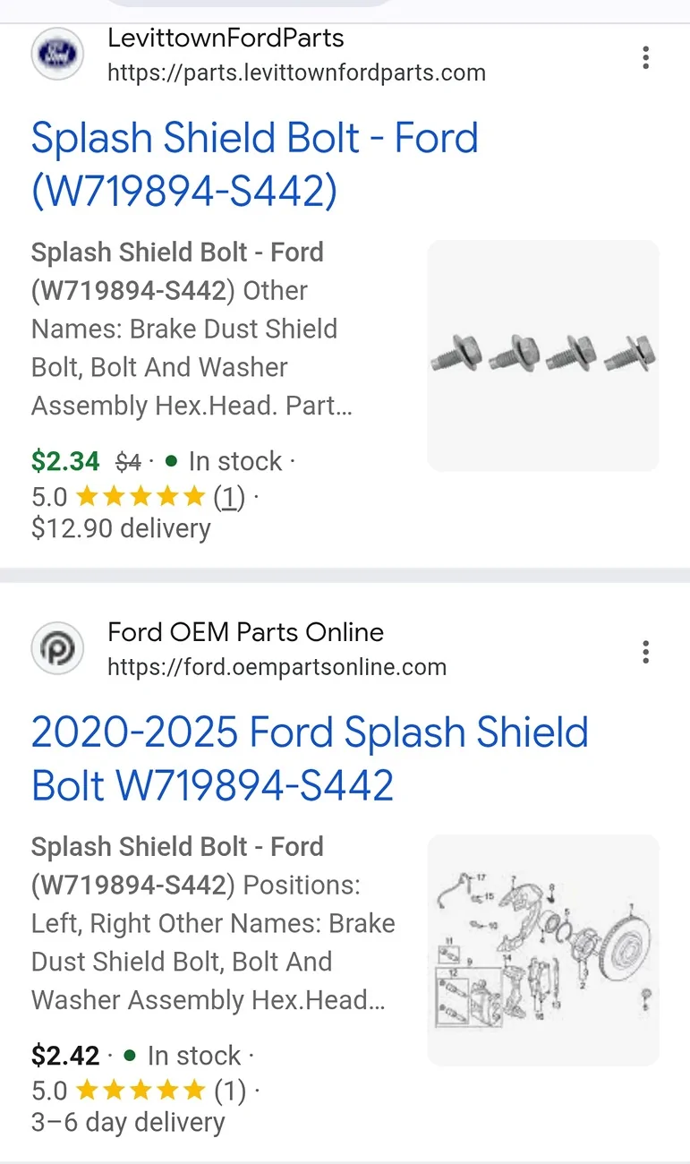

Had a service done on my 24 Maverick included in that Service was an oil change. Well what happened? I just want to change my oil now and I noticed there’s two of the T 30 screws holding up the shield are missing. I know I’ve seen it on here before anybody know the part number for those screws. Thank you.

This is what I did to my Tremor Skid plate hardware should be the same..
Hardware Specs: Ace Hardware
• Washers: M6-1.0 1 1/2" Stainless Steel Fender Washers (to prevent pull-through)
• Body Clips: M6-1.0 U-Nut/Body Clips
• Bolts: M6-1.0 (1.25" Length) Hex-head Body Bolts with attached washers

The only time I ever had missing bolts or stripped nuts on the splash shields on multiple ford’s, was when I had someone else do the work. It’s very easy to strip those tiny nuts if you use power tools and have a heavy trigger finger. I understand that there isn’t much profit in an oil change, but I think they should fix it. It’s probably easier and quicker to stock up on nuts and bols and check after every service.
If YOU reinstall...
I only HAND TIGHTEN my bolts..
TOO easy to strip-out Nut with a power tool... :unsure:
