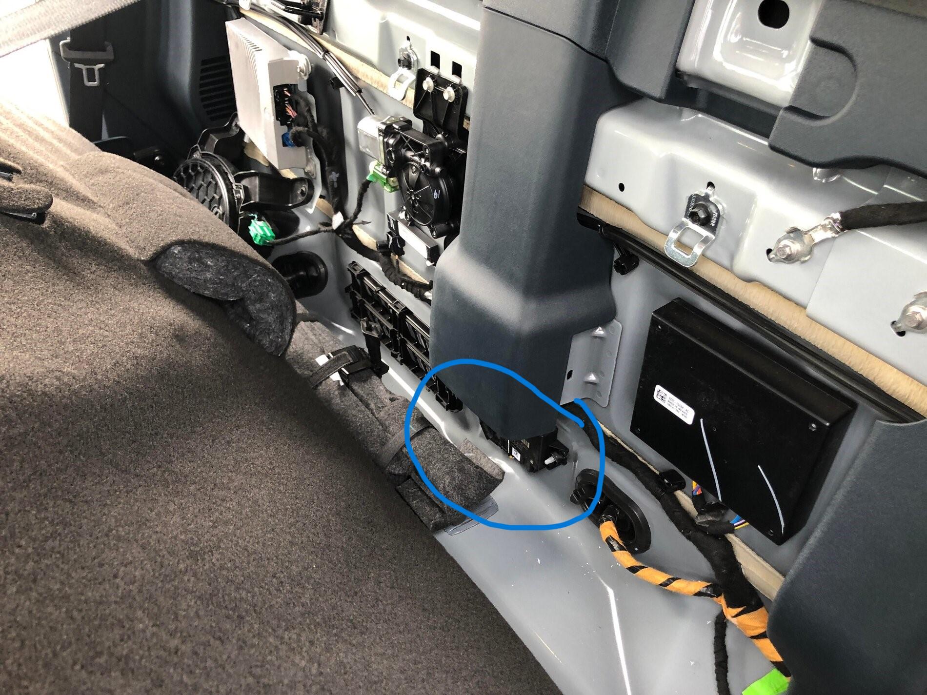

Hello Mavs! Felipe here form Chile, with a crazy project to add rear parking aid. I've found wiring diagrams and all needed parts and I think is possible.
But while parts come in, I need to request help if someone with the lariat luxur package can send me detailed pictures of the back of the rear seat. Down there is the parking aid module (PAM). *Look at the pictures below.
if possible please showcase the cables and connector(s), cable colors and used pins and much better if someone can unplugged.

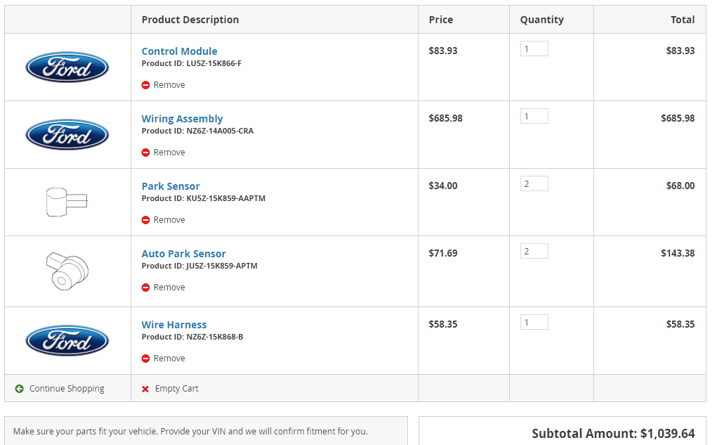

Just in case someone wants to follow me, these are the parts and where to find wiring diagrams:
If you still think is worth, these are the parts:
- NZ6Z-14A005-CRA full car wiring with the needed connectors for Latam Spec Lariat + rear parking.
- LU5Z-15K866-F Parking aid module (PAM).
- KU5Z-15K859-AAPTM x 2 rear center sensors.
- JU5Z-15K859-APTM x 2 rear side sensors.
- NZ6Z-15K868-B parking aid wiring harness

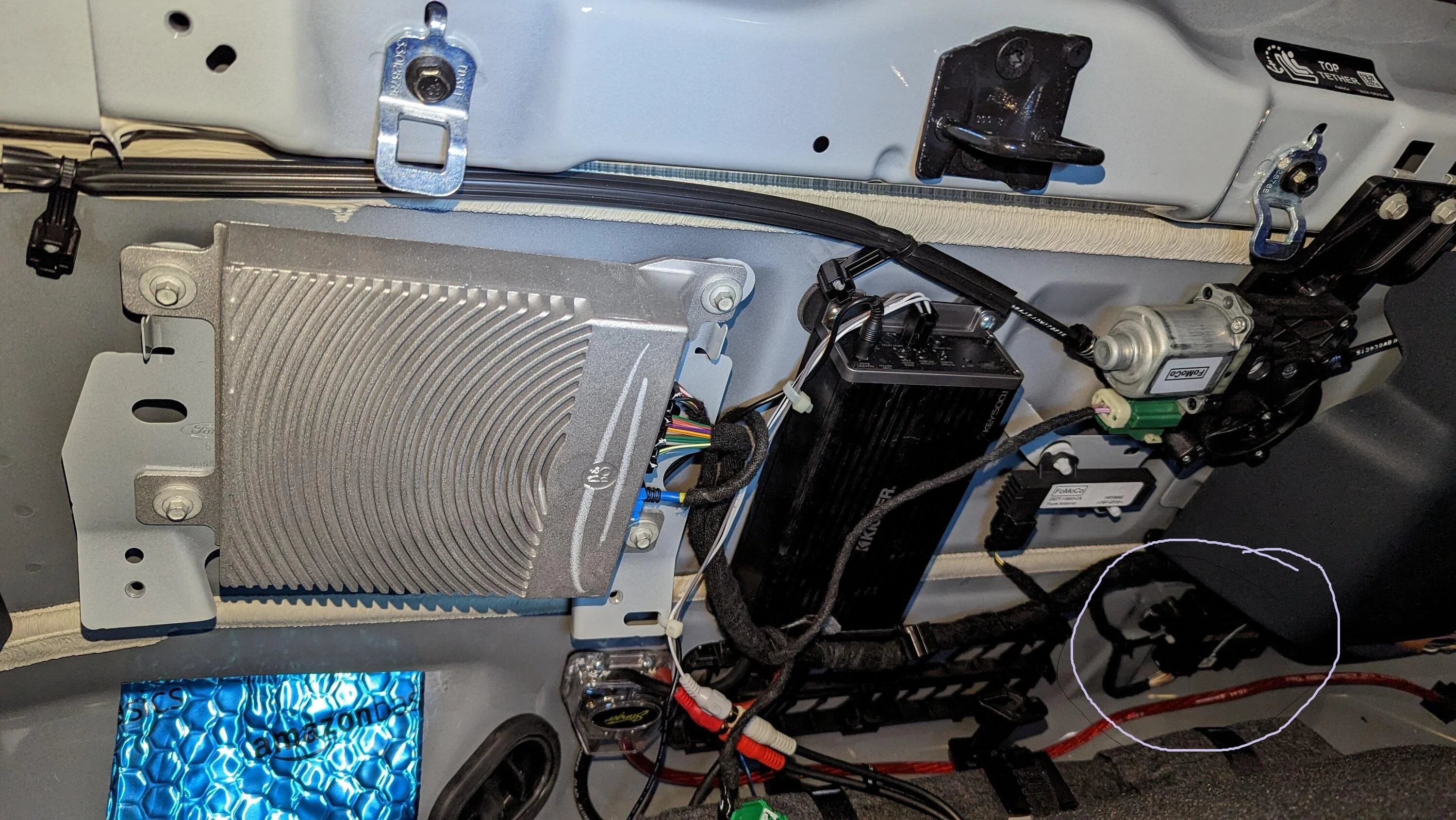

I would like to know as well. Family member has a Lariat with cross traffic, but no rear parking sensor. Would like to add OEM parking sensor.
