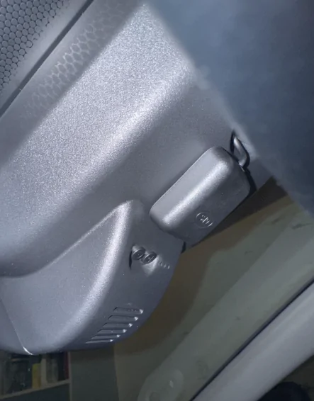

I installed the frt/bk camera - while the integration is nice, this unit runs hotter than an over. The heat coming from the shroud where the plug & play is, is beyond acceptable. The unit kept turning off and on, making me think that something is overheating. I changed the setting to 2K and do not live in the southern/western states. Sooner or later the heat will damage something, if not cause a fire. Definitely not worth the cost of my truck. I'm very dissatisfied and have contacted Mangoal. We'll see if they respond as quick as my initial fit inquiry.

Thanks for reaching out. We definitely want to help figure out what’s going on with your setup.
While dash cams run warm during high-res recording, getting excessively hot alongside constant rebooting usually comes down to a power connection issue or an SD card read/write error locking up the processor.
Could you try a quick test for us to help narrow it down?
  1. Pop the SD card out and power the camera on—does it still keep rebooting and getting hot without the card inserted?
  2. Are you using the included SD card, or a third-party one?
When you get a chance, shoot me a quick DM with your order number or email address so we can locate your support ticket and work through this with you.

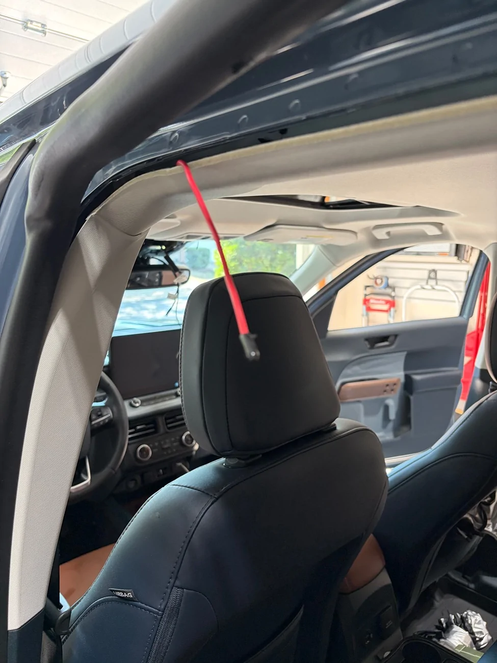

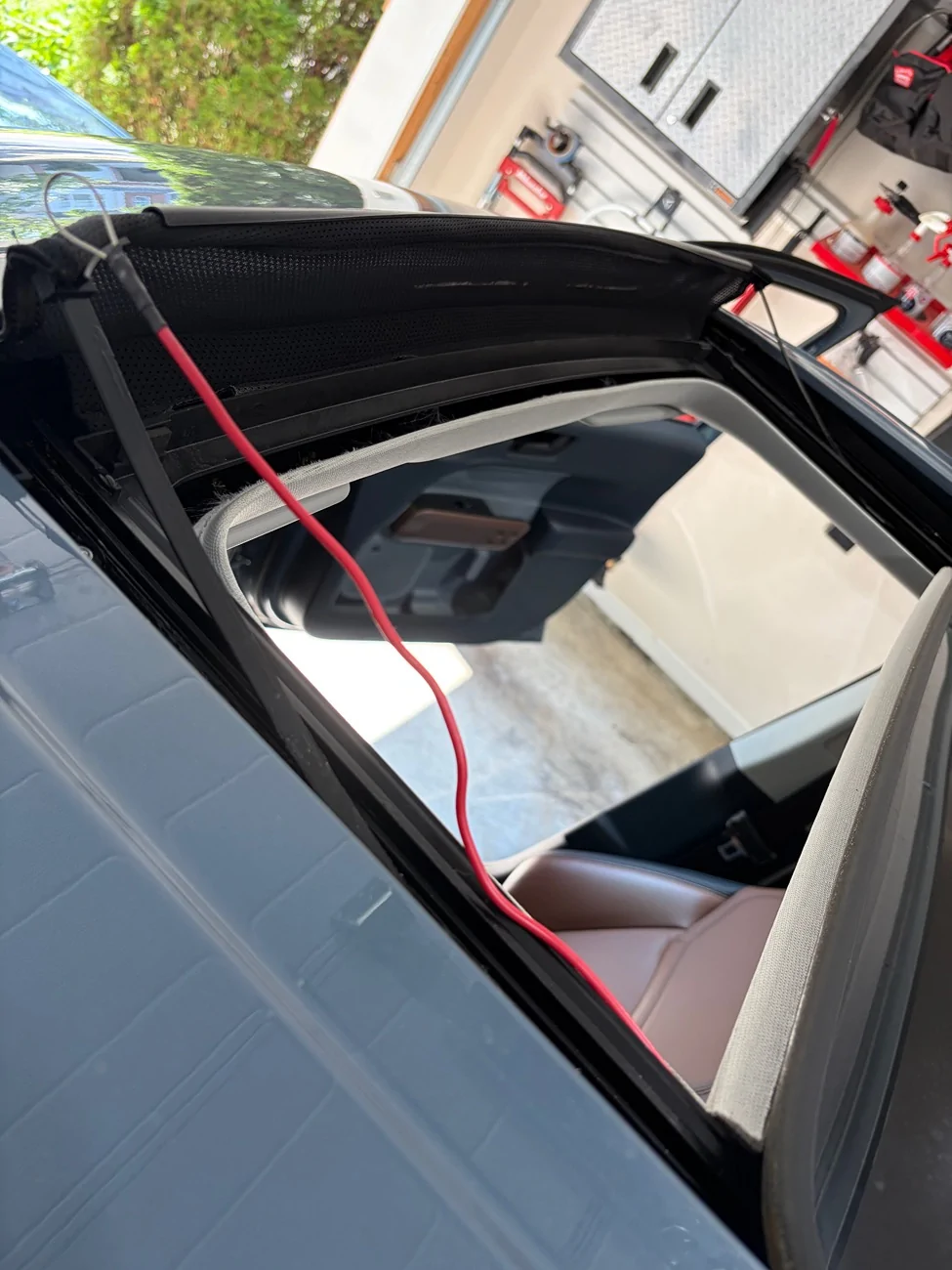

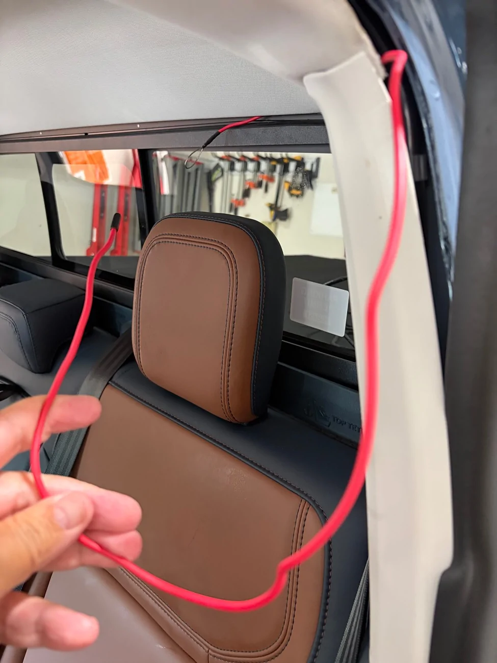

I thought about fishwiring, but pillar A & B were fairly simple. I ran mine at the top of pillar A driver side, then across top headliner to the top of pillar B and headliner to center. Just be cautious of the airbags.
If you do run throgh headliner - let me know bc I'd be interested in doing that. I have a sunroof though.
I have installed and I did run it through the head liner. But I did have to take the seal off the driver rear door in order to complete the work. Pics attached. Essentially I ran the cord from the back cab window to the rear driver door. Then I use a second fish and ran it from the side of the sunroof back to the rear driver door and grabbed the rear camera cable from there then pulled it to the sunroof. Then I used one of my two fishes get from the sunroof to the mirror and I pulled the rear camera cable the rest of the way up to there. Took me a little bit I was able to do it. I then tucked the camera cable under and past the airbag that was running along the rear door. That allowed me to then pull on each end of the camera cable to get it all pulled over further away from the airbags and more in line with the driver side edge of the sunroof. I tickled all of the excess cable between the edge of the sunroof and the driver side front door.
