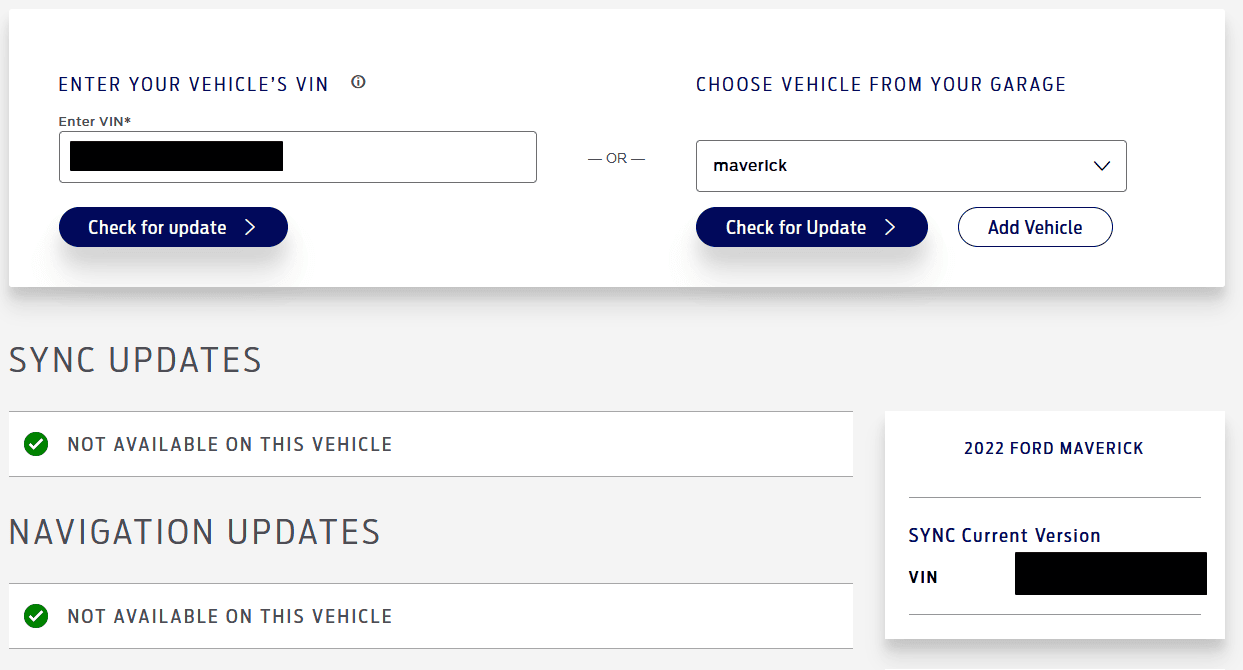

I get this after entering my VIN (blacked out)

Hum, I don't know an answer. Does yours have the Lux Pkg? Not sure if that makes a difference or not

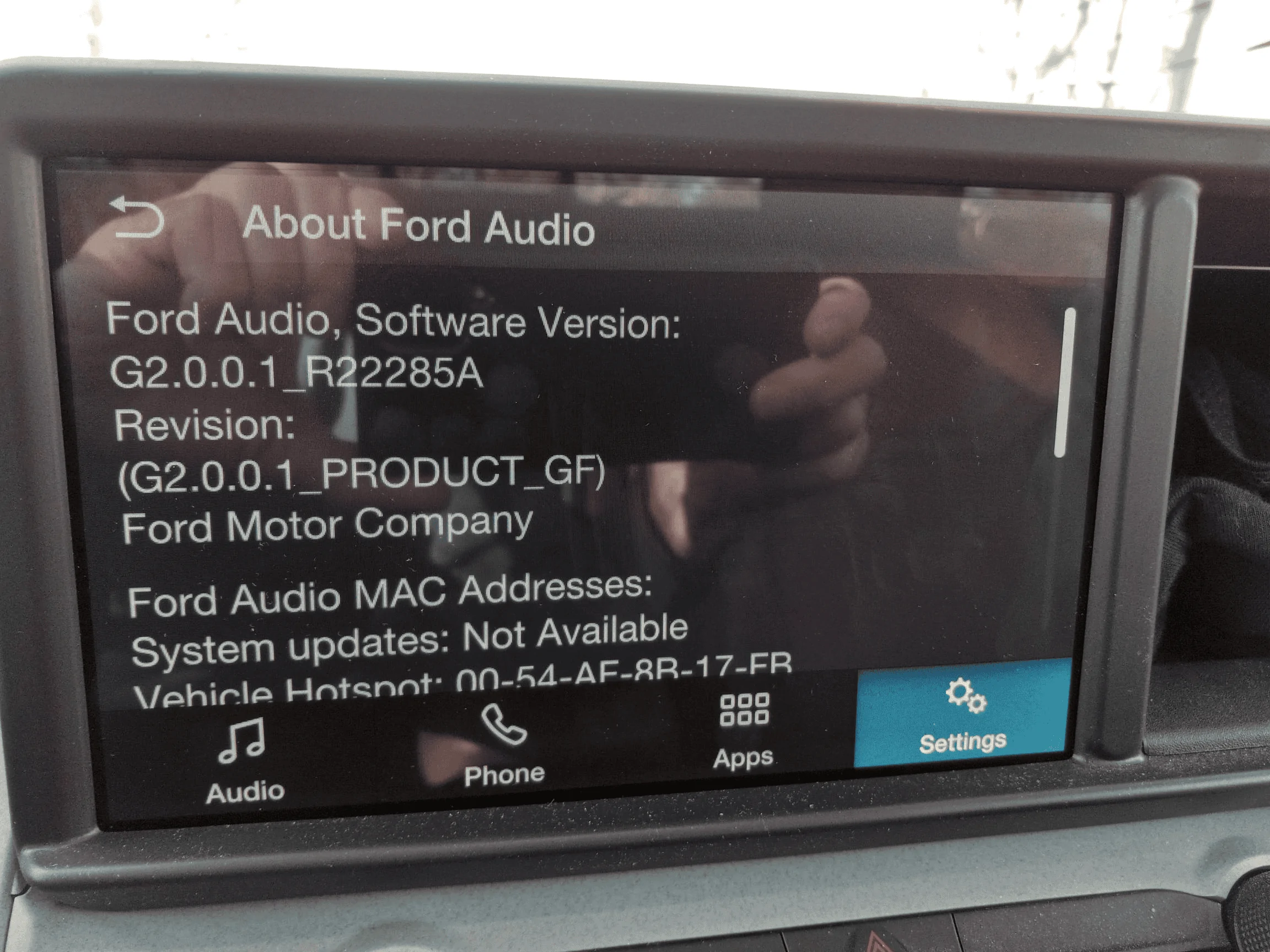

Thanks everyone for the suggestions. I did the WiFi update and it went pretty smooth. Download took about 10 min and the install about 5. I stayed in the vehicle to watch the process. As stated elsewhere the update was not recognized right away. I did it yesterday and checked this morning and it had changed and a voice message said the update was complete. Here is my update
