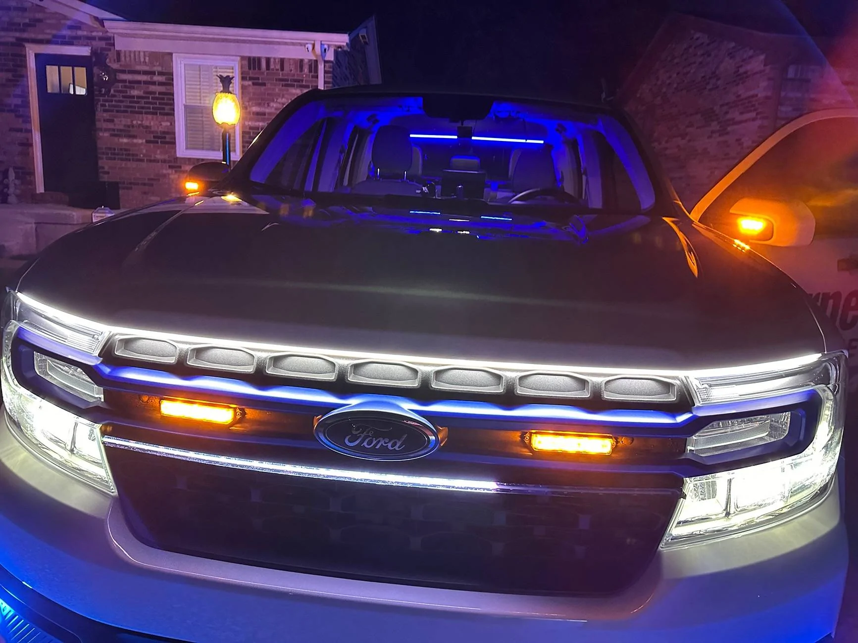

Installed the one with turn signal and white light as a DRL. The strip was stuck to the hood for a better look. Ran the wires thru the hood down to the hinge. It is cuttable and adjustable thru a simple interface , same for how long you want the turn signals to go.
https://a.co/d/0KkQGLu
the strip that is scanning is not it, that’s a custom deal I made from addresssable led

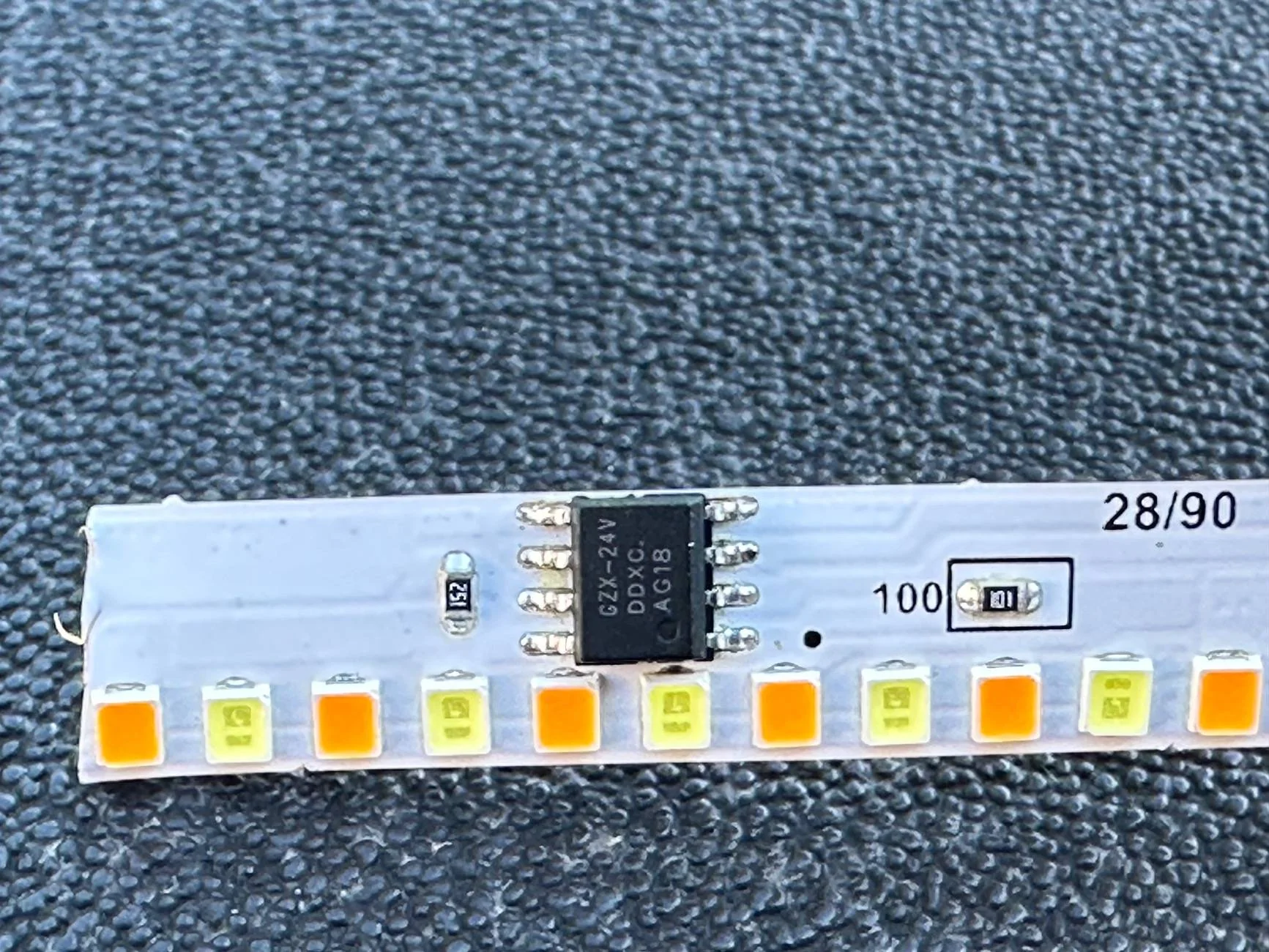

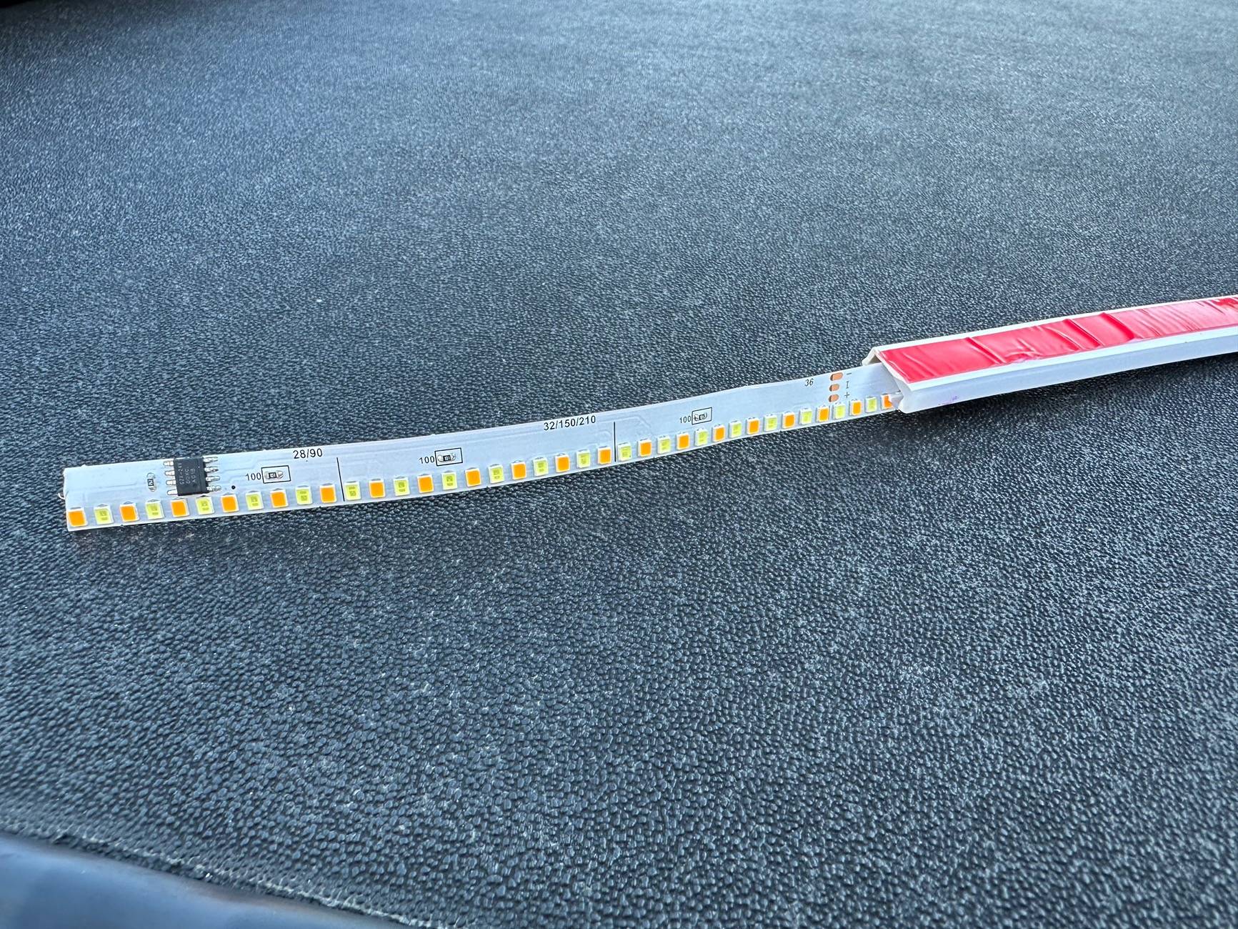

Hello. Thatnk for the reply. I plan to install it above the lights from end to end. Its 59" so I dont need to cut it. The LED comes with adhesive on the top and the bottom with a red removable liner. Obviously only one side needs adhesive. So on the other side that adhesive needs to be removed to prevent it fron sting to the hood...Right?? How do you remove the adhesive to prevent this? Am I making sense?

You could leave the red tape on to prevent it from sticking or goo-gone

As for the tape on the unmounted side, I found I could peel it off with some effort and patience, leaving the bare white strip which helps with the brightness of the strip vs covering it with electrical tape. I tried heating and cooling the tape while peeling it off but found that what made the most difference was the speed and angle that I pulled on it. This was in 80 degree weather, your mileage may vary.
