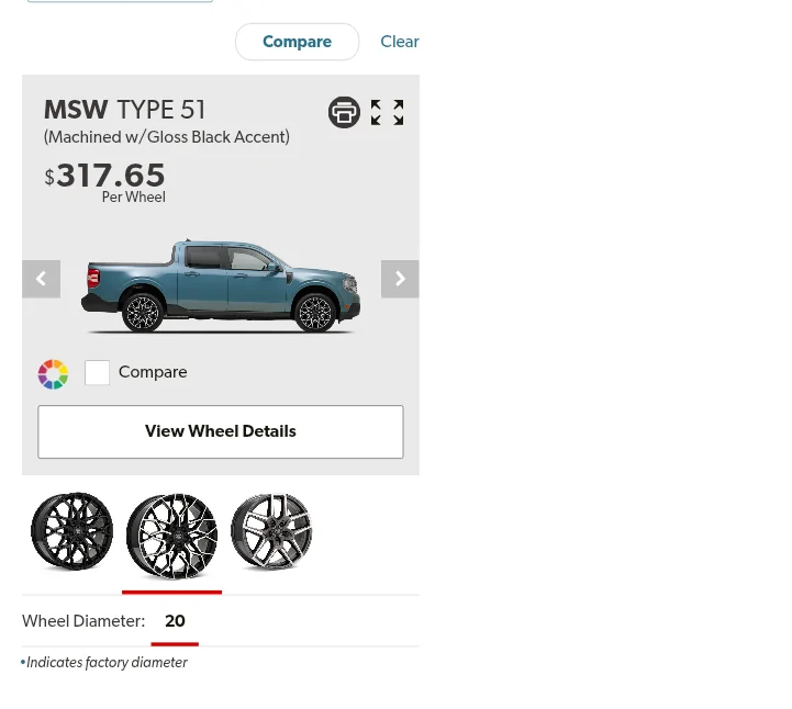

I checked Canada wheels, their site has about 30 choices of 20inch and 8 or 9 choices of 22 inch wheels.
