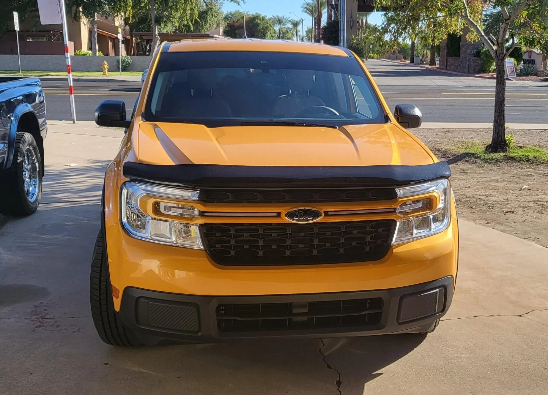

I just installed drl & turn signal lights on my Maverick. I used the wires that this guy suggested for each. I did use a different ground to do the install. I hope this helps 🤟
Also, Welcome to the forum!
Ford Maverick Grill Accent Lights and DRL's 20231028_152022_resized_1
