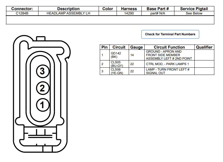

yup that's what I think happened, Ive had it for a while as I put one on my old car. just ordered the 59 inch one. did you wire direct to marker lights? I was hoping to wire to run it when the DRLs are on and not by turning on the headlights.

Yup wired it to #2 that way it would only turn on when I unlocked the car or the headlights were on

ok thanks I think I want to wire it so the bar is on when I'm driving win the daytime with the DRLs on.... I think I know which wire to tap into just trying to confirm.

crap I'm reading there may be an issue tapping into the drl wiring that can cause the bar to stop working after like 15 minutes or the headlights to stop. Ill just wire it into the side marker like you did....
