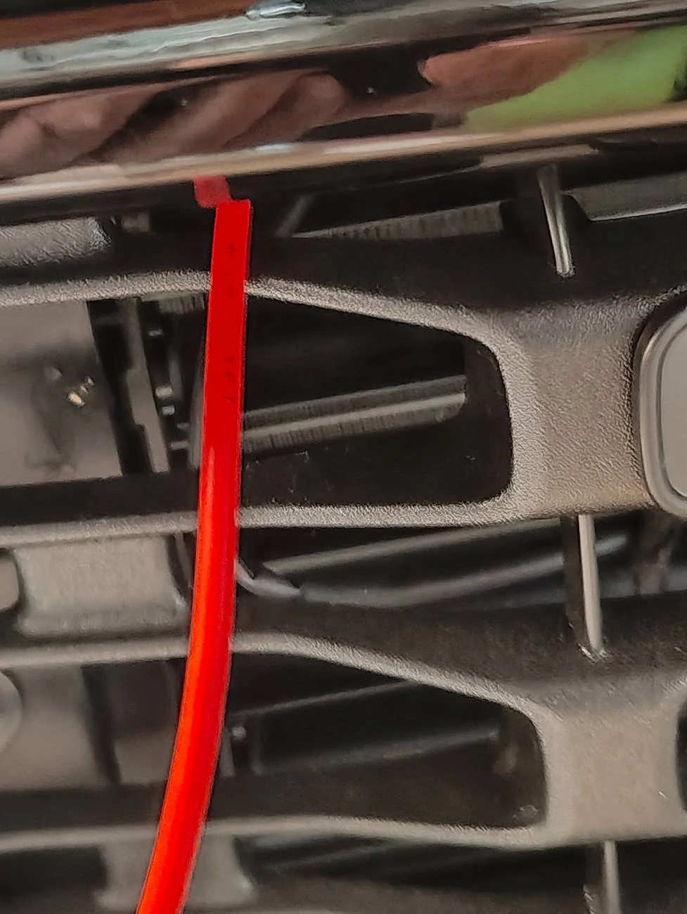

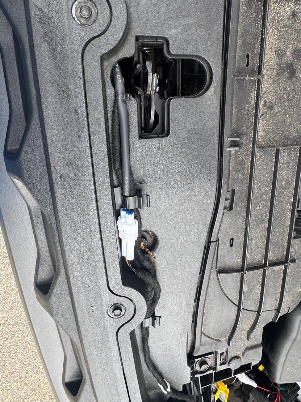

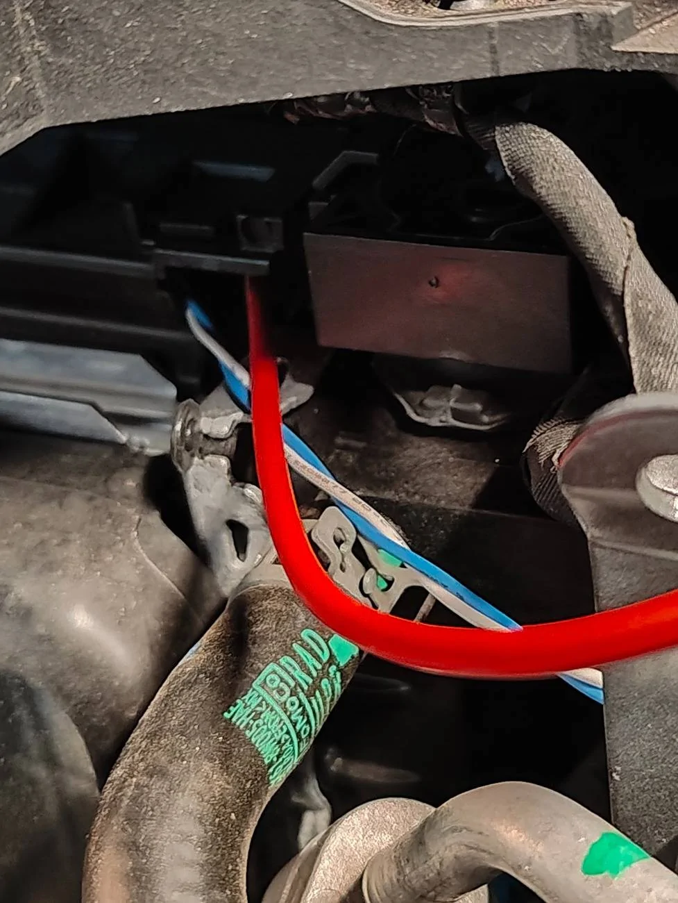

Did you go through the hood latch hole I didn't I found a new way to route it without going through that.
I am think about installing these on my 24 XL, I can not tell if the wire coming off the light are marked positive, and negative? I will be cutting the connectors, and wiring directly to the side maker light, but am hung up on the wiring on the lights. Any insight would be appreciated. Thanks Dan

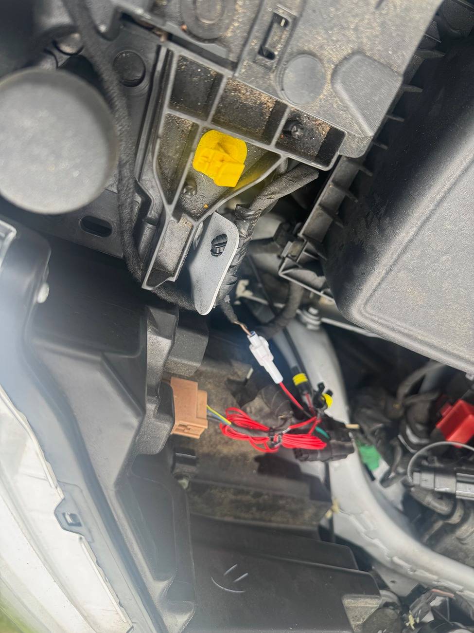

xipoqix 3PCS LED Front Grille Lights with this kit, no cutting of wires at all, all plug and play-so far all working well including the side marker lights. I'm very pleased so far.

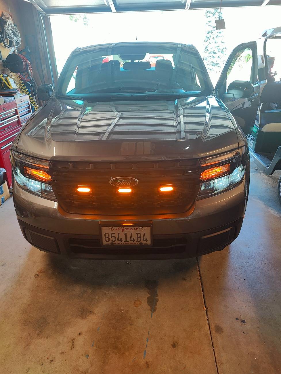

Would look nice on the top row...Raptor style.

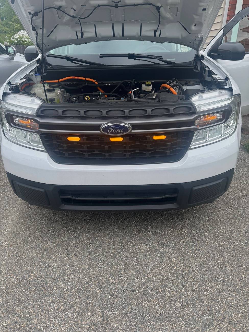

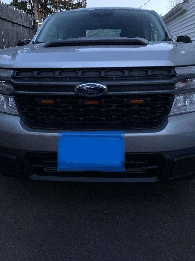

I thought I was buying Mabett grill lights on Amazon.
I watched the install video. Still thinking it was Mabett- as it turned out it wasn't.
I purchased these.
All seems identical to Mabett including the videos.
So, the install was quick and easy and the lights function as advertised.
I emailed wanting to know what the bundle with 2 red wires and plugs were for
on the adapter-turns out they are for the side marker lights, as they responded to my email.
So I ordered those also and will see how they work. Sorry Mabett,-I'm surprised that these two sellers seem to be the same.
Will keep you updated.
Has anyone else seen this?

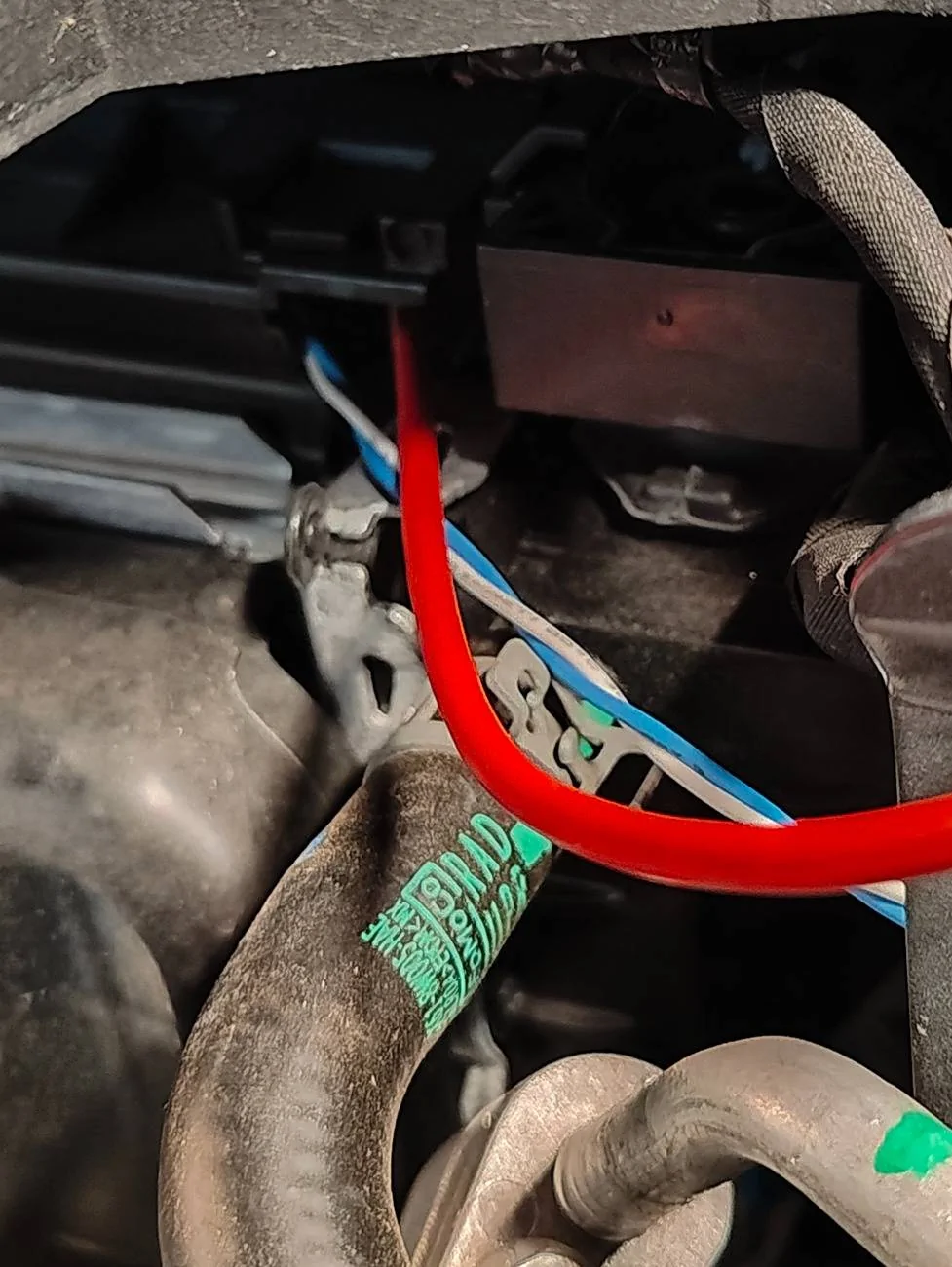

Yes, just take your time when securing the wires with zip ties. All plug and play, no cutting. I was surprised at the easy install. How long they will last, I don't know, but the price really is reasonable.
