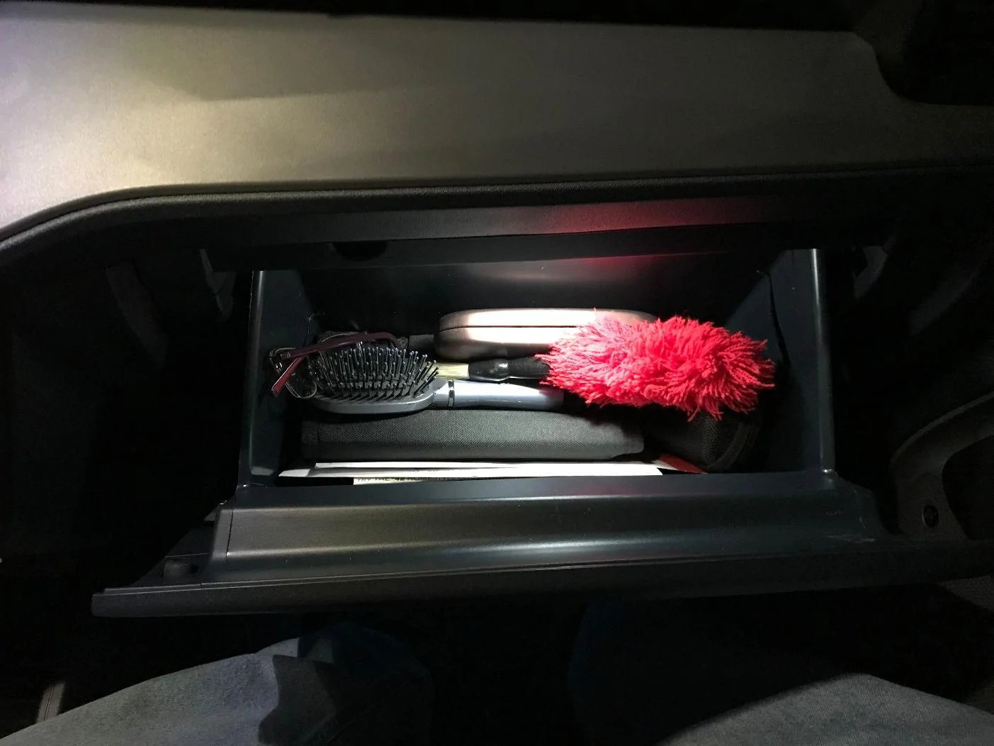

I'm with you on the disappointment of not having a glove box light for the Maverick. I decided to mount a small (about the same size as yours) rechargeable LED with touch on/off switch. I applaud you for moving ahead and doing this mod and for posting the how-to's. Here's the light I used for those who aren't so inclined to do the same undertaking as you.
PS: Nice job!
https://www.amazon.com/gp/product/B0B6HZ4X2Y/ref=ppx_yo_dt_b_search_asin_title?ie=UTF8&psc=1
Same ones, but cheaper at $10 for 4
https://a.co/d/0hVcONGg

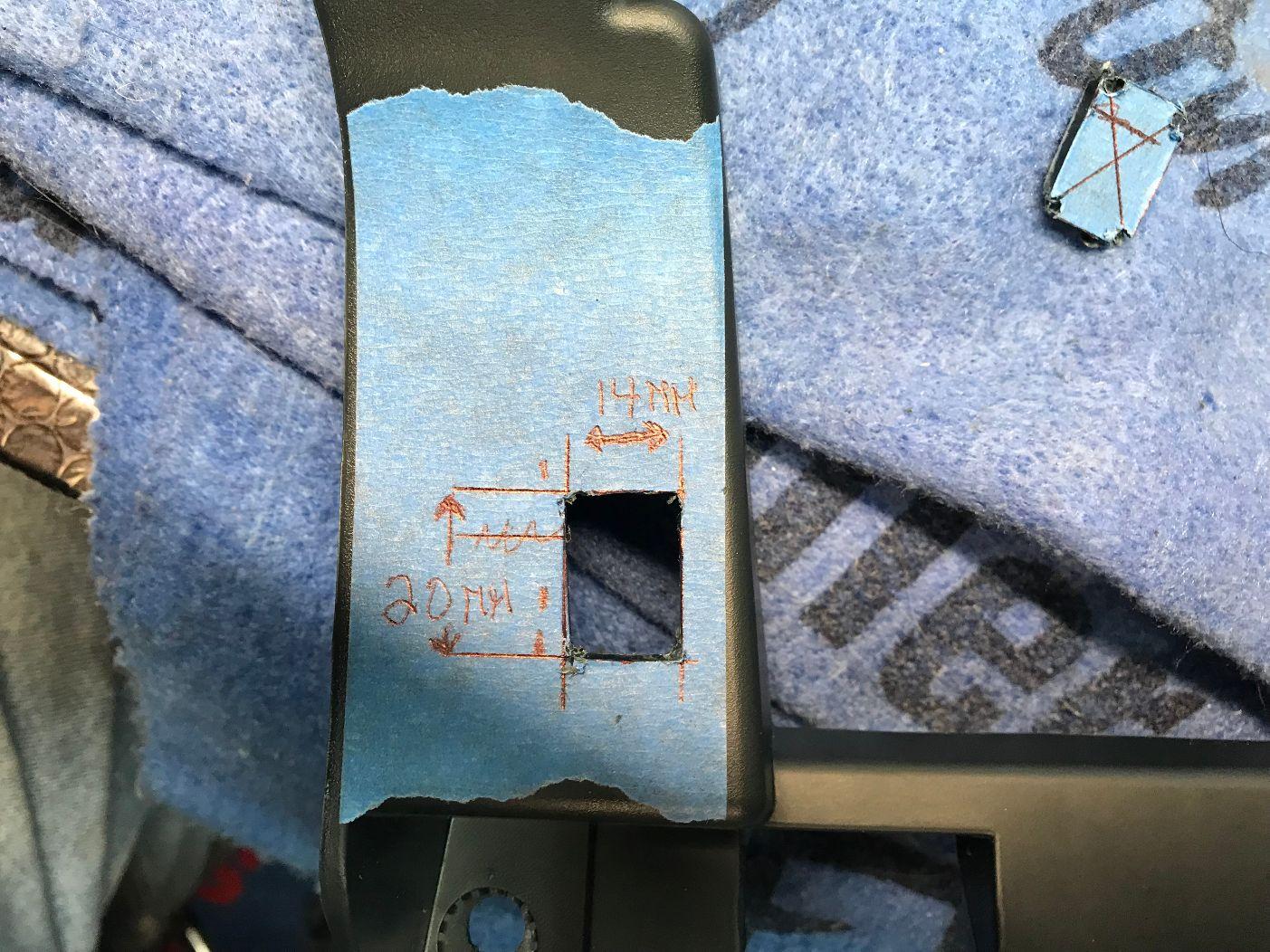

Thanks guys it was a fun little project now on to the rest of the truck.........

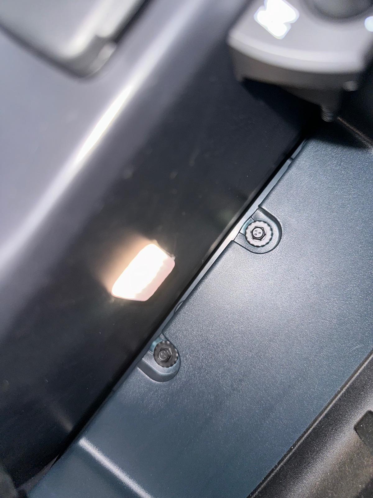

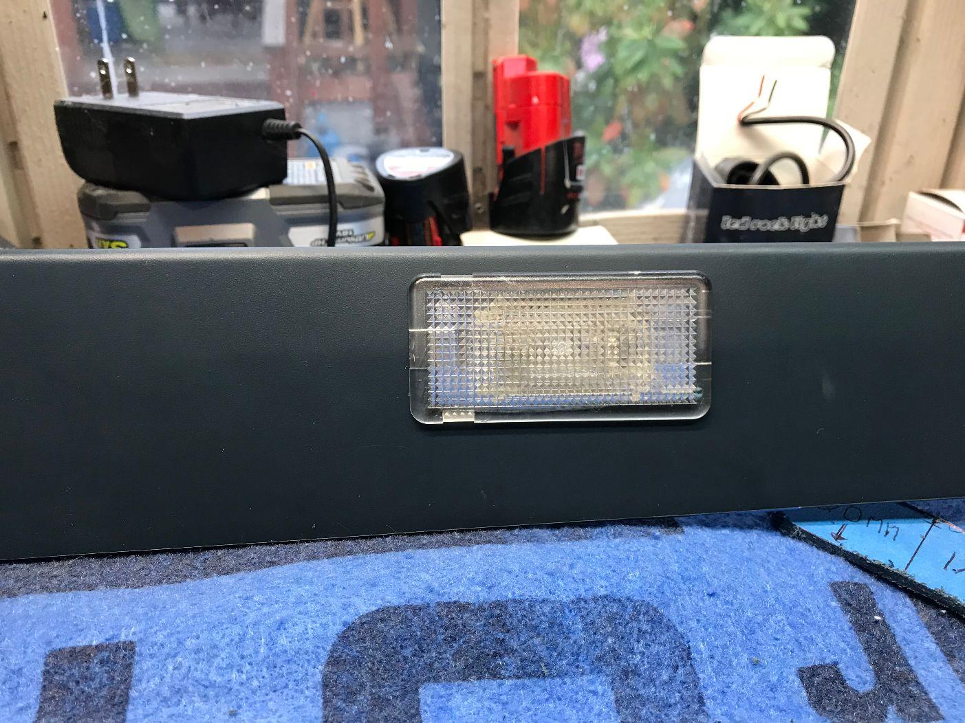

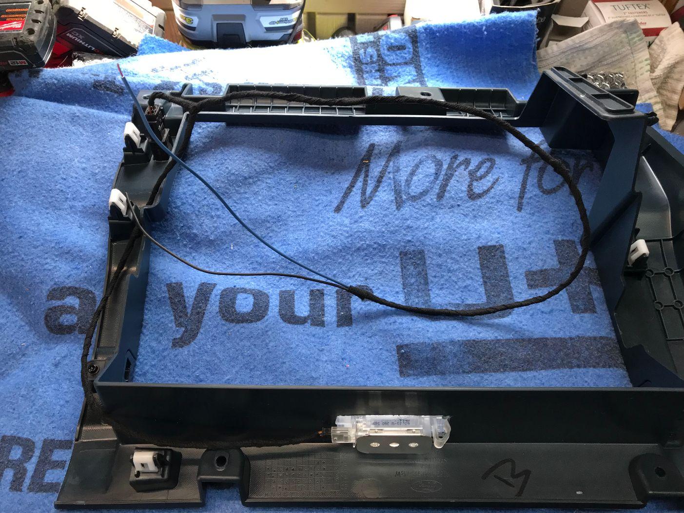

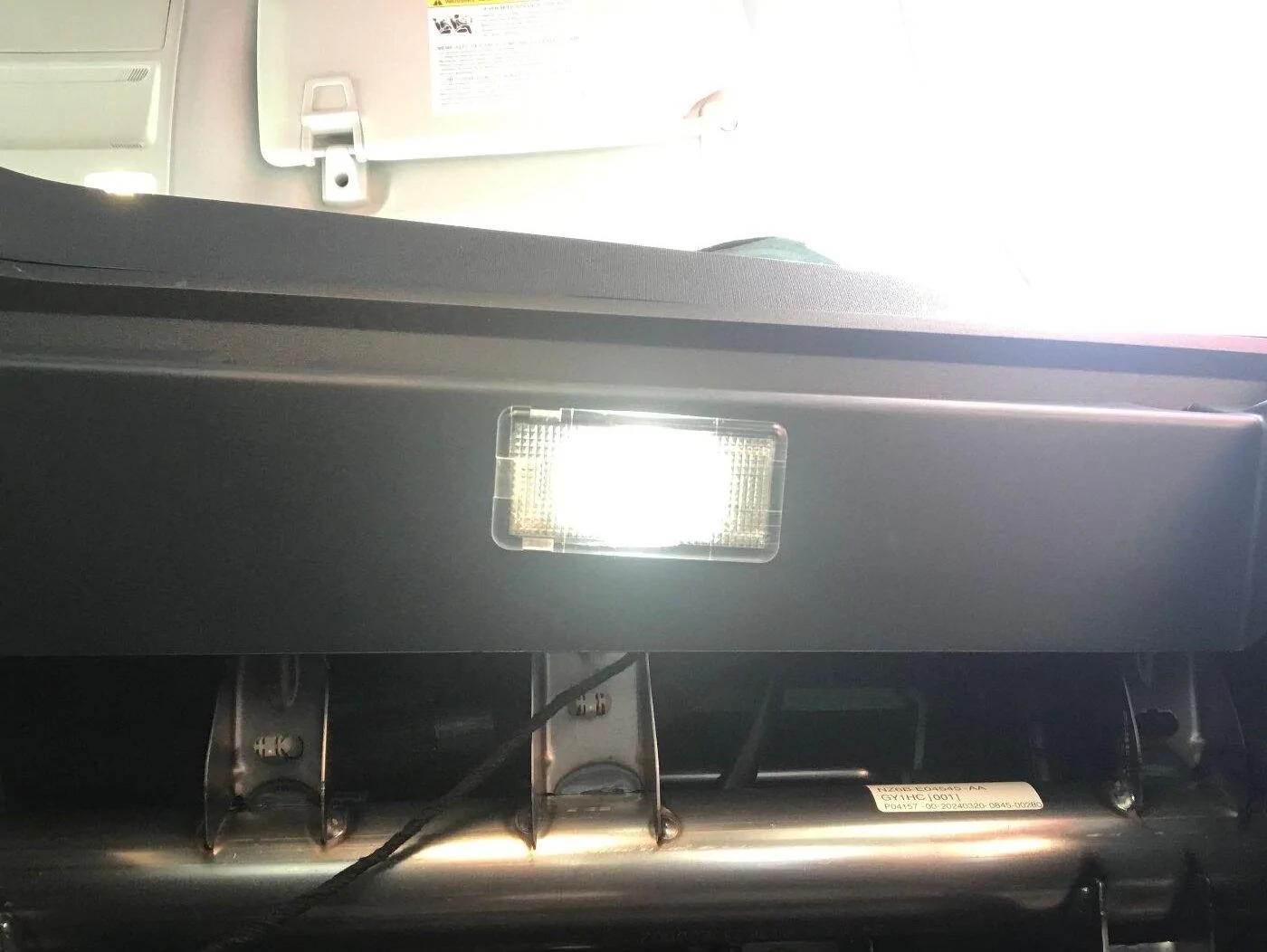

Looks good that's a very useful mod.

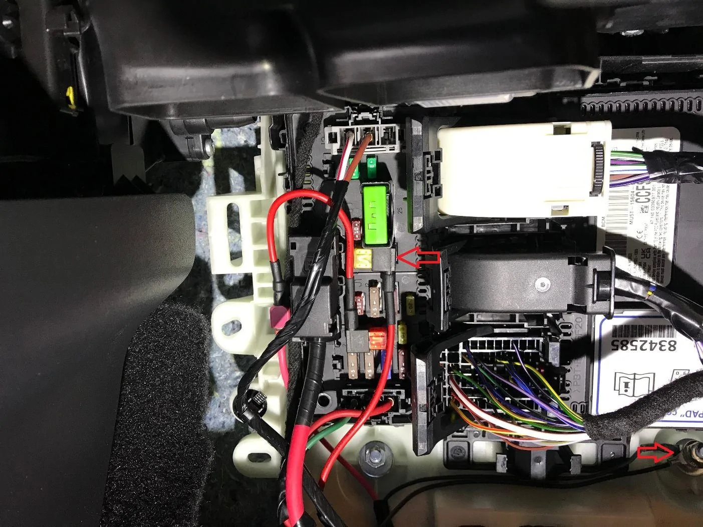

Yes and where it is wired in at lets you change the brightness of the light along with the cluster brightness + / - dial. I think lariat's come with an ambient light in a similar spot from the factory.

So do I. I like have both hands free. so I prefer a mounted light.
I think most all of of us keep a flashlight in our trucks/cars etc…
In my choice the light is more for my wife as shes usealy riding shotgun and its much simpler to just open the glove box and the light comes on instead of fumbling for the flashlight in the glove box tooling down the highway…..
