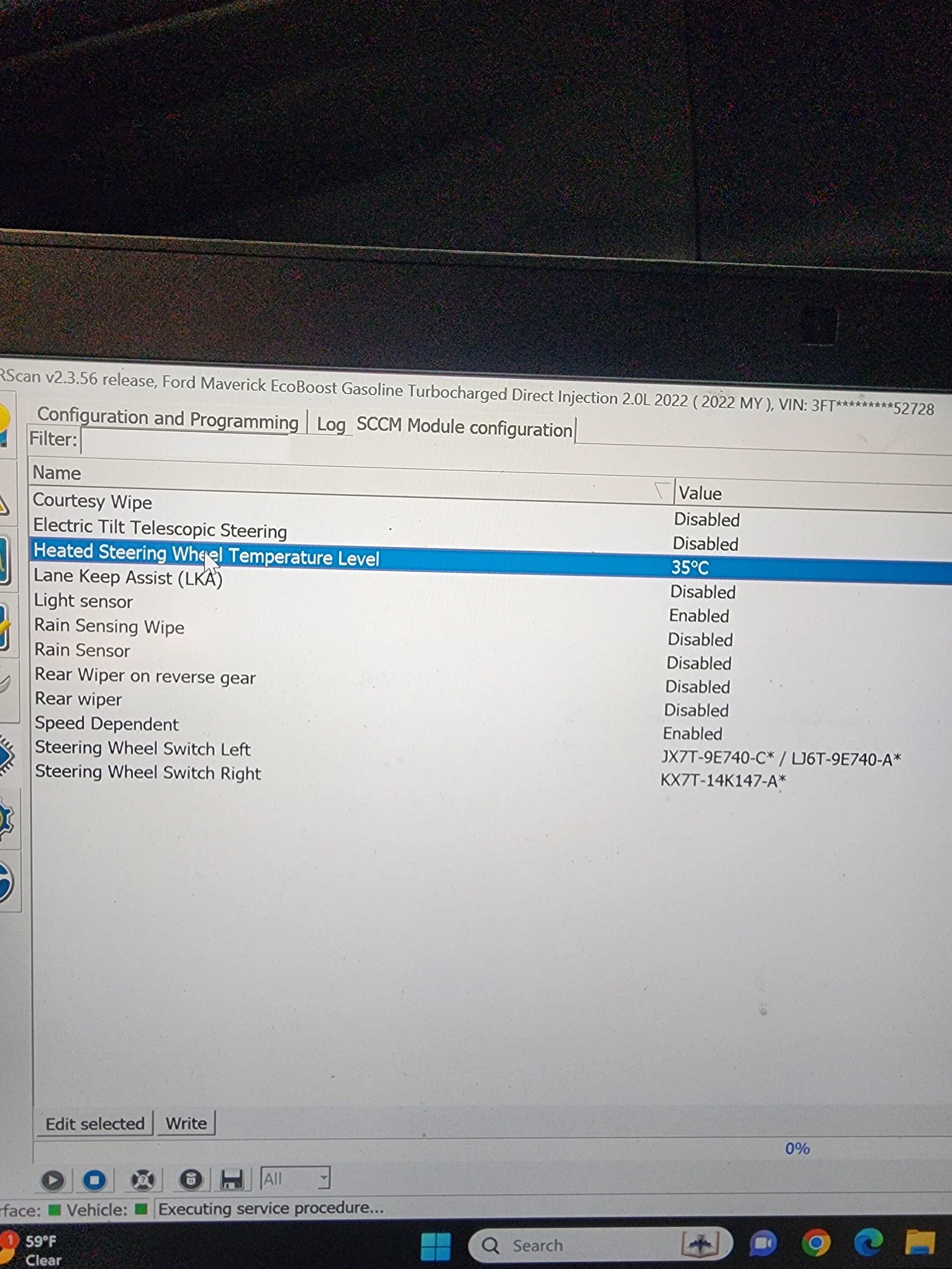

yes its a new module so it needs to be written againhmmm ok
So I have to input the serials from the switches (left and right) even though they were working before the steering control module swap?
