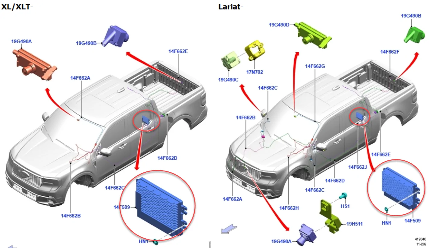

On 25-26, the LKA connector moved to behind the rear seat and changed size/type from what 22-24 had.
25-26 IPMA is circled. That's where the connectors are now.

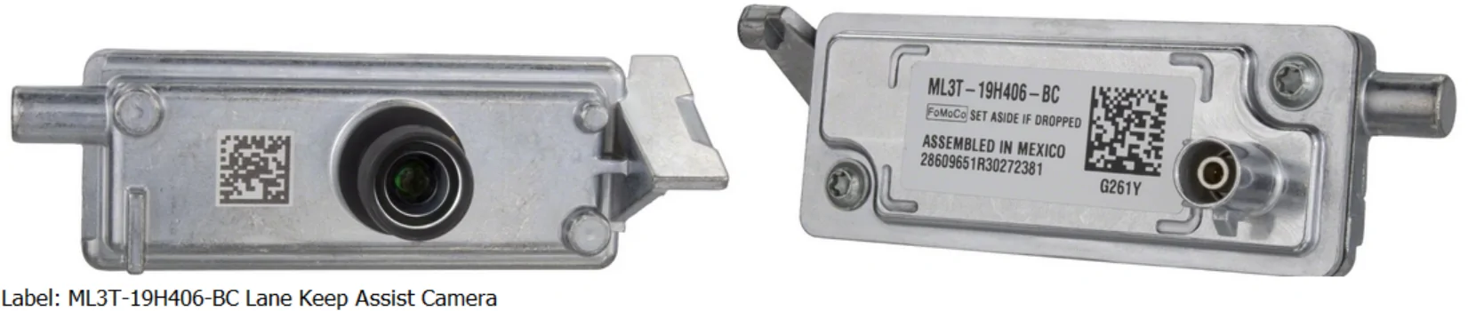

LKA/Forward Collision camera just has coax connector for feeding into the IPMA module on 25-26 Mavericks.

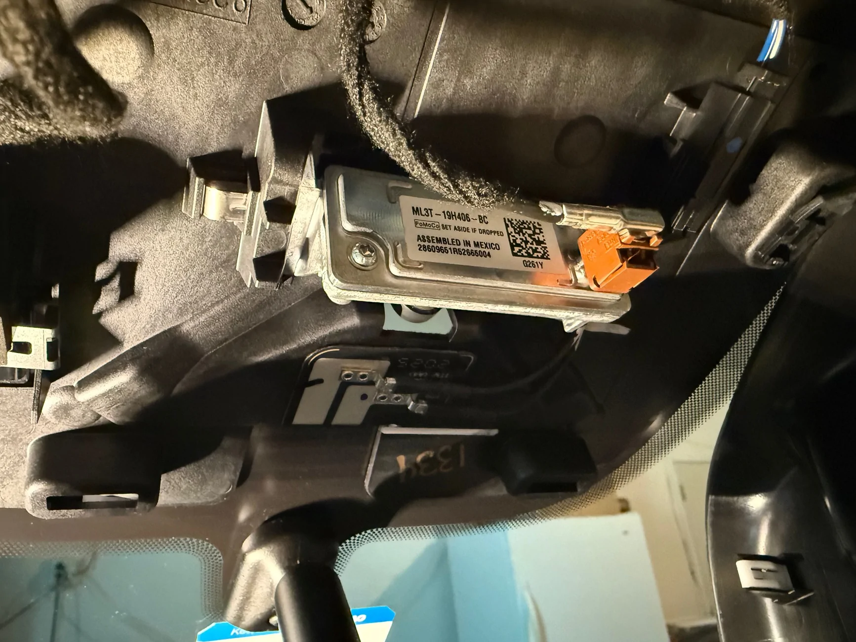

My windshield camera in my 2025 looks like this diagram you posted and not like any other I’ve seen pictured. It is very small.
