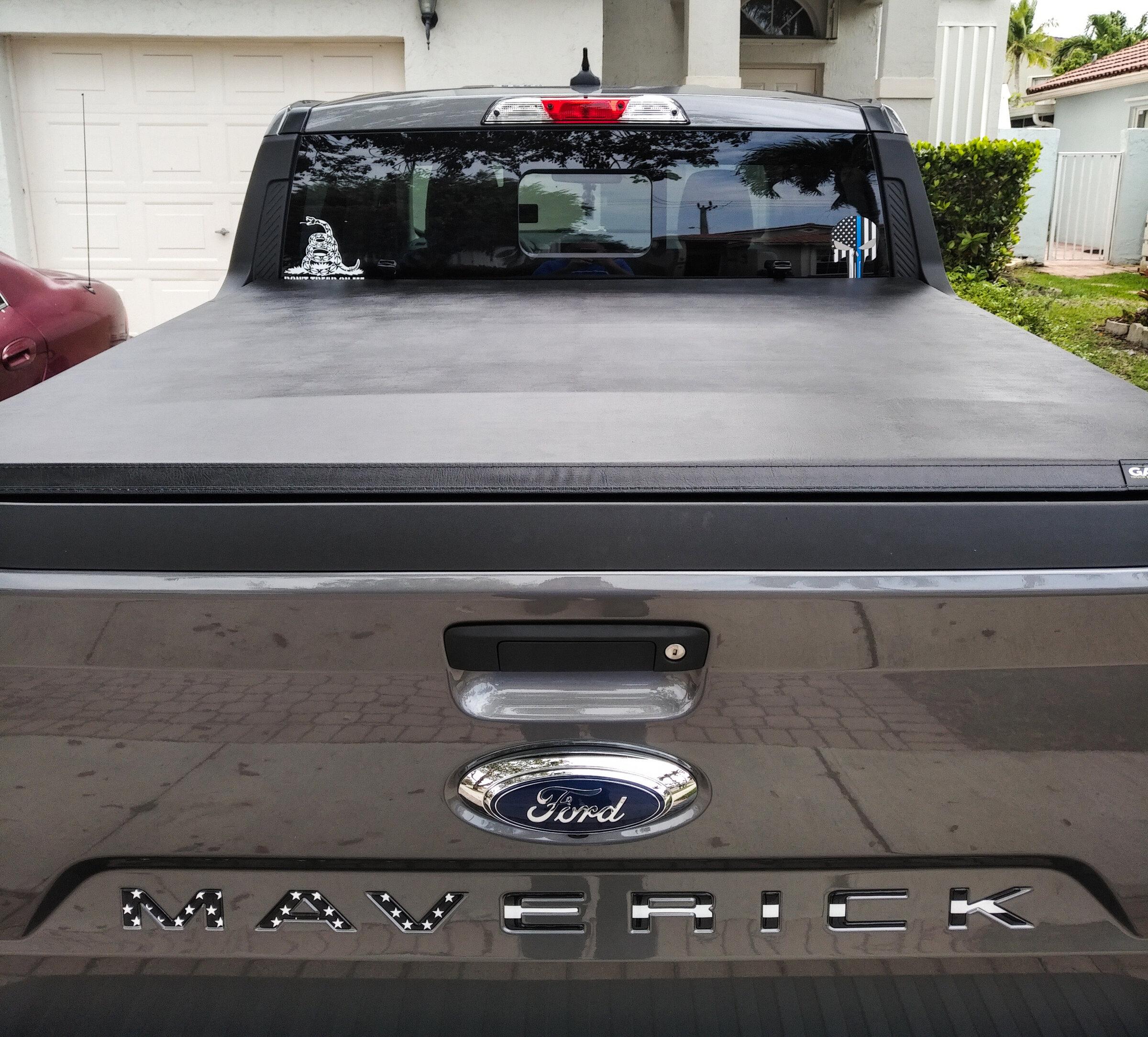

Here's your answers for the Gater SFX Tri Fold Bed Cover. BUY IT! This is the best cover for the lowest price. I paid $237.15 total with tax was $254.27. Easy install on Maverick, spring loaded rear clamps for quick opening, and closing, front clamps have knobs on threaded rods for complete removal if required. One person operation. Phone # 844 472 3062 You may even get a better price by asking.

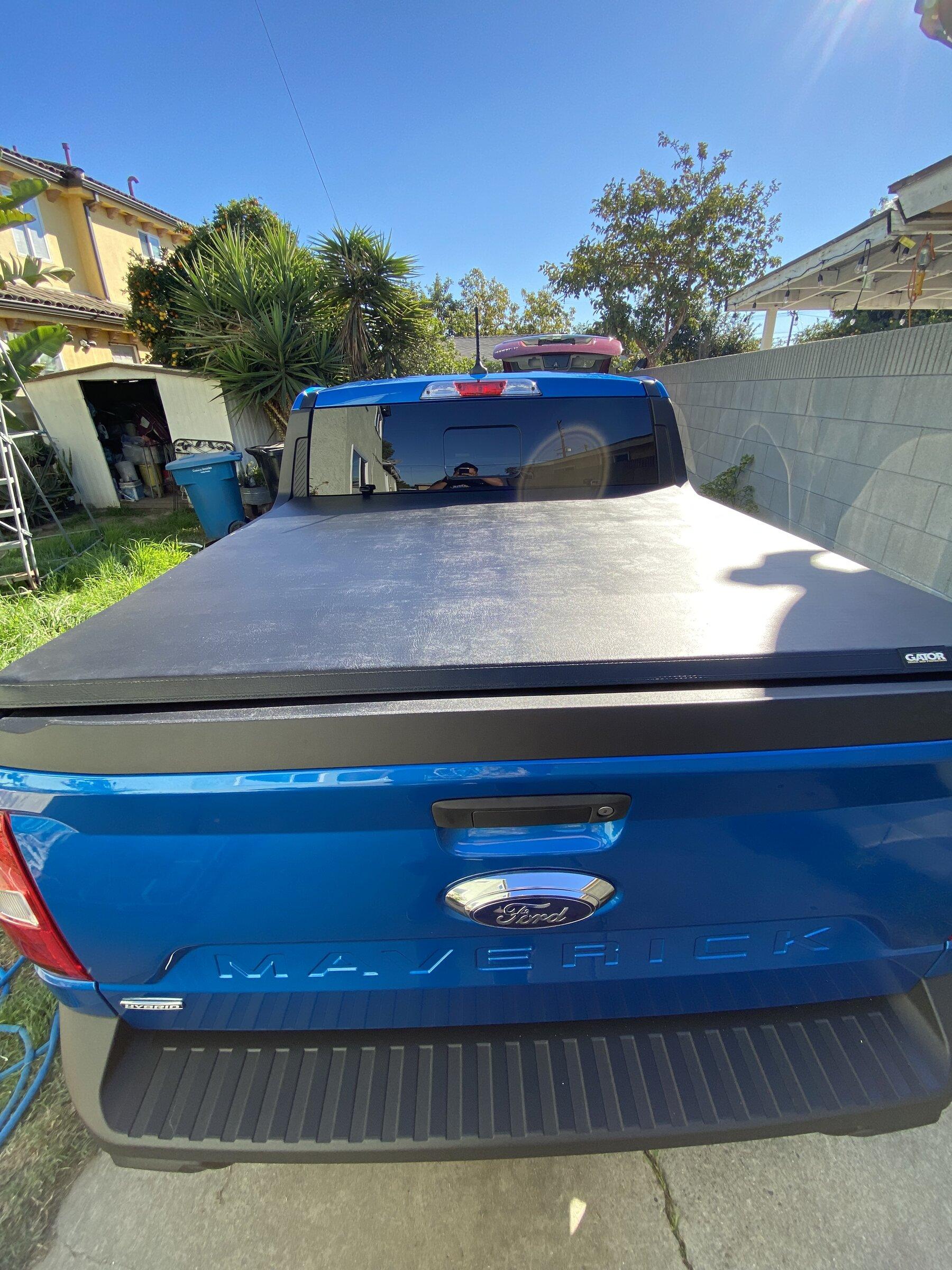

You’re going to love it QUOTE="19mustang65, post: 262498, member: 5176"]
Ordered mine today. Looking forward to getting it on there.

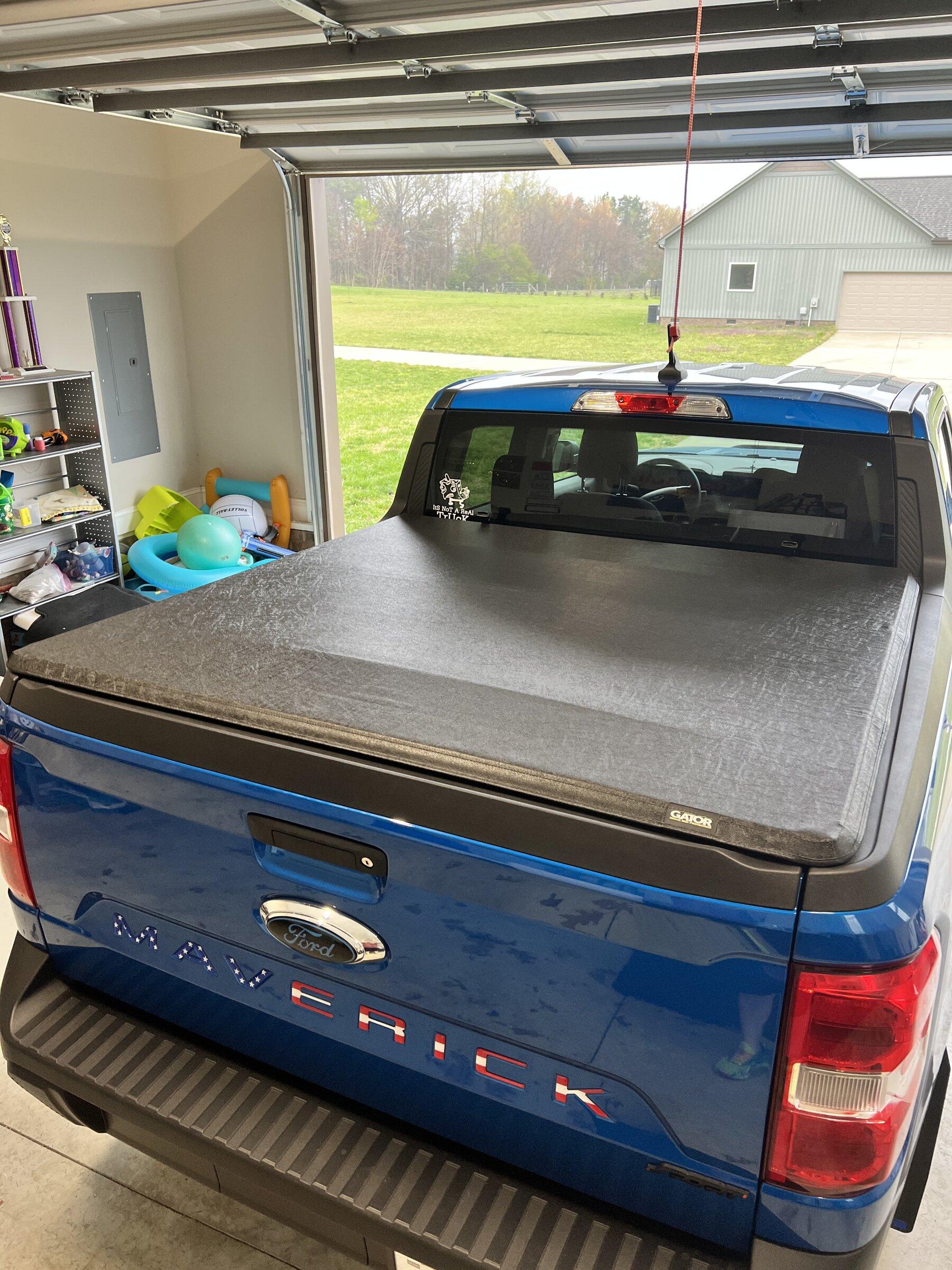

Ford Maverick Gator SFX Tri-fold Maverick Tonneau
Got mine today.
Gadsden sticker is a little low, but oh well, as long as you can see the snek it's all good. If you know you know, haha.

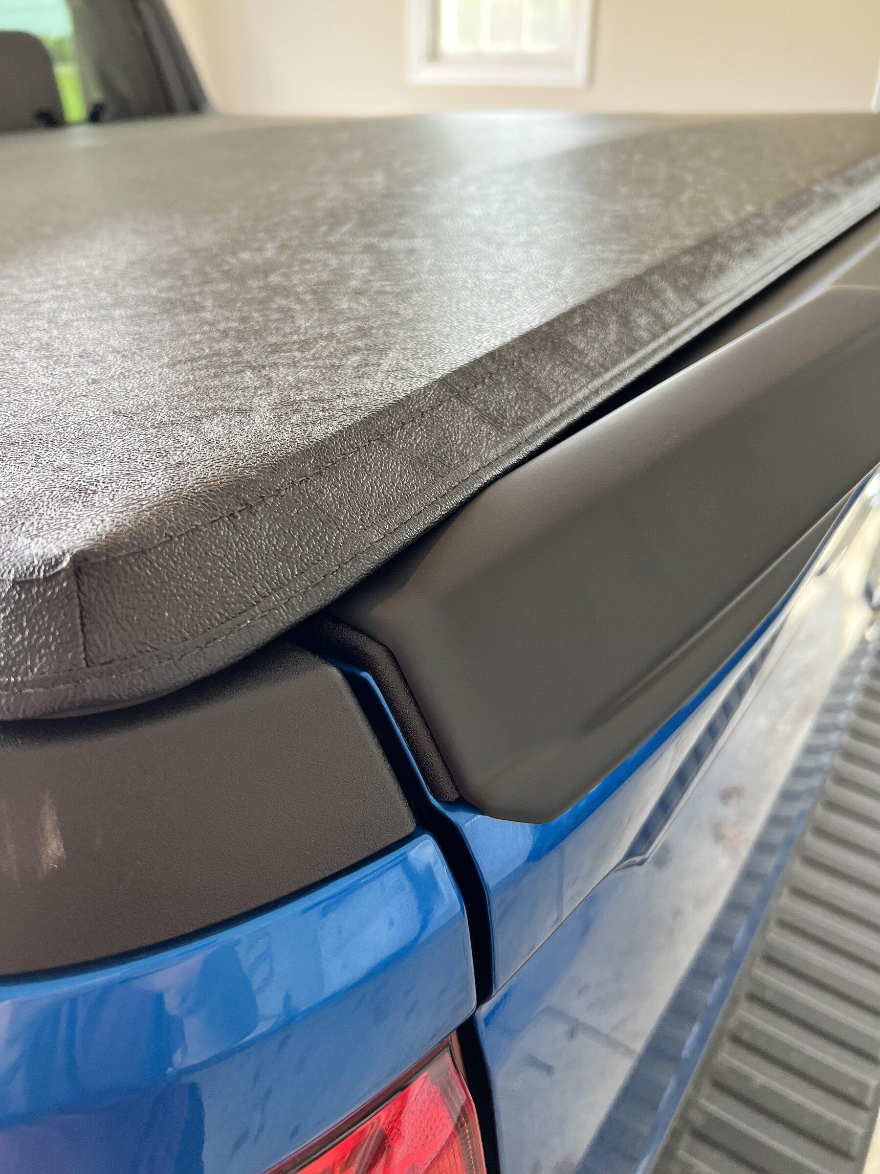

Great top…even fits with the tailgate spoiler
Looking good! Mine shows arriving tomorrow. Did you guys just drop it on and install it or did you need to remove some plastic pieces from the truck?
