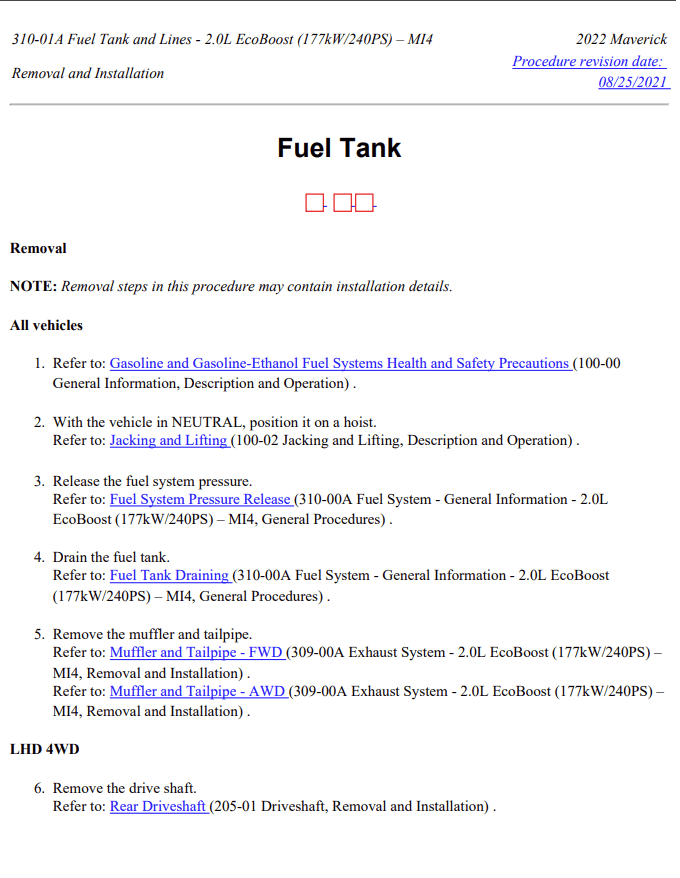

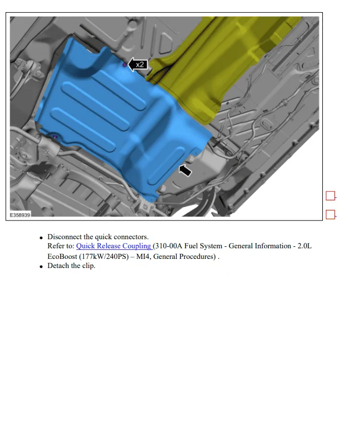

Really don't have access from the top. I'll be using a product from Tech-Bond Solutions to repair it if I decide to do it myself. Hole is only 3/16 so I see no reason to replace the whole tank like a couple of shops have suggested. I was going to do it at my home like I have done so many times before but after driving it up on some ramps and getting under to have a look, there's just not enough room plus I'll also be installing a catback exhaust while I'm at it. Therefore if I decide to do it I'll be using my friends shop so I can lift it up.

You guys are some comedians🤣🤣🤣. I made a bone head move and drilled a hole in the top of the tank. I was reading that the bolts can be very hard to remove and even break because of the Loctite that's applied. I'm hoping they're not Torx bolts like someone mentioned.

All kidding aside.. I DO HOPE!! If removing the tank is the only option. Please, drain it as much as possible and have enough "Clearance" and "Help" in doing so.
Before, I drilled-out the forward holes for the bed "D-rings". I measured twice and marked the drill bit, so as not to make myself extra work. I did a theral inspection of the top of the tank. Not much space to access it. It maybe possible to "Drop the tank" a few inches and do the suggested patch job..
