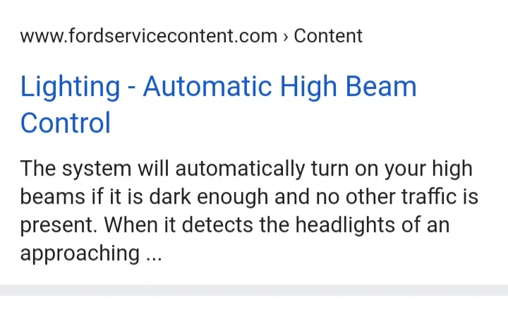

I have no idea. Perhaps if @bcooke would explain what he meant, it would make more sense.
After a little searching.
I don't believe they do.
Key phrase. It has to be 'Dark Enough'
I think people were flashing him at the intersection to tell him his headlights were on.
