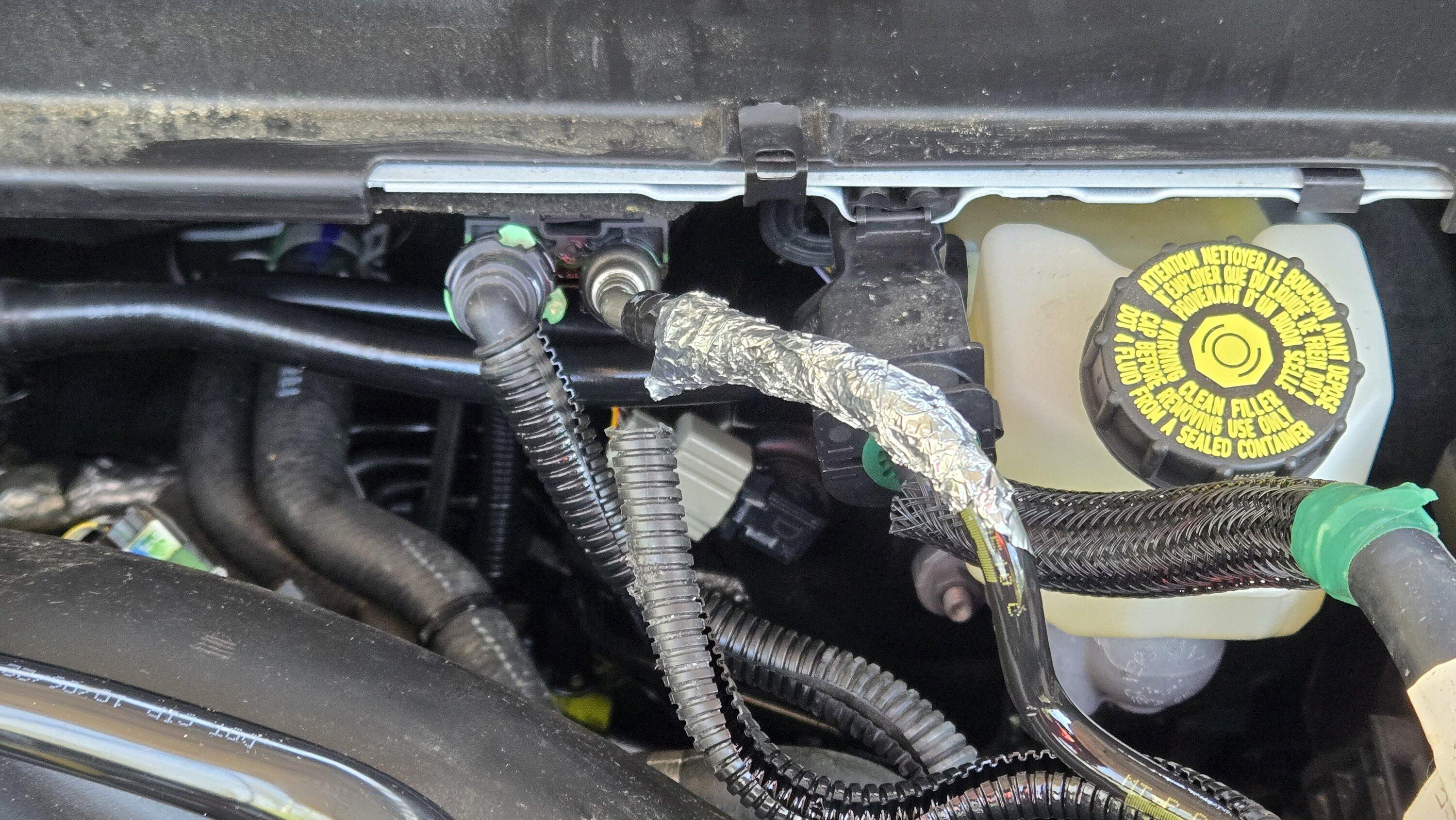

Okay so I went to go run some errands in my Maverick just now and smelled gasoline. I popped the hood and discovered a fuel line on top of the engine was spraying gasoline all over the engine compartment. I haven't driven it in about 6 weeks and have no idea what could have damaged that fuel line. I initially thought maybe it was a critter but it's a metal line so that doesn't seem like a viable suspect. I did have the oil changed shortly before the last time I drove it but I can't see how they could have damaged the fuel line and/or how I wouldn't have noticed it until now. Waiting now for the tow truck to take it to the dealer. Attached shows the line in question (I wrapped it in aluminum foil to prevent fuel spraying everywhere).
Any idea what could have caused this?

Photo didn't attach for some reason.

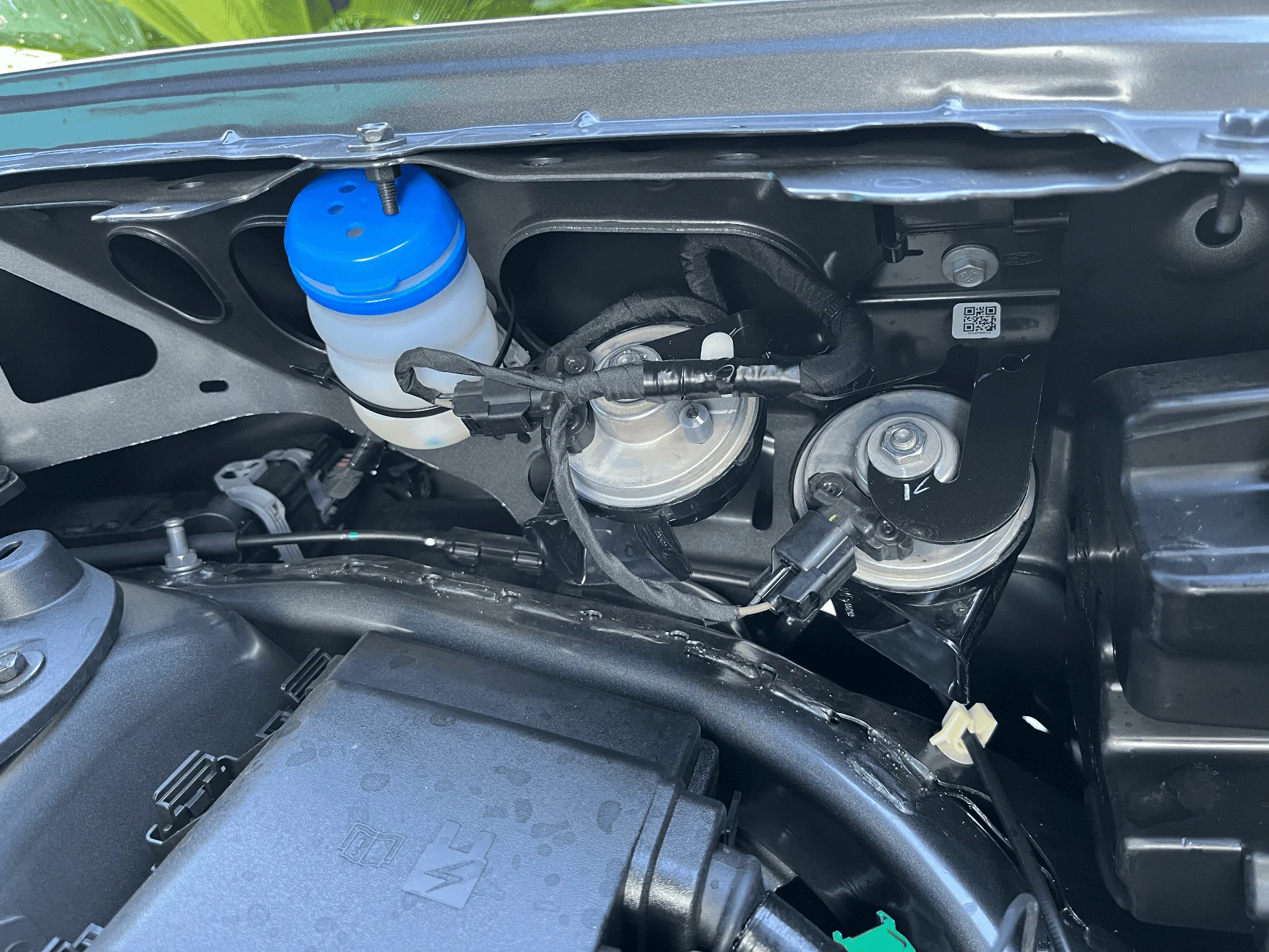

Was the black ribbed protective cover pulled away (like in the photo)? Was the black ribbed protective cover damaged at all?
The plastic black ribbed cover was torn at the location of the hole in the fuel line.
If it wasn't rubbing on something, then that seems very suspicious for both the ribbed cover and the actual line to be punctured. Either a critter gnawed on it....or......I don't have another alternative.

Unless my eyes are deceiving me, when blowing up the picture it almost looks like something was gnawing on the ribbed cover. Either that or a friction rub?

There's nothing to cause a friction rub. I thought the fuel lines were steel but thinking back, the fitting was metal but the line was black so its plastic? If so, it's definitely possible a critter bit through it.
