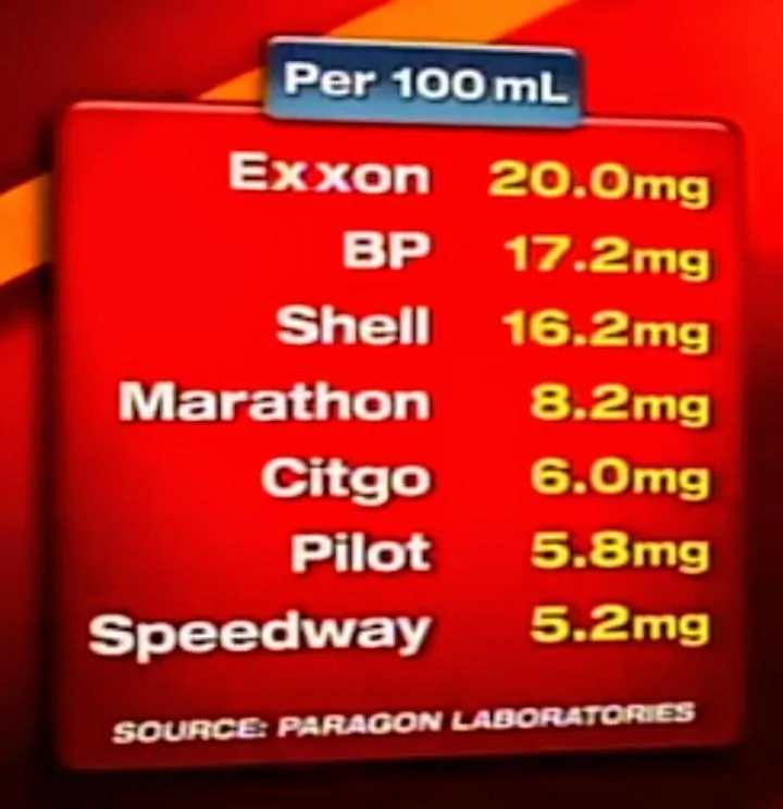

Direct Injection engines should use Top Tier gasoline and as you see from the chart below not all Top Tier gas is the same. Many auto manufactures are using these engines because they deliver higher HP and are more efficient. So many people think a higher Octane is better but actually it can damage an engine that wasn't designed for higher octane. I am not an expert but I did study this subject because I have a GDI engine in one of the cars I own and read there are problems with these engines due to deposits forming on the valves and injectors.
The best way to mitigate these deposits is to spend a little more for Top Tier gas with high concentrations of detergents to keep things clean. Let's use an 18 gallon tank for example and a 3 cent per gallon price difference. We are talking 54 cents more to fill the tank. You can't buy ANY additive anywhere to clean your valves and injectors for 54 cents per tank.

Regards DI engines, higher detergent concentration gasoline may help keep injectors cleaner but don't do squat for keeping backsides of intake valves clean (the intakes never see the gas mix in DI's).
My understanding is that the 2.0EB is not dual PFI/DI like some other Ford EB engines are, it's DI only.

Problem is that the 'cleaner'(assuming that is the above image is indicating) comes nowhere near the manifold side of the intake valves. That side is where all(ok, not all) the GDI engines have deposits forming.
How does it clean anything when it is injected directly into the combustion chamber and never even passes by the intakes?
