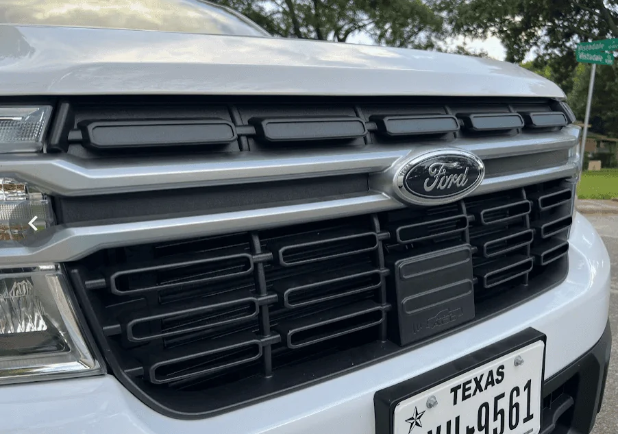

Starting up front: The Lariat grille has what I'm gonna call "pill-shaped" openings in it. My design idea is to install extra DRLs in the upper portion of the grille to mimic the F-150 Lighting a little bit. (BTW, I saw one up close and in person this week. It looked really sharp)
What I want to do.
  • Extend the Lariat DRLs across the top of the grill and make it look something like this: Lights need to be bright, smooth, no hot spots, and need to match the color of the exsting DRls as slose as possible.
  • Ford Maverick Front Grill Lighting Concept 1656107229895
I have two challenges that I'm working through right now.

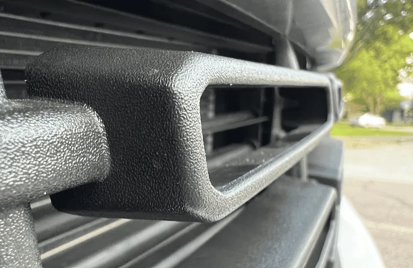

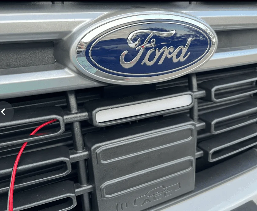

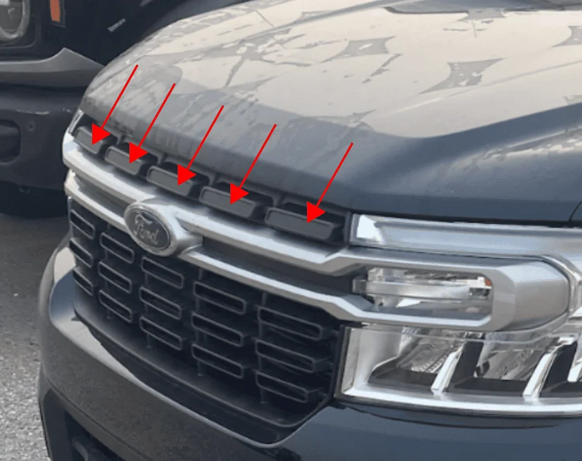

Challenge #1- Those pill shapes on the top of the grille are not open, like the ones below. I'll have to route them out to achieve the look that I want.
Ford Maverick Front Grill Lighting Concept 1656107452209
Challenge #2 I haven't found a light that will look right yet. Before I start carving up my grille, I think I need to lock down a light that I think is going to work first.
Approach:

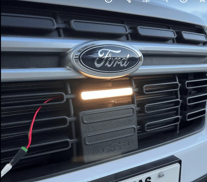

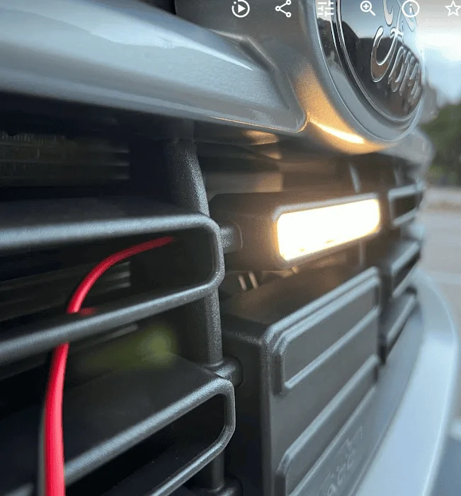

I'm going to use the bottom grille openings as a template. If I can get it to look right, and get the light color right, I'll be in a good spot.

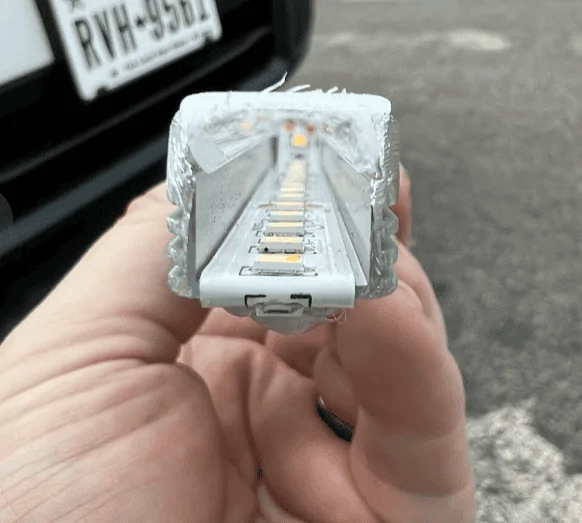

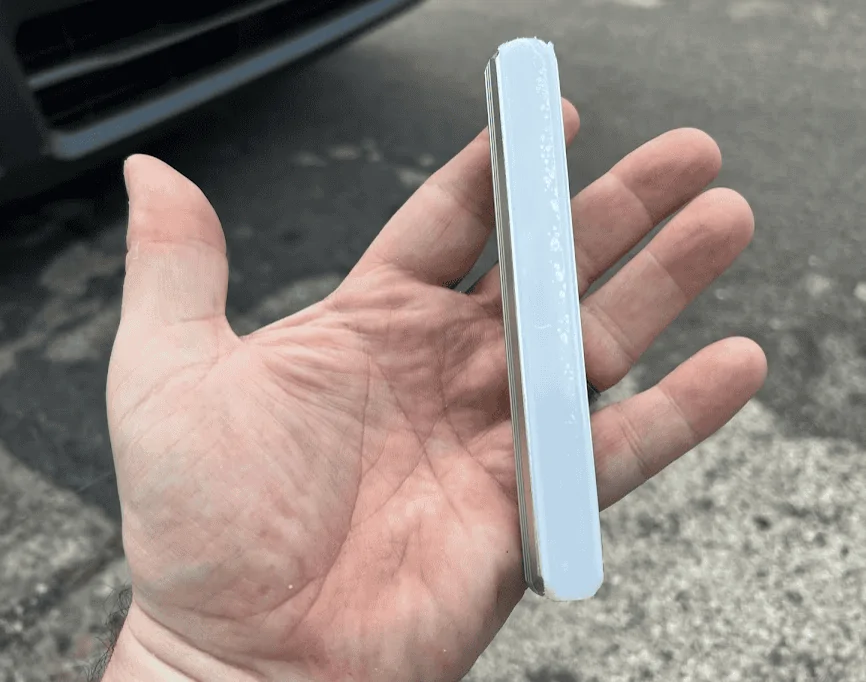

I have sourced an LED housing and cover that will actually fit 'inside' the pills, when installed from the back. Also, these openings already have a lip on them that would allow me to cover up the edges.
I had some extra LED strips laying around, so I'm using what i have at the moment for proof-of-concept. If I like the overall look, I"ll order the right color light.
Ford Maverick Front Grill Lighting Concept 1656110059223
Ford Maverick Front Grill Lighting Concept 1656110110117
Ford Maverick Front Grill Lighting Concept 1656110145010
Ford Maverick Front Grill Lighting Concept 1656110175057
Ford Maverick Front Grill Lighting Concept 1656110204580
Ford Maverick Front Grill Lighting Concept 1656110239645
Ford Maverick Front Grill Lighting Concept 1656110273337
