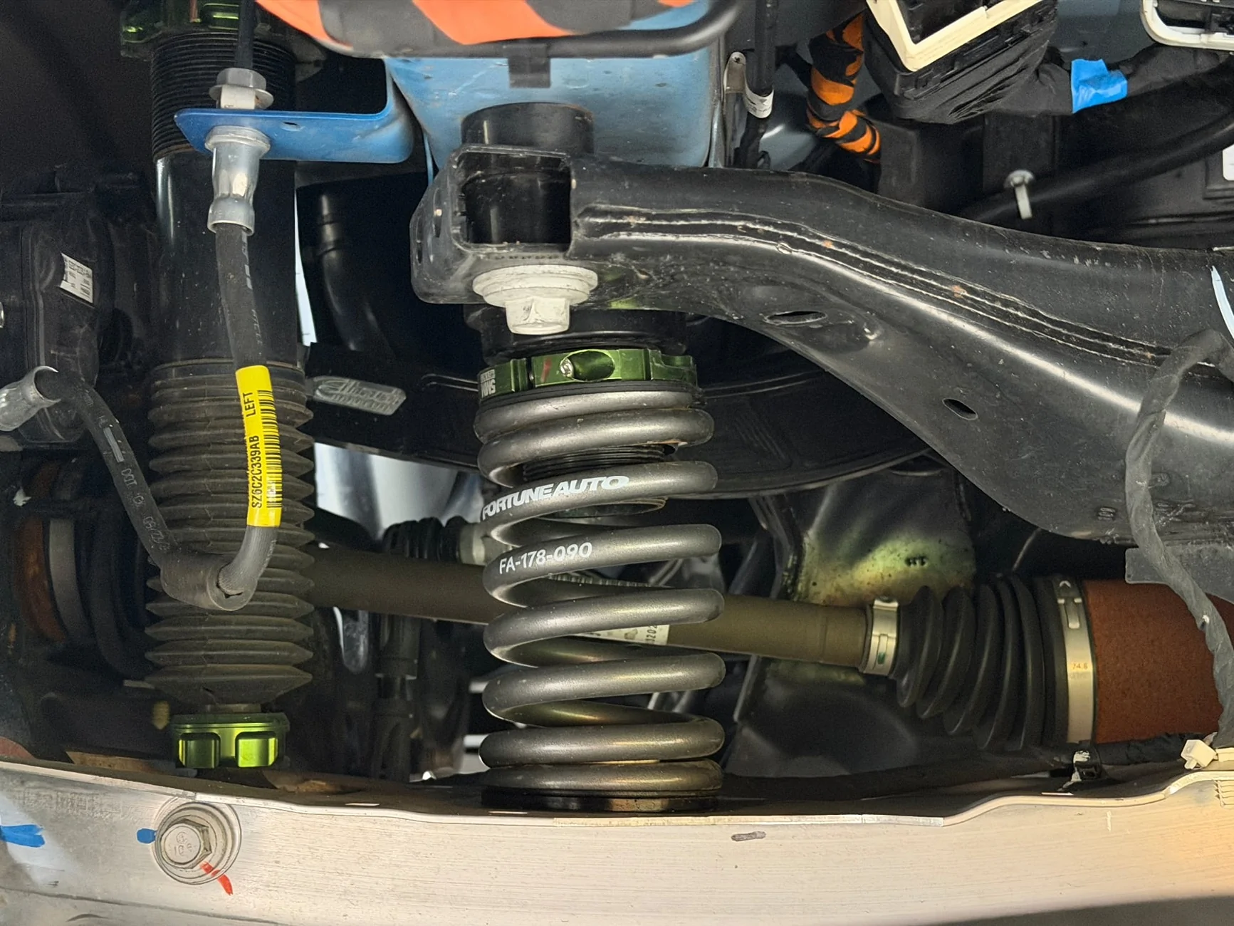

After taking delivery of my 2025 Lobo 702A, I dropped it off to the R&D department of Fortune Auto. Over the course of a week, they took measurements and scans, noting any differences between the 22-24 platform, of which there were a few. They developed a prototype coilover kit using their 500 series hardware.
I'll be providing feedback and working with them to get the kit dialed in for future production.
Initial impressions are excellent, with reduced body roll while maintaining a firm and sporty, but not punishing ride. Of 24 dampening settings, it's currently set to 6 clicks from full soft in front and 8 from full soft in the rear. It's running 4k springs up front and 9k in the rear. Ride height has been lowered to the point of an even gap between the fender and tire front and back, and has plenty of remaining adjustment up or down.
The only con so far is increased NVH from the front strut towers and camber plates, as is sometimes the case with aftermarket suspension. I'm working with them to try various solutions to help bring the NVH back down to OEM levels.

Before:
After:

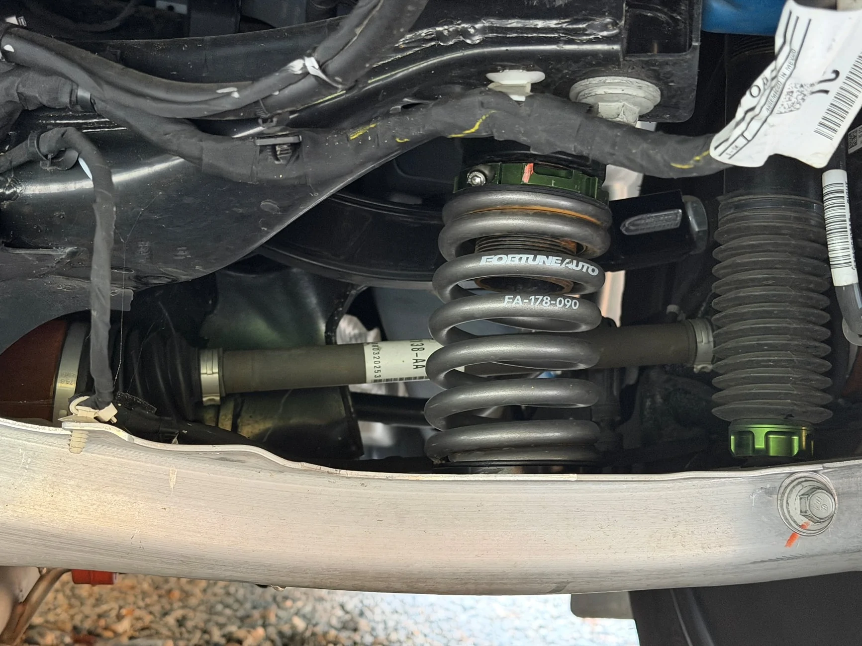

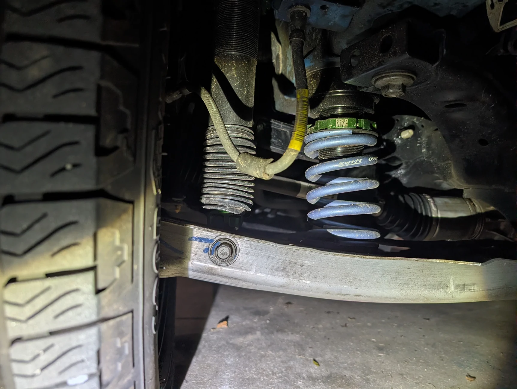

Question for OP…. I finally got around to installing my fortune autos on the lobo yesterday. My rears look about like yours do in your first picture. Were you able to go any lower in the rear than what you had it there? I was really hoping to go about 1/2” lower but they are already as low as they can go. Also, on the rears, I hope I installed the springs correctly. The adjustment nuts and larger perch go on TOP of the springs, correct?

You should be able to go lower than that. I went 3" lower in the rear and they have a good bit more to go. What rates and what springs did you go with? I am running swift springs 5K front, 9K rear. I would be this would go another 1-1.5" lower.
Yeah I have something going on. I’m running the same swift springs and rates. Also, the same as the rest of your setup. I’m pretty sure.i commented on your Reddit post a little while back.
I kept the ride height where it was to avoid rubbing at full compression of the struts - the wheel wells of these trucks don't give the most breathing room, and I couldn't go much lower due to my driveway. There's definitely room to physically go lower by at least a little bit. I'm not sure how my original prototype kit with the Fortune springs differs from the current production set, especially with the Swift spring upgrade, but it should be very similar.
